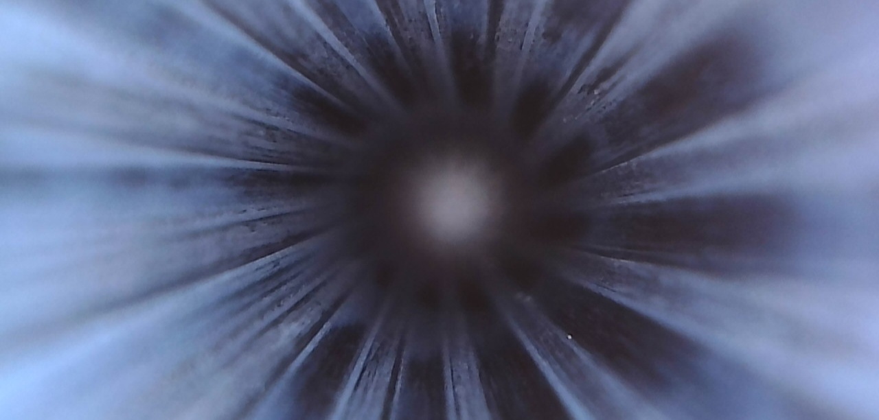

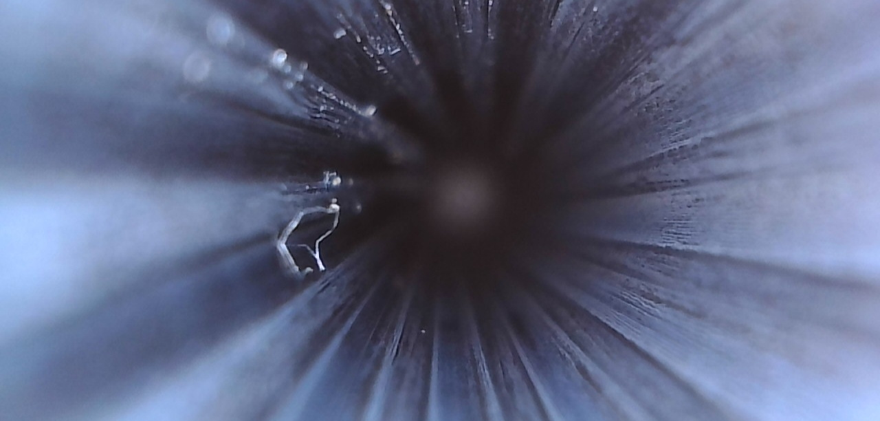

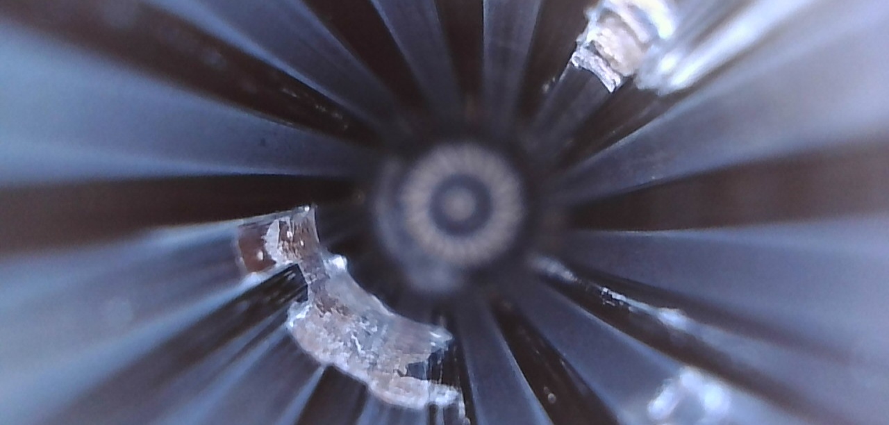

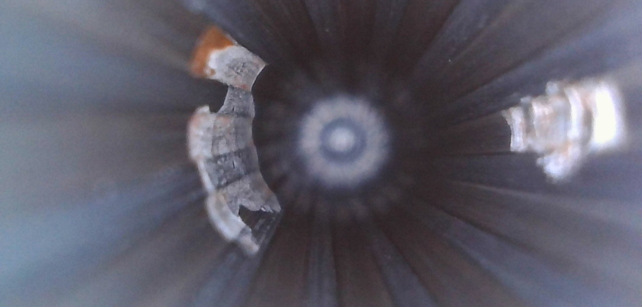

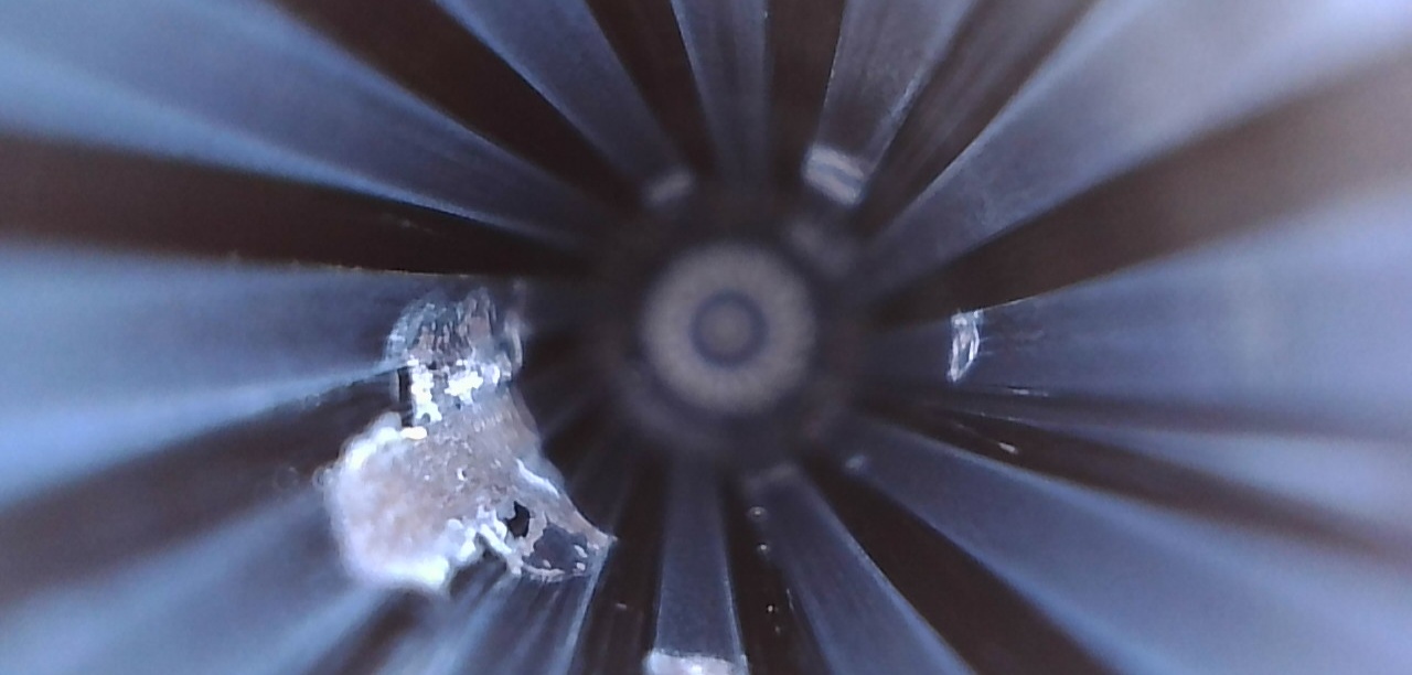

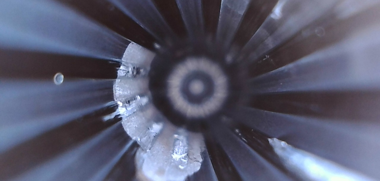

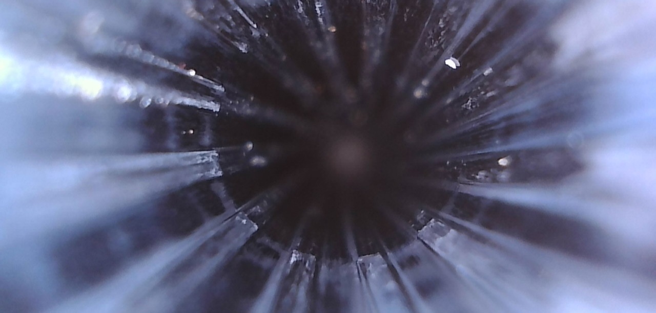

I bought a Teslong NGT100 boroscope months ago and just got around to using it today. The head is about 5mm in diameter and easily fits into a 22 caliber or larger barrel. I have some mirror heads for it but I haven't used them yet. I often get frustrated with things like this and it happened today. The app demanded the model and it was not in any of the packaging. But eventually I got on line and figured it out. I looked at the barrels of my most accurate PCPs both of which have given me a 200 on the 30 yard challenge. I looked at my P35-22 and my Caiman X, also in 22 caliber. The first several pictures are the P35, the final few are the Caiman. The barrel on the Caiman is hammer forged, I think, and there seemed to be tiny copper flakes in the barrel. The P35 barrel seemed to have thread like lead deposits in some areas with some rectangular chunks near the crown. The Caiman had some much larger lead deposits about as deep as the rifling back near the throat. I gave both barrels at least 50 strokes with JB's bore paste on a patch. That cleaned up the P35 better than the Caiman. Too windy to see if I made a difference, I'm not expecting I did.

Scott, further scrubbing with JB's is on the agenda for this morning (as we get a big storm). If that doesn't get it I think I have some coarse material I can use. The barrel shoots well and I get a lot less lead out of it during a normal cleaning but it seems to have some rough spots.

I did a little research by Google after Scott's comment. I also looked for my old PB cleaning stuff. I couldn't find a brass brush so I ordered a few. I found some Kroil which I used to like for this. I saw several comments about steel wool or a similar product made of brass. I'm going to see how it goes with a brush first after soaking the barrel with Kroil. I need more slugs for the Caiman so I have a few more days to work on the cleaning before I get the projectiles to use in it.
Still waiting on some bronze brushes but I decided to look at my oldest P35. A 25 caliber. It may not have had more shots than the 22 but both have had more than the Caiman (mainly because I've had them longer). First I looked at it as it was. Had deposits. Then I cleaned it with Ballistol. Cleaned up completely.

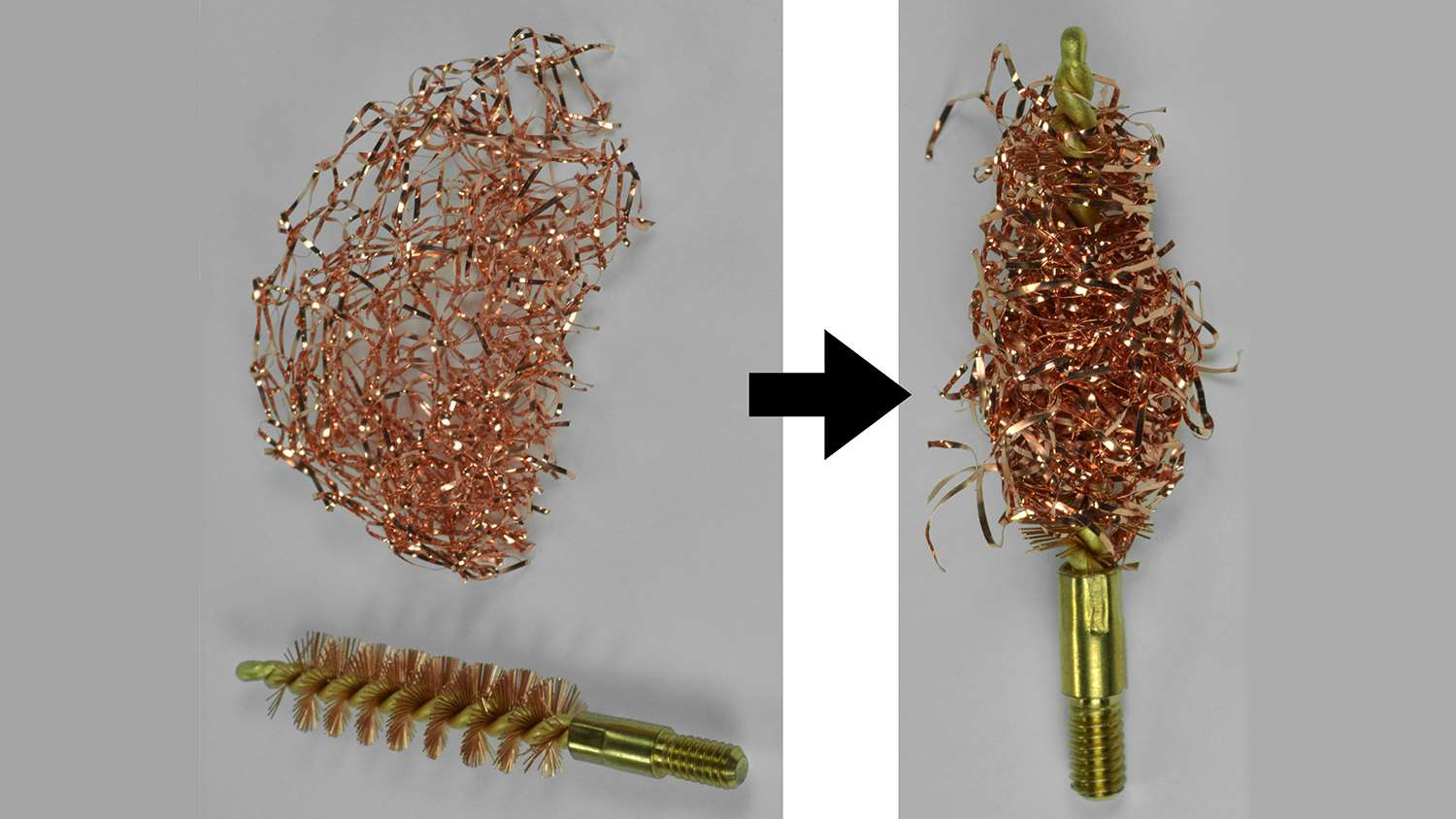

PB shooters have been using pure copper strands wrapped around a brush for fast removal of lead for a century or more. It is the fastest way bar none, and it won't harm real steel barrels. You get the copper strands from pot scrubbers that are pure copper, be careful, lots of pot scrubbers are actually steel that is coated in copper, bad juju. Make sure the package says pure copper, and since companies lie all the time, put a magnet on it to see. There is no faster way, it is amazing. I spent years shooting silhouette with hard cast lead, thousands of rounds a month in practice. I used this on high dollar revolvers without hesitation.
this is what it looks like:
