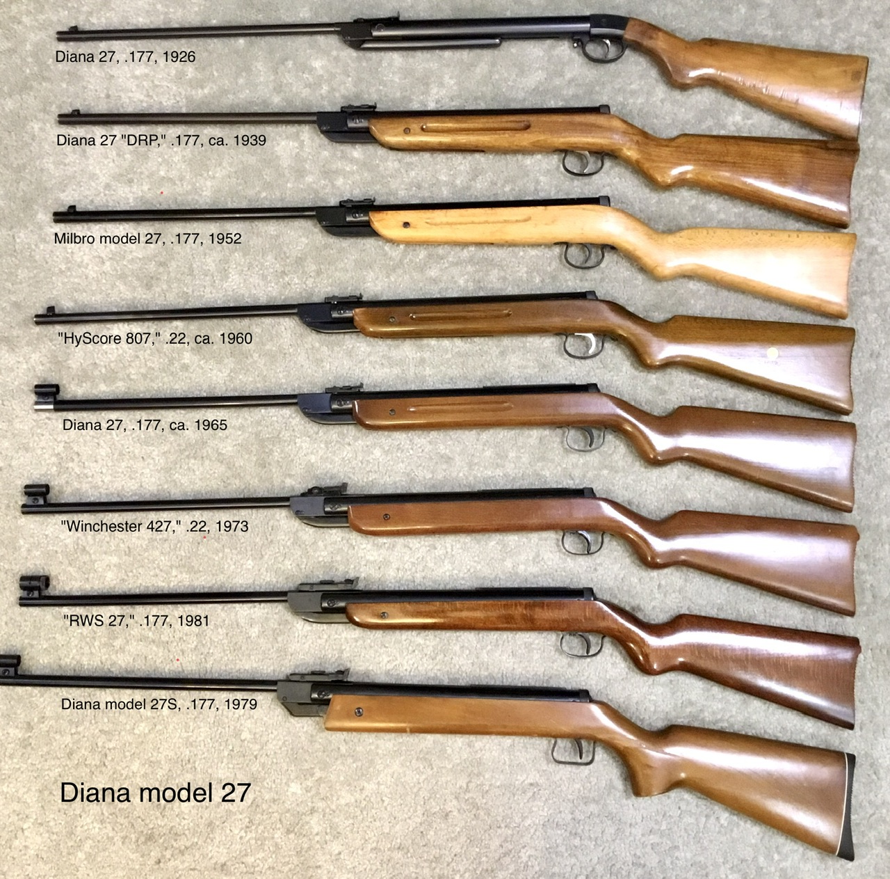

In the late 70s, I bought an airgun that I believe was a Diana. It was sold by a outdoor sporting mail order company that I cannot remember the name but it is out of business. Maybe started with a P. The airgun was rated at 690 fps in 177 although the mail order company mistakenly rated the 22 cal that. I believe it was a fairly common airgun in the states as our local sporting goods store had a 22 cal version. Thinking it was a Diana 27???? I don't think the airgun had the name Diana on it but not sure. Any ideas and pictures.

Well, here's a selection of Diana 27's for you to compare against your memory. :D
Model 27's were made in many variations, for almost 80 years. Dianas sold in the US In the 1970's could also have been branded as Hy-Score, Winchester, Geco, or Gecado. Quite a few of those were in .22.
Model 27's were made in many variations, for almost 80 years. In the 70's, a Diana sold in the US could also have been branded as a Hy-Score, Winchester, Geco, or Gecado.

Thank you. Definitely looks like it was Winchester 427. The appearance and model year looks right. Now the search begins.

JDR...Winchester imported Diana airguns from around 1969 to '75. I believe that all "Winchester 427's" were in .22 cal. Early ones will have a plastic trigger blade, later ones a stronger stamped steel one. All have a simple spot-welded wedge rail for a peep sight or light scope.
If you are open to different markings, the post-war model 27 had quite a few changes over the years, with advantages and disadvantages. PM me and I'll be happy to bore you with those. :D
