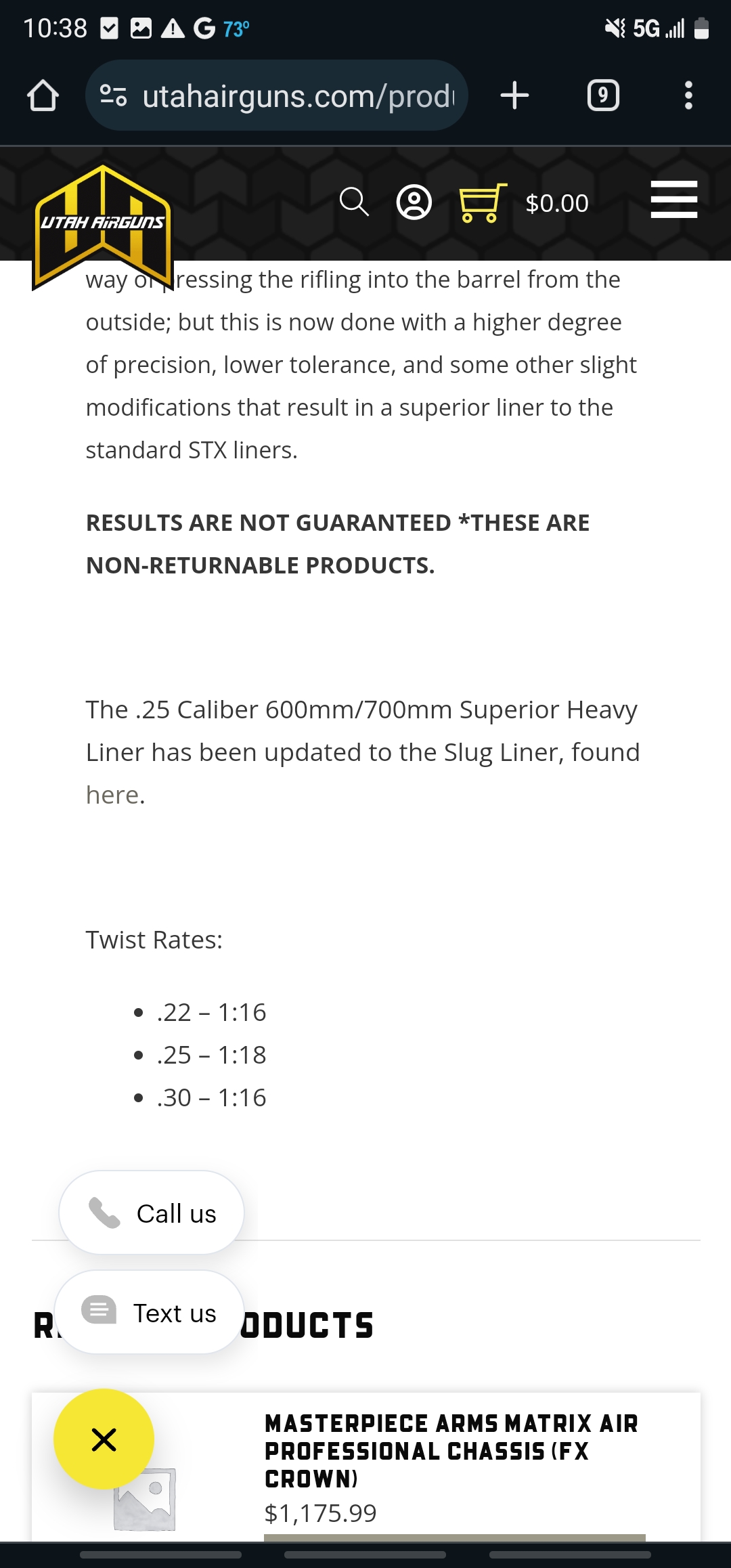

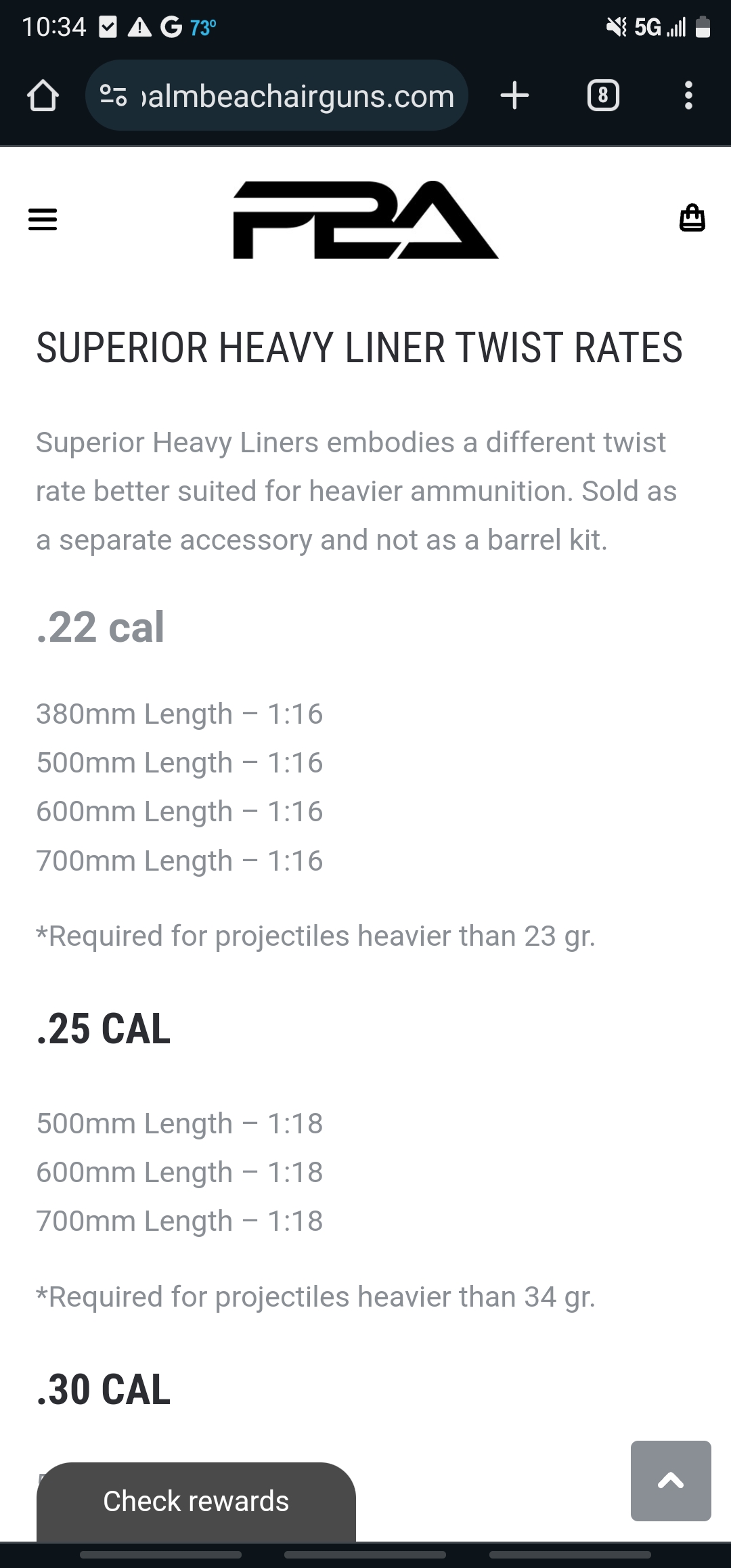

Where did you a 1:16 for the .25?

If it's not grouping with ANY slugs, then it's a gun issue. You may want to look into the faster twist barrel. Most peoplewho got the impact .25 did not have any luck shooting skugs out if it.
Mine is shooting fx hybrids very good but I ordered the tensioned barrel system and I dont know if it came with the 1:18 or 1:16. I asked utah airguns but he said he wouldnt know which it came with. Evidently after a certain date the tensioned system would come with the 1:16 for the .25. I dont want to pull it apart to verify since I got it shooting good. I bought mine in the last 3 months so theres a chance its the 1:16.
