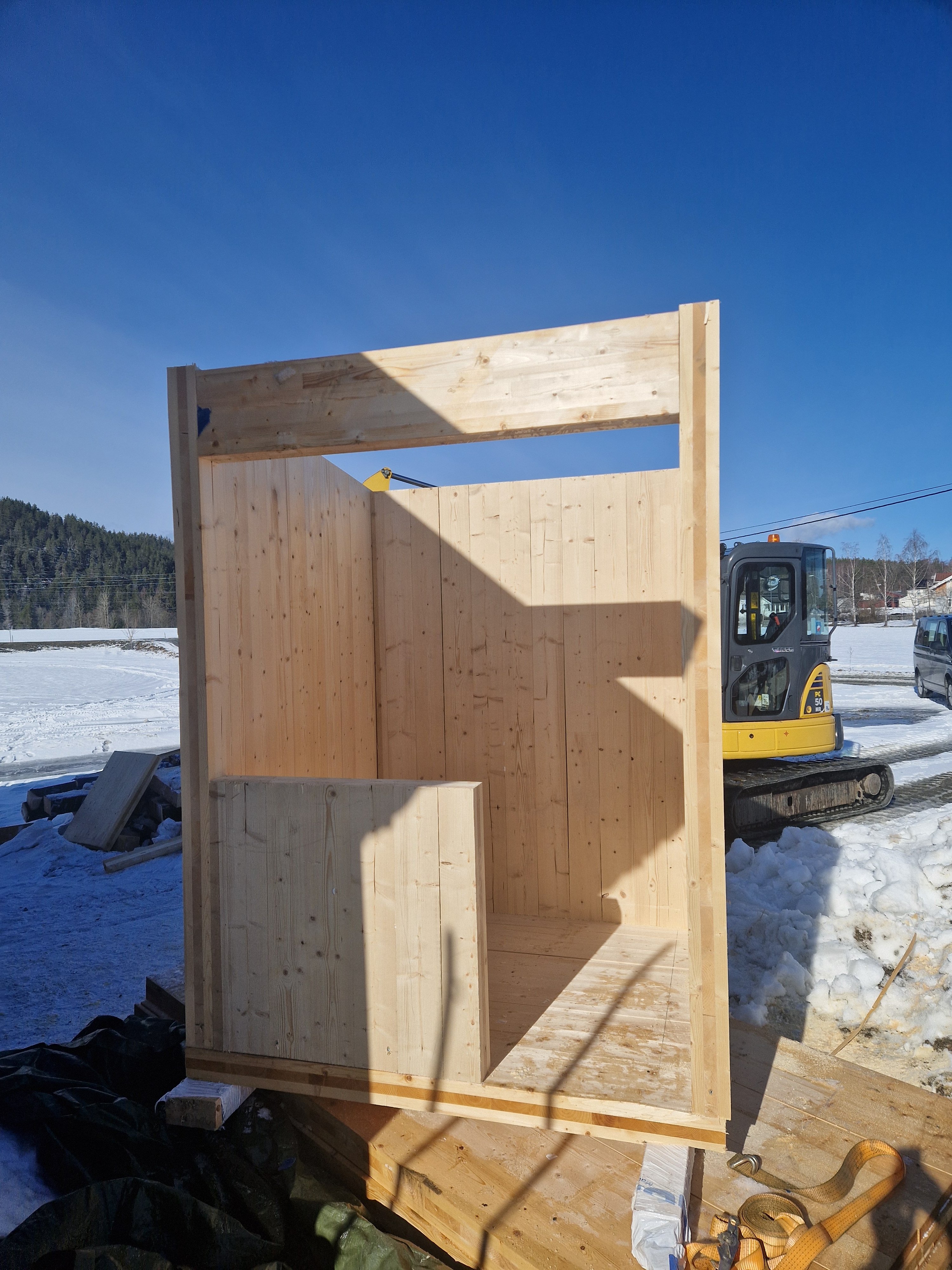

And if the minus degrees work with me tomorrow morning i May be able to move my shooting shed out to my new range also :) its around 1500kg so need the frost to move it xD
