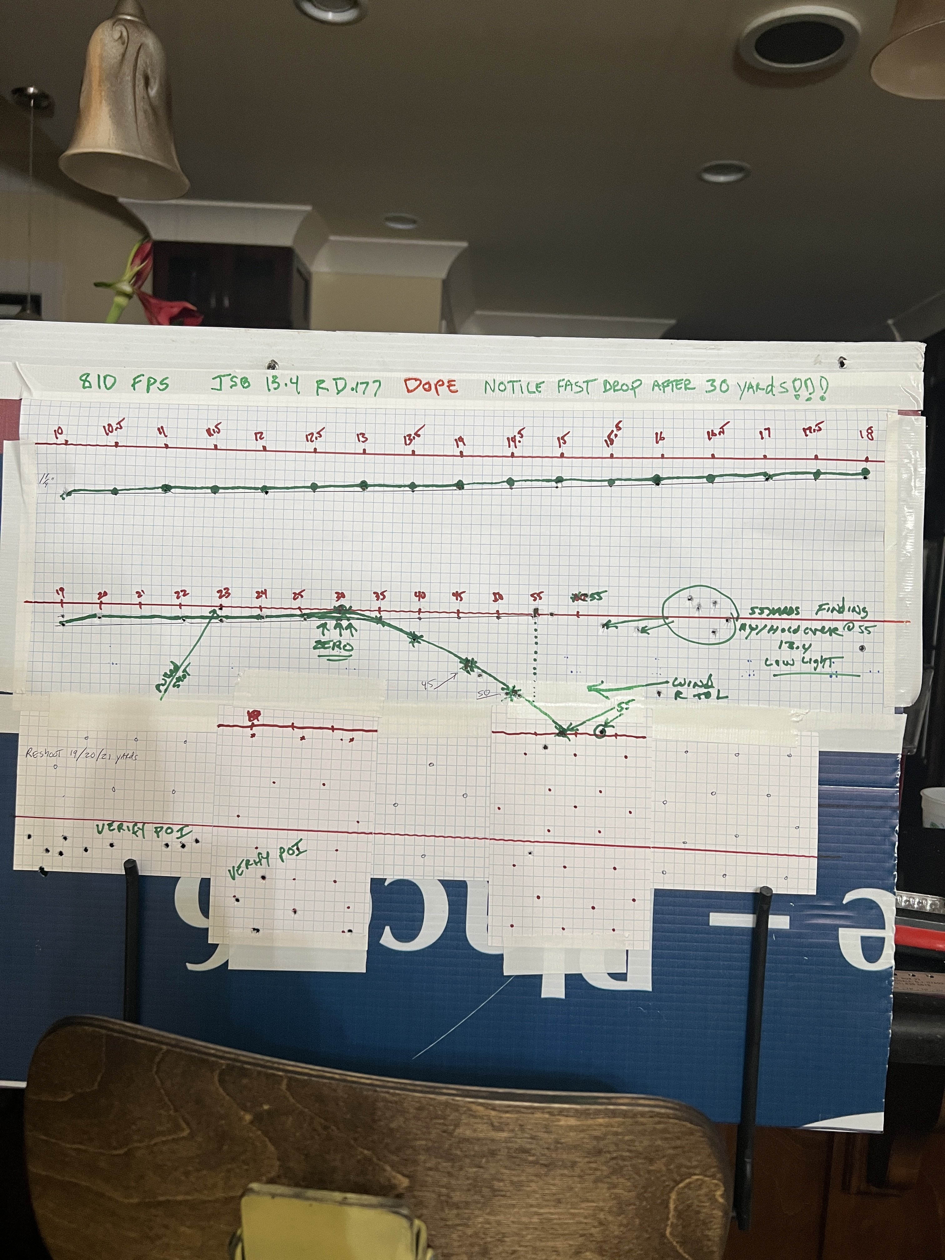

Next step: using some 8”x11” graph paper, tape them together on some coroplast; then draw a straight line all the way across the top and then mark your line with a X every inch or so.
Label your X marks by the 1/2 yard from 10-55 or however far away you plan on shooting.
i recommend the next step to be done from a bench to minimize variables.
place your target at 10 yards and begin shooting With your point of aim on the line at the X for each distance. Your pellets point of impact maybe or will be lower than your point of aim, and that’s part of the important data.
Below picture shows my results shooting .177 jsb 13.4 RD’s from a Redwolf at 812 fps.
when finished you will have created a real life ballistic chart for your gun and pellet choice. Useful for determining holdovers and or clicking the turret!

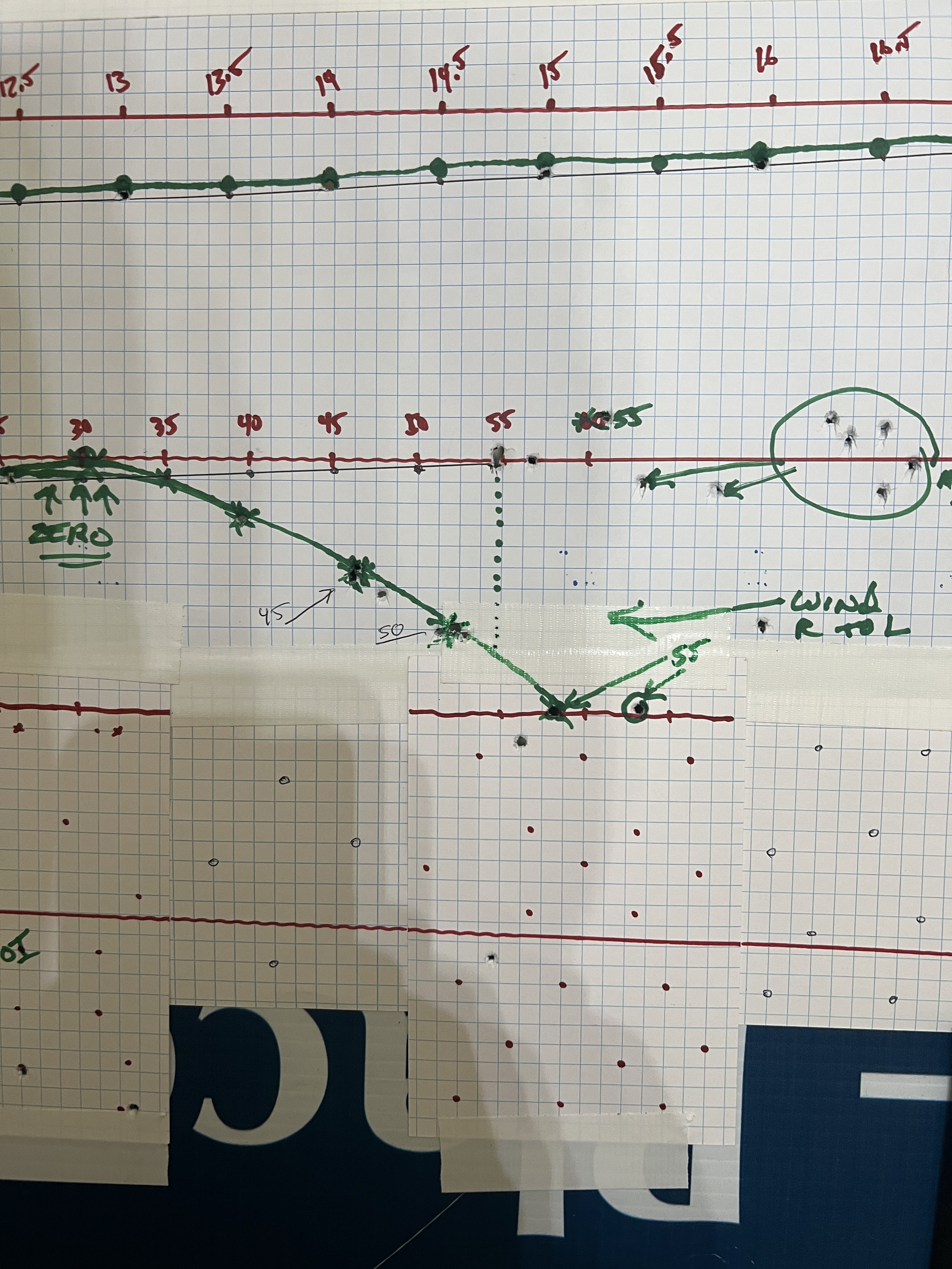

Of great interest to me was how quickly the pellet began dropping after my chosen zero of 30 yards. 3" drop by the time we reached 55 yards.
wind was actually blowing left to right in accordance with the pellet drifting

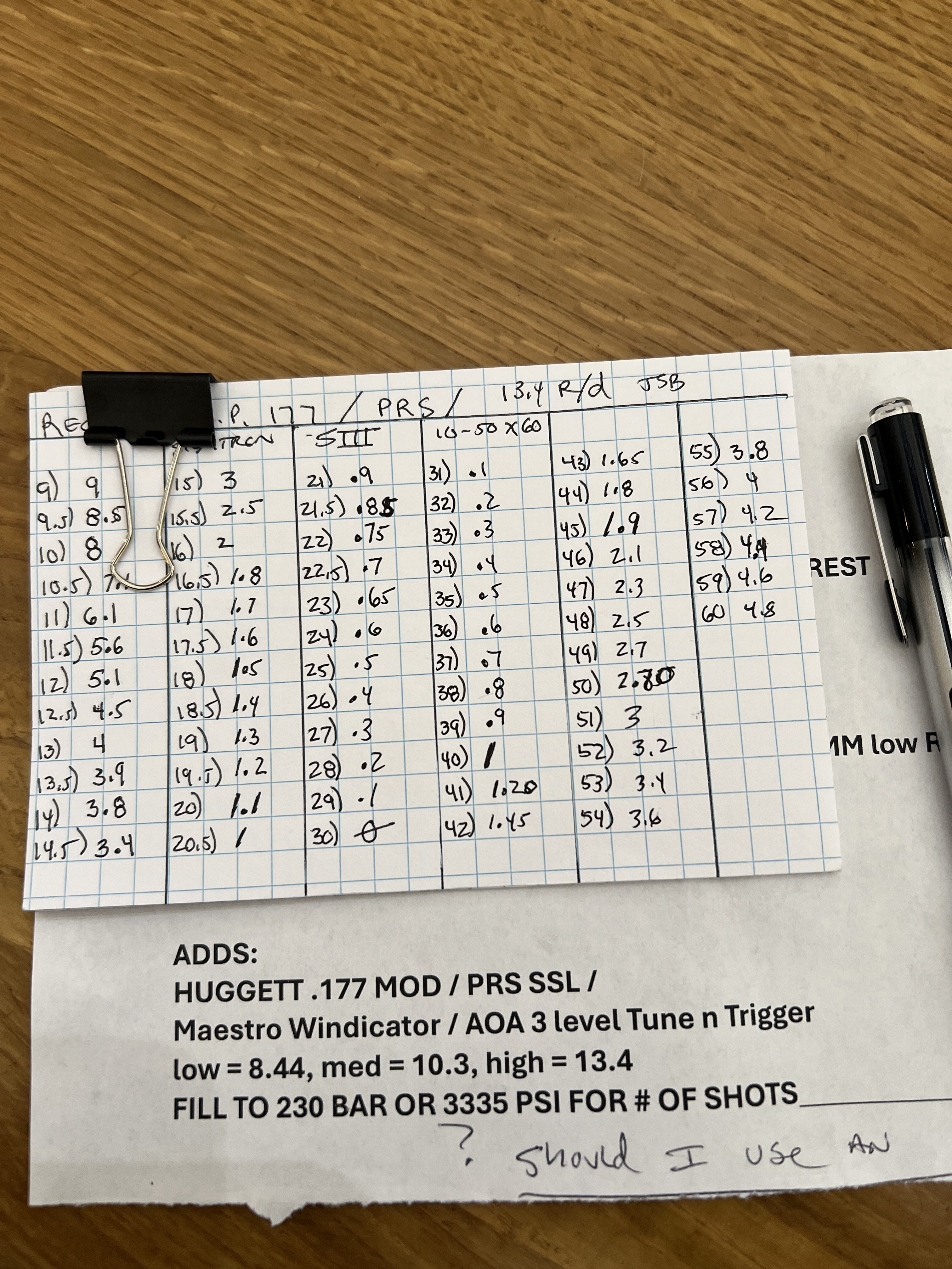

If you want you can then measure the difference between your point of aim and point of impact with a ruler and then you can aim at a target by guessing the distance and using a holdover of inches above where you want to hit.
i would have to aim 3” above my target at 55 yards to score the proverbial bullseye

If we study my chart some we can see my initial trajectory apex is probably right around 23 yards; but extends to approximately 32 yards. I could rezero the scope to the middle of the apex say 26/27 yards and reshoot, to minimize holdovers but in my case it’s not that critical since I have hard holdover values I have validated.

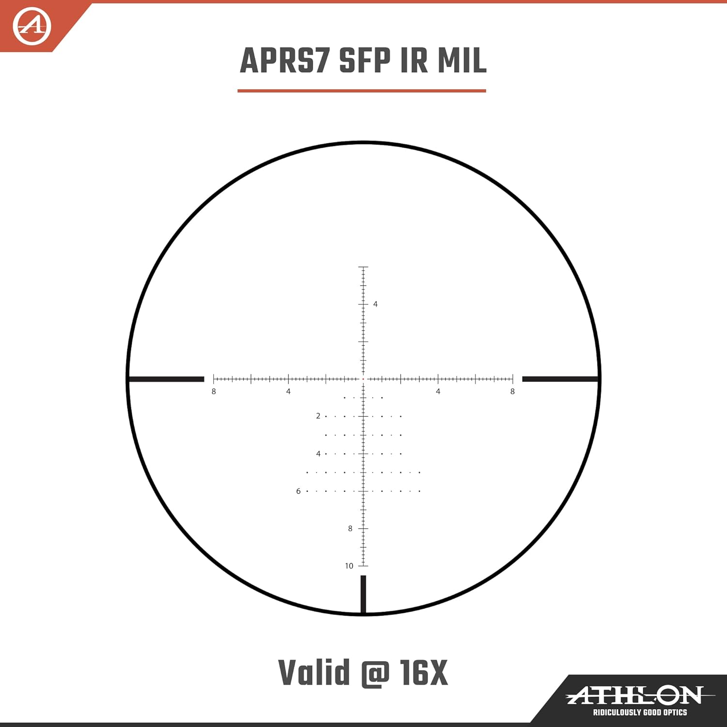

Largely depends on the details provided by the reticle - in this case - a Sightron SIII 10-50x60 FT, it lacks some detail from zero to 1 which does make it more difficult to hold point. I may switch to an Athlon Helos Gen2 6-24x56 so this affects 21-39 Yards

picture of the two reticle options Sightron v Athlon side by side

my scope is pretty much slammed down but I also use a air superiority 20 MOA Redwolf specific pic rail. So what you stated makes sense because of the 20 MOA rail.

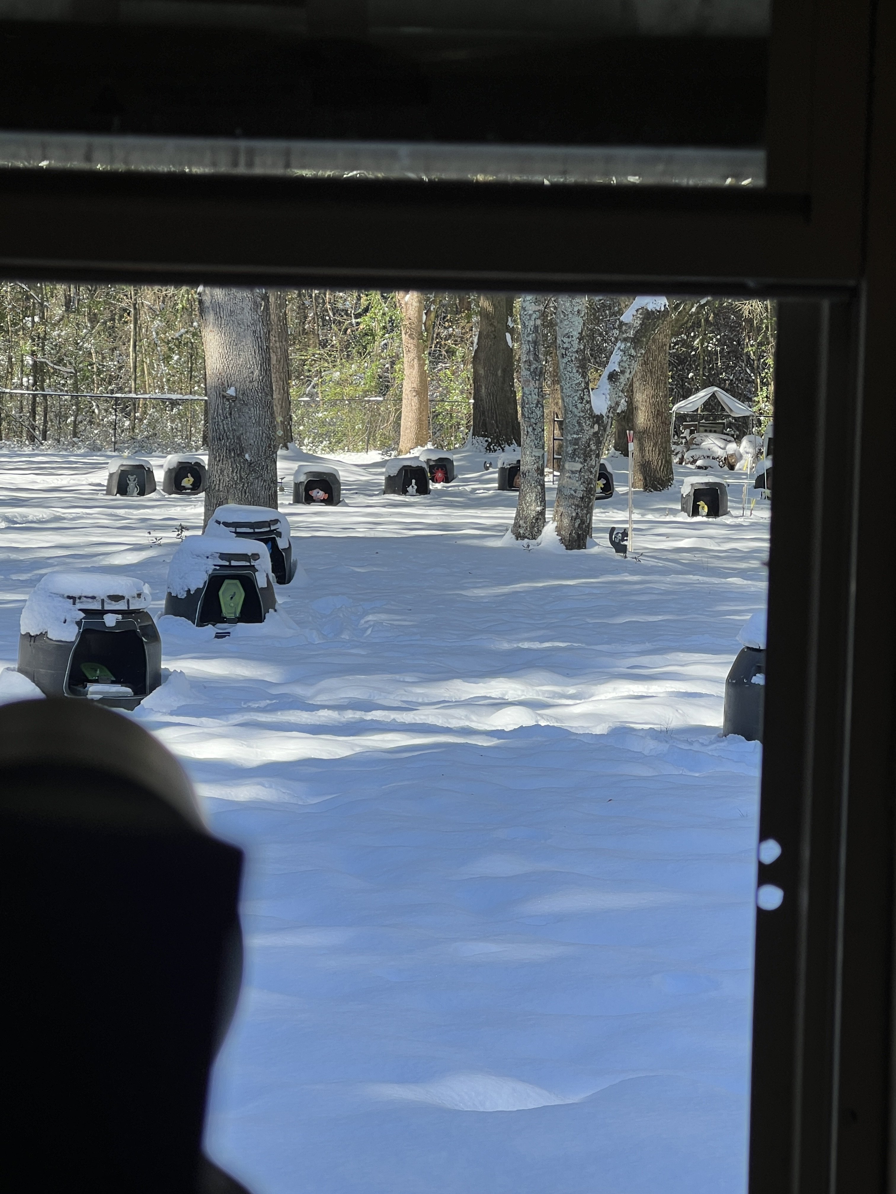

What a nice backyard range.
