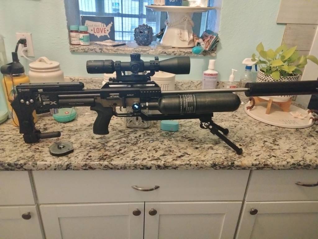

Finished my modified FX Impact MKII

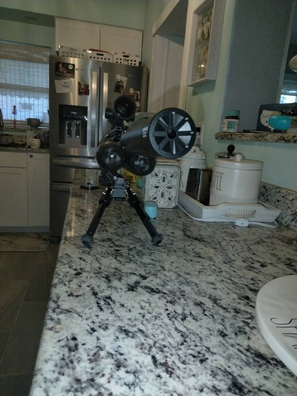

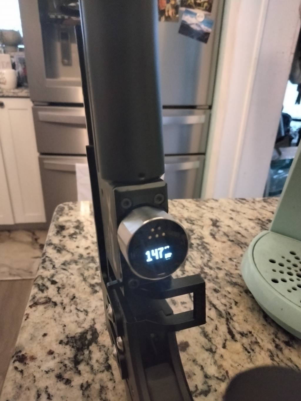

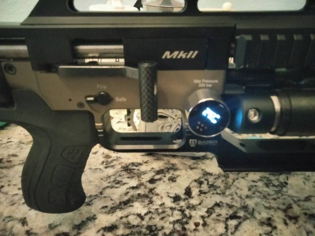

Finally finished all my modes on my impact .25 cal. So I stared with a stock .25 MKII bronze power plenum rifle. I have added the 700mm Superior heavy liner , Ernest carbon fiber sleeve, Ernest dual transfer port (opened up some and polished), Moto Mikes titanium barrel sleeve topped with a DonnyFl Emperor also have a Sumo. Internals just has the FX power slug kit and all parts are polished. Utah Airguns bolt block with the .25 NSA pin prob and that was sanded down and polished. Saber tactical dual bottle kit with x2 600cc carbon fiber bottles, Saber Tactical bottom rail, x2 Sekhmet digital gauges, Saber tactical cheek riser, carbon fiber mono pod, knock off Atlas bipod, side shot with 28 round mag.
Reg is set to 147 bar and it's slinging 36.2 NSA slugs at 1040fps and if it's 250 yards and closer it doesn't stand a chance. That's as far as I've stretched it's legs so far.

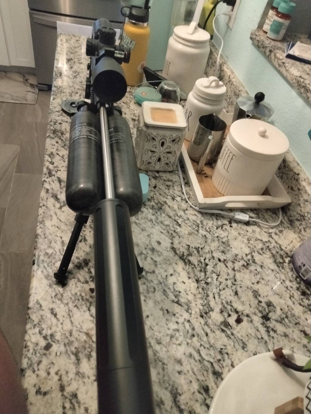

Why no barrel shroud? Love the dual bottle setup—-didn’t know that was available! What scope mount is that?
When I bought the gun it had a nice carbon fiber barrel shroud and a 1/2x20 end cap but it touches the 600cc bottles and does not free float. Thats why I got the Moto Mikes titanium sleeve. I figured it was stronger and won't rust.

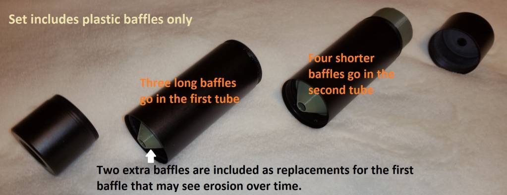

A plain FX moderator with one extra center section and 3D printed baffles will be much quieter and lighter than either of your current moderators. Night and day difference, I've owned them all.
I don't 3d print anymore but I will share the files.
If I could find someone to 3D print it I'd be happy to try one. Ive got the stock moderator I'd just need to find one more middle section.
No I don't make or sell these things, I study new ideas what could be reused in other mechanical fields.
I am a firm believer that these ldc's (or call it whatever you like) are not a help for accuracy but quiet opposite, the projectile suffers from turbulence shock (inside chambers) before even exits to an open air.
My design has not affected accuracy. I could see where the open tube designs with felt and wire would have lots of turbulence because the compressed air passes the projectile before exit. No way to field test in Canada.
....I could see where the open tube designs with felt and wire would have lots of turbulence because the compressed air passes the projectile before exit. No way to field test in Canada.
