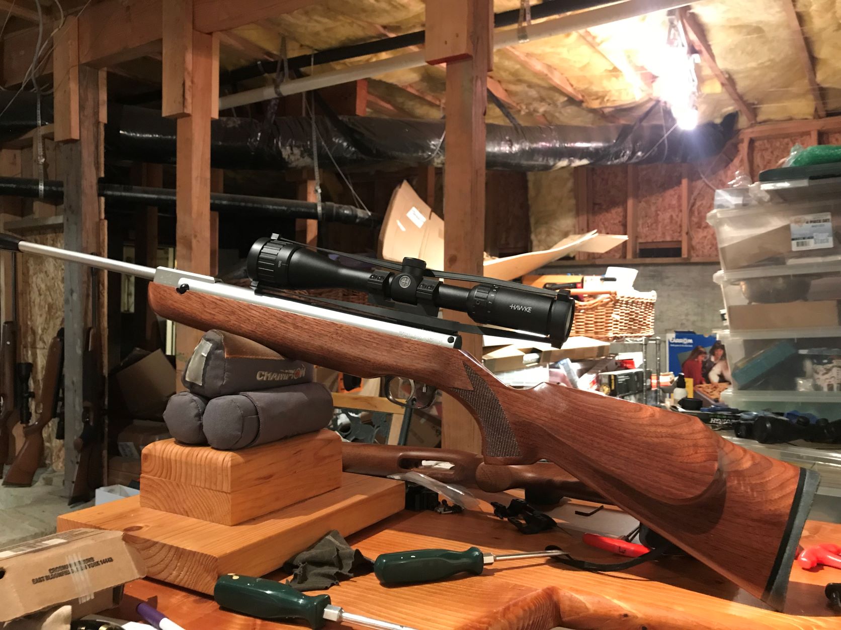

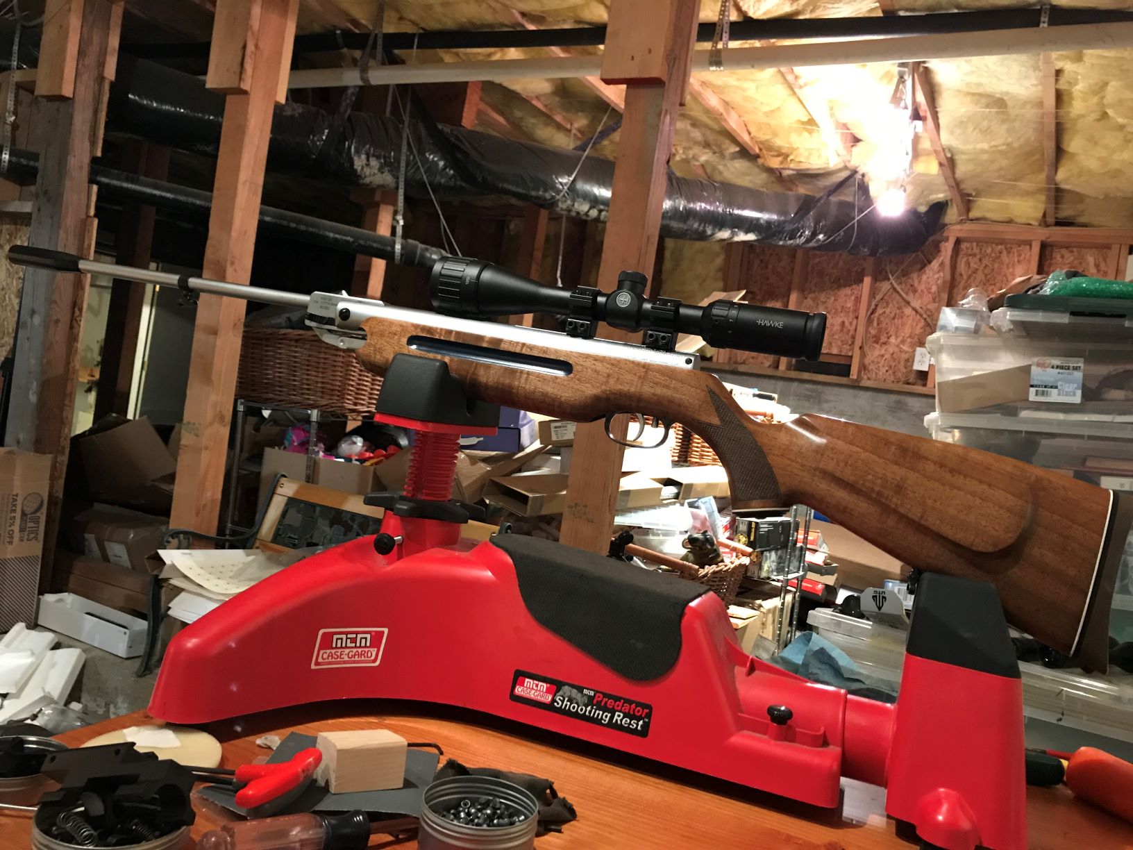

Purchased an unfinished (no stippling) Walnut stock for my RAW HM1000x LRT last November. Martin wasn't able to ship it until March '22 and I've been kinda working it off and on now for 3 months. For $595 (not including shipping), the stock didn't contain any fancy grain structure (soft wood) and had filled knot holes on the pistol grip.
I always wanted an original RAW stock made pre-Airforce, having wings around the manometer; however it seemed overpriced in its unfinished state.

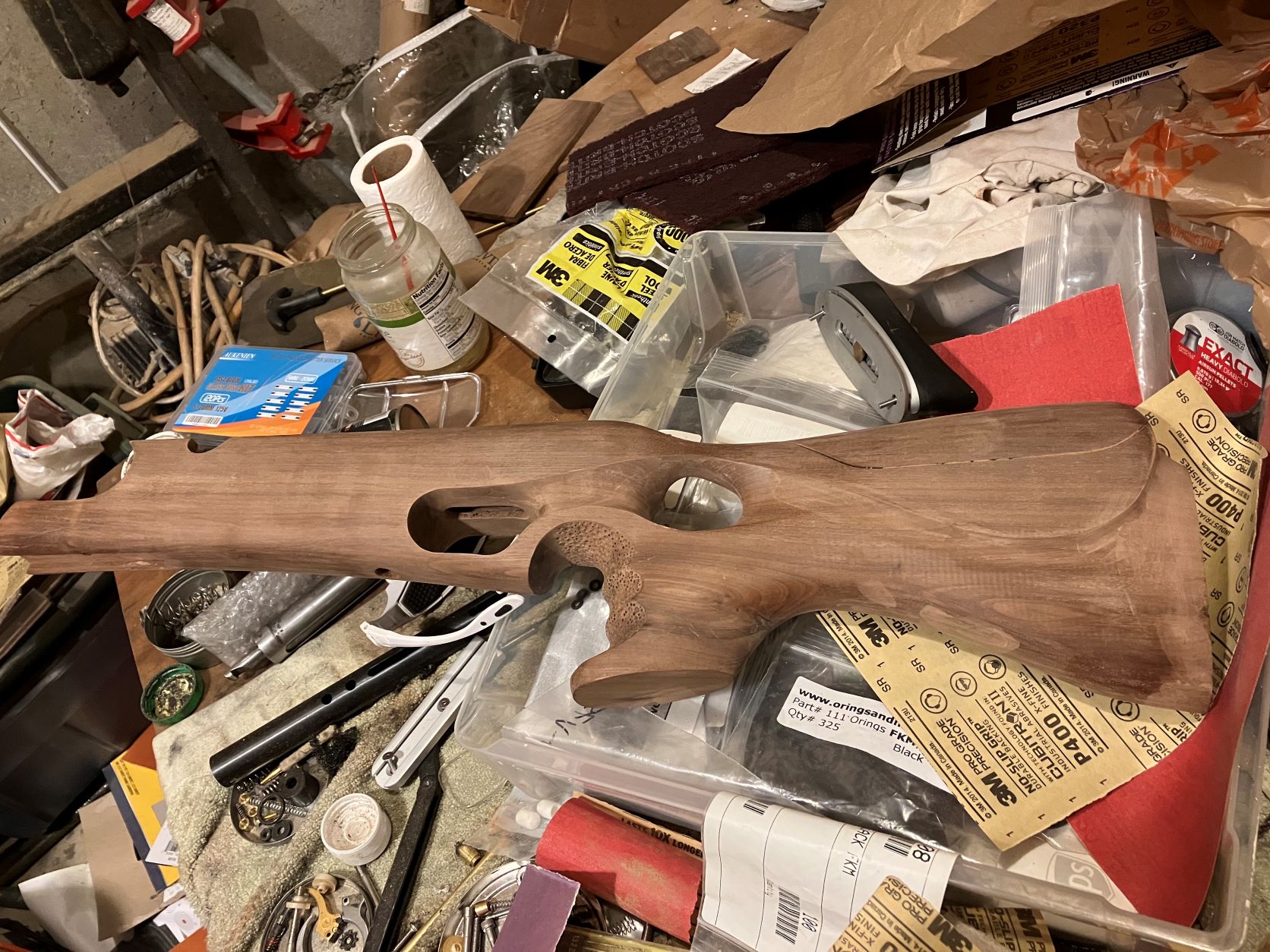

Have finished sanding down to 1200 grit paper and she's starting to look nice. Was going to leave the pistol grip un-stippled until I noticed the end-grain on the grip just didn't look nice enough to leave uncovered. Watched some stippling videos and bought a $9.99 HF mini-moto took using diamond bits. Only wanted to stipple the hand grip area of the pistol grip, so left more un-stippled than on OEM RAW's.
Not sure if I want to hit it with a light coat of walnut stain or not to give it a dark complexion, but will go with numerous coats of tongue oil.
Should have it finished sanded later today - still have some tough end grain a minor dents to remove.
I'm hopeful she will turn out much better than I'm thinking ...........
