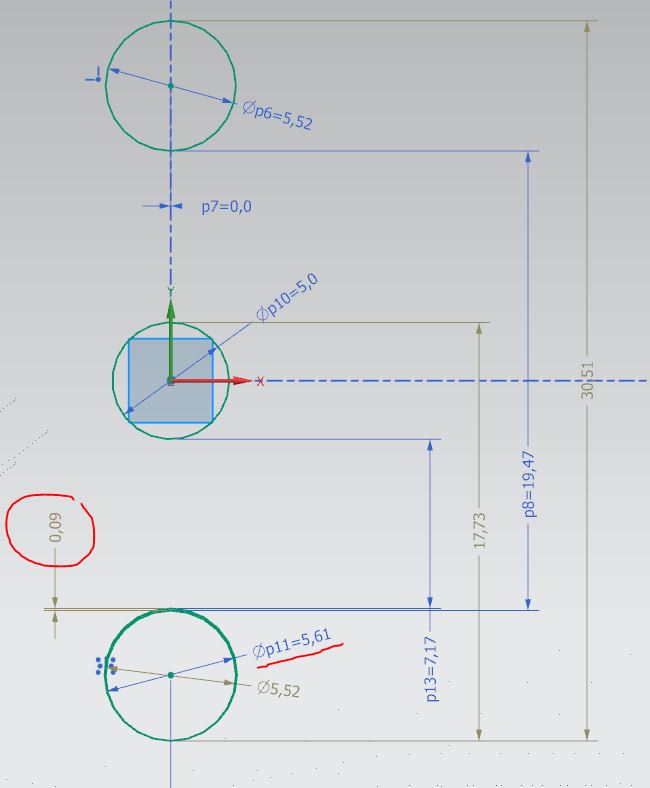

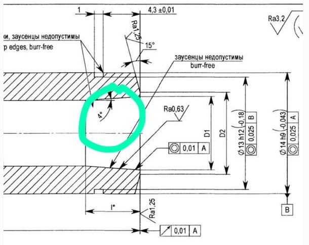

What I noticed also that my custom barrel doesn't have that 4 degree taper, also last night I just did some measurements, and looks like the breach end lead-in is not centred, but offset for 0.09/2 mm. So I may have a combination of "errors" that I could fix with a small lathe, on my own in weird time at midnight if comes to that level :) .

No taper needed for pellets...just use a reamer at 0.1mm over the nominal caliber. I remember Scott (motorhead) describing having successfully used a normal drill bit with the corners blunted ever so slightly with a stone (ensures the bit will follow the bore rather than cut slightly off-axis). So the 5.61mm drill you described will work fine for .22 cal. I've only used reamers myself but I have every confidence in Scott's advice.
Go to a depth that allows the pellet head to seat into the rifling when the bolt is closed. In most cases it's as simple as going just past the barrel port.
Then wet sand or use a Cratex abrasive bit to smooth any rough marks and break any potential burrs or sharpness at the ends of the lands so the pellet can ease into the rifling without being gouged.

I believe my .22 barrel lead-in pocket is off (as I measured 0.09/2 off center) this may come from off center rifling or off center barrel bore in the action clamp. I will measure this on the CNC before doing anything further. If anything smaller then the offset mentioned above, I will just do a slight 4-5 deg angle into lead-in edge, but if the offset is still bigger (I did not index the barrel to measure that scenario) I may need to enlarge the lead in for 5.61+ 0.09/2 centered to rifling.
