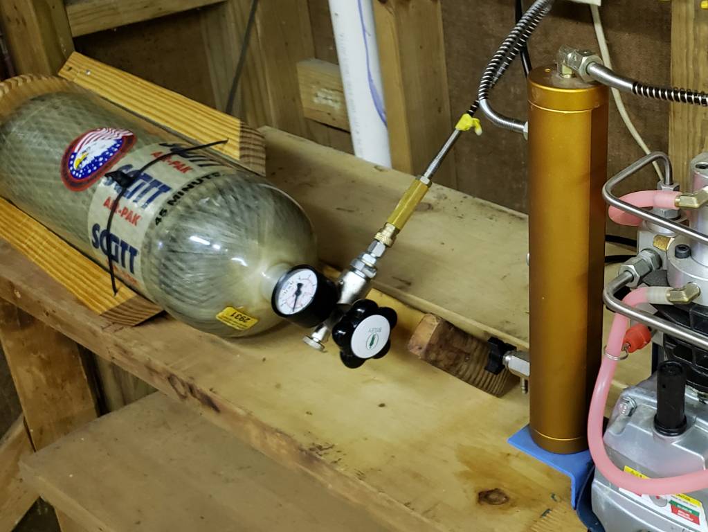

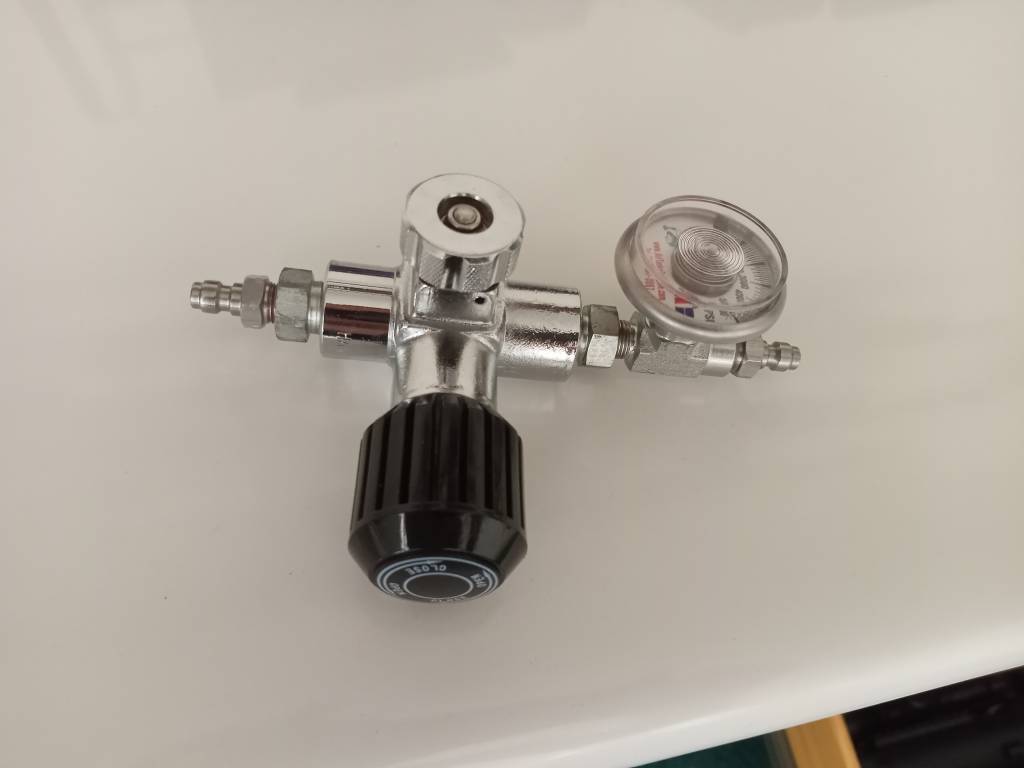

i built this to make fills alot more controllable .. 40$ for the valve on ebay then several fittings and a gauge ..its real handy, i use it every time .. i can just leave it hooked up to the bottle and the bottle on till im done shooting ...
Sounds like the Delrin seal is getting worn out, you could replace the seal, but I doubt if you could buy one, you most likely have to make it yourself, you could make a restrictor from brass bar stock and fit it in the pipe fitting on the manifold, you would have to play with the sealing so it only allows small amounts of air to bypass, or pay big money for a new manifold with built in restrictor.
