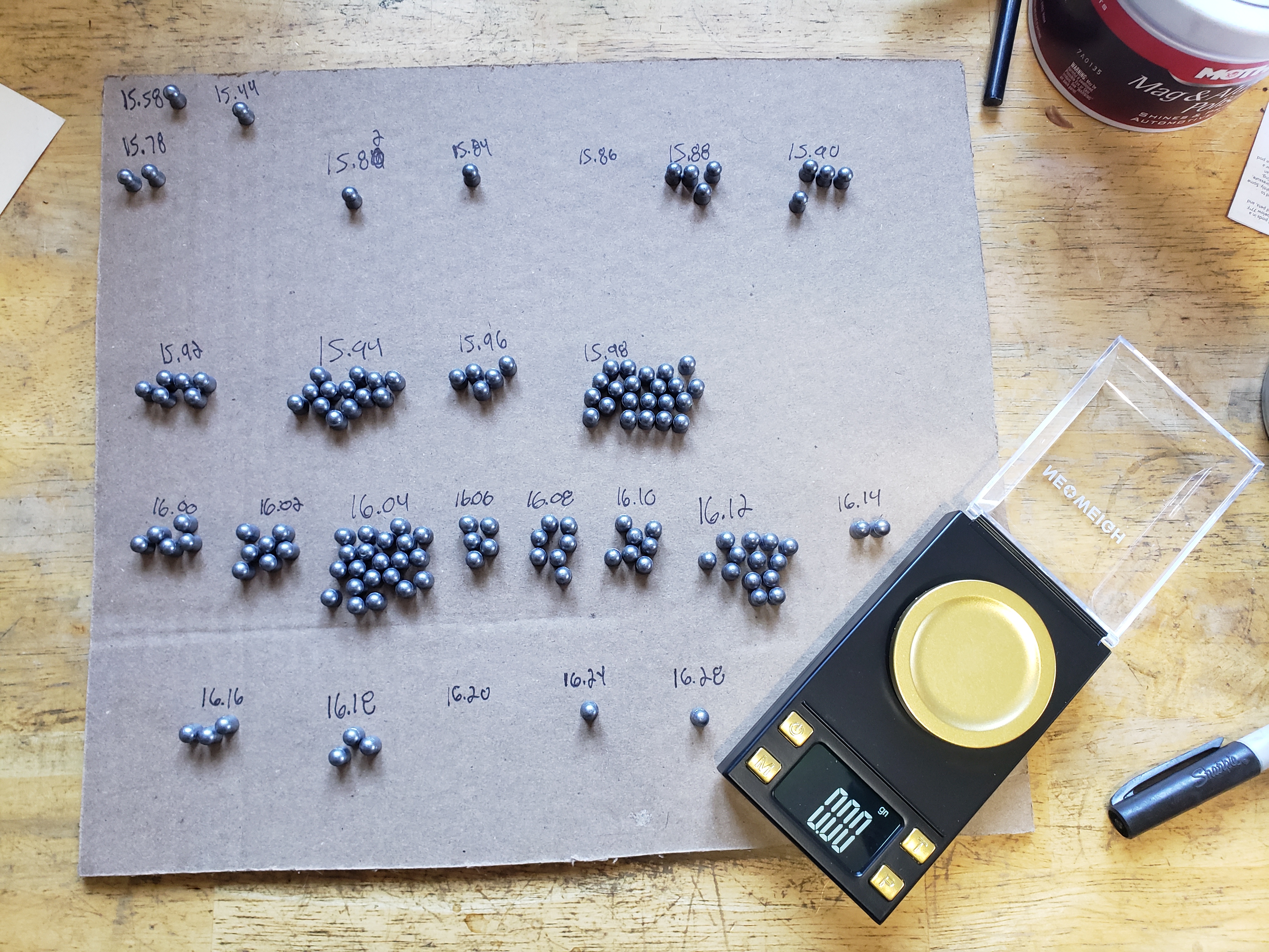

First attempt at sorting by weight
Ok so I'm really not sure exactly how to process this. My gut is telling me to seperate the 15.98gr (possibly 15.94gr?) through 16.12gr into a seperate tin for testing. These pellets as a whole have done very well for me aside from the occasional flier. Looking at the group here I think its safe to say where those occasional fliers came from...
Just looking for some insight from guys who have done this before I start grouping them. It's a bit too windy to do that today anyway so hopefully next week.
Don't think you need such small divisions. I sort into batches .08 grains apart. While nothing wrong with .02 grain divisions, I doubt it will help either. I would sort into 15.80-15.88/15.90-15.98/16.00-16.08/16.10-16.18/16.20-16.28 (Those lighter than 15.80 or heavier than 16.28 are outlyers and are saved for punching tin cans at 25 yards 😂)
That's plenty small divisions in my mind. That's the way I sort then after I have many tins of these sorts, I head size each tin.
I would throw all the ones at the extreme ends of the scale for both top and bottom in a different pile expecting them not to perform as well. It would be interesting to see what kind of groups come from that pile….
Then group the others into two piles. It would be interesting to see what shoots better or if there’s a difference between the heavier and the lighter pile.
The only time I’ve sorted is for a nationals field target match. I just threw out the highs and lows and kept the ones in the middle.
That seems like a wide range of variation.

Ok so I'll make a junk tin for the crazy outliers! I'm sure they'll do well enough on spinners still. I like your system though so I'll go with something like that for my accuracy tests. Thank you!

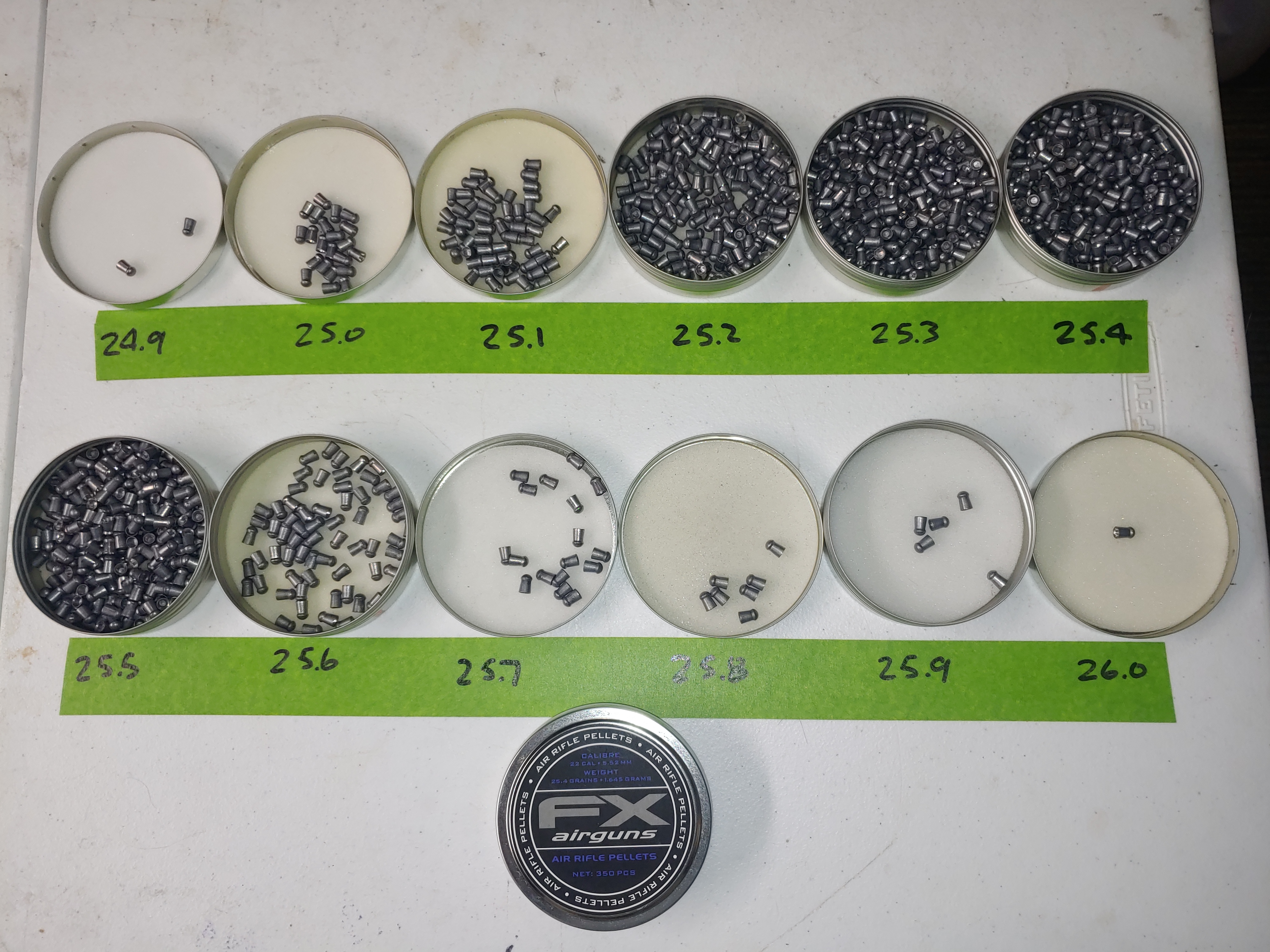

That's EXACTLY what I do. Here is a pic of some I sorted and will shoot each tin separately at .10g differences.
You know if someone had told me a few years ago that I would be measuring pellets to the 1/10 grain I would laugh in there face. Now I'm looking at your picture and thinking you're a genius. What has this hobby done to me?

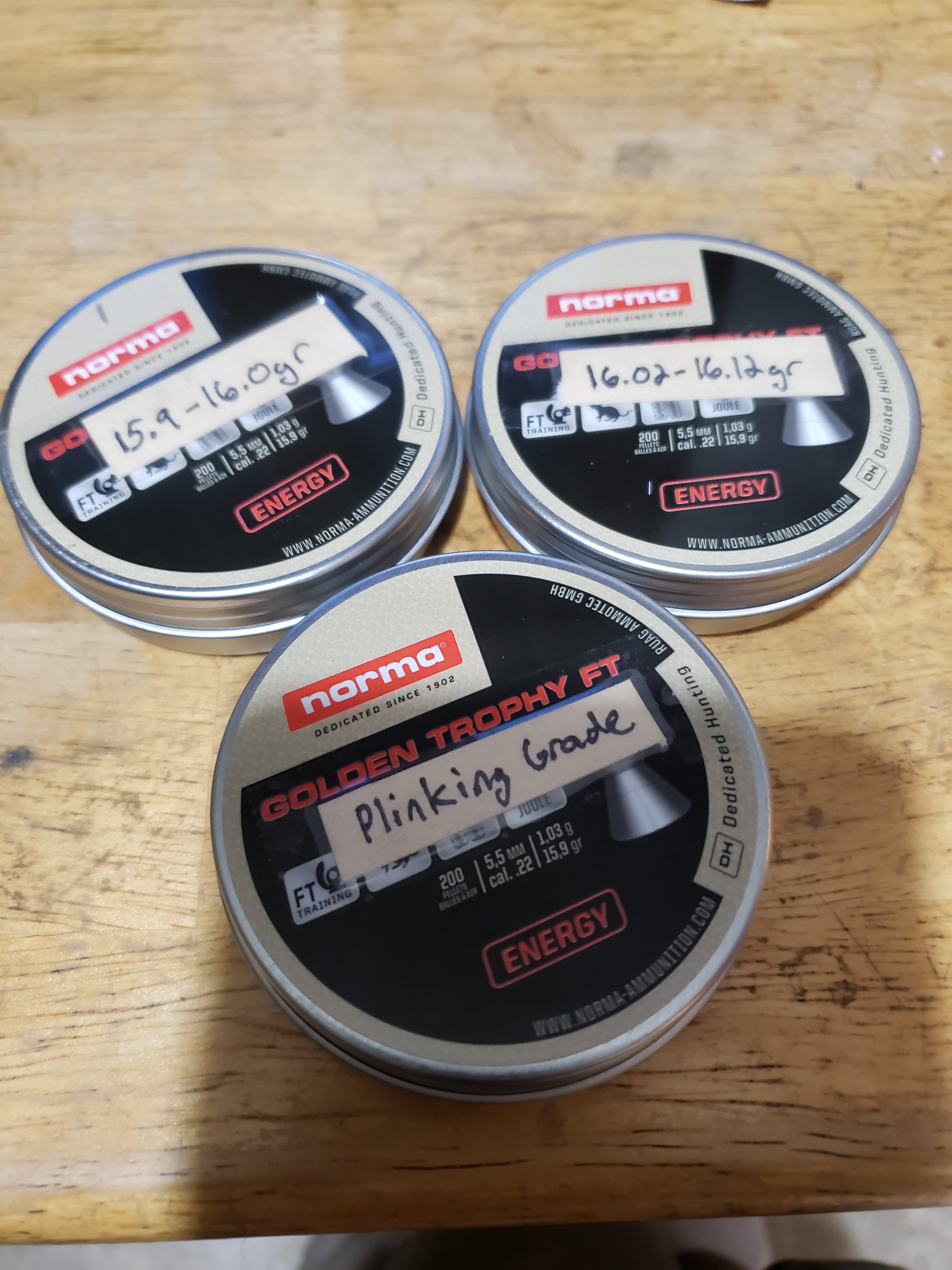

Alright so this is what I went with to keep it simple here

Not even going for minute of squirrel eye honestly. Every tin seems to have a few pellets that inexplicably don't go where they should and is exaggerated by longer ranges. Those four in the top corner and the two in the bottom right corner definitely explains the fliers though. Keep in mind this was only a 200 pellet tin so a 500 pellet tin would likely be even worse. Honestly I probably could have just tossed those 6 and been happy with the results, but since they're already sorted I may as well sperate them even further. The hard part has already been done!
