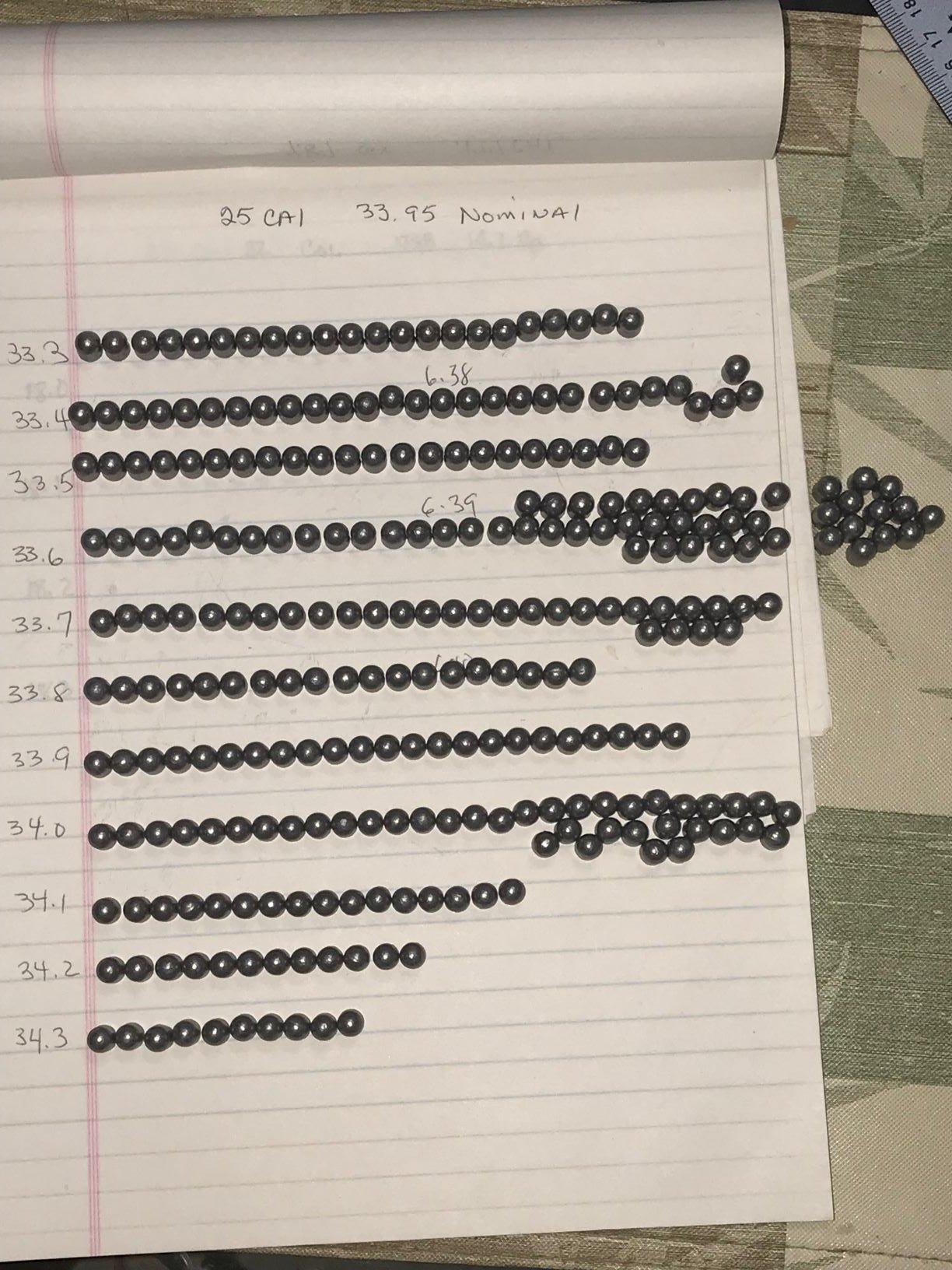

OMG had no idea people got this detailed about their pellets. I get the sorting thing but assumed a .25 gr variance was about as tight as made practical sense. However, getting down to .10 grain then sizing them?
I don’t shoot paper except to tune and sight in. My guns shoot nice tight groups. This would undoubtedly shrink the groups a bit but I don’t have the patience. As long as I am minute of ground squirrel head at 50 yards I am happy. You folks seem to be going for minute of squirrel eye.
I do admire your diligence, perseverance and dedication though.
Yeah Chuck,
If your just plinking or shooting out to 50 yards, sorting by head size and weight doesn't make that much difference in my RAW Poly barrel.
When you go out to 100 yards, differing weight matters significantly more, as I've seen (muzzle) ES differing 30 fps with a 1 grain pellet difference.
It all depends on what your goals are and what your shooting.

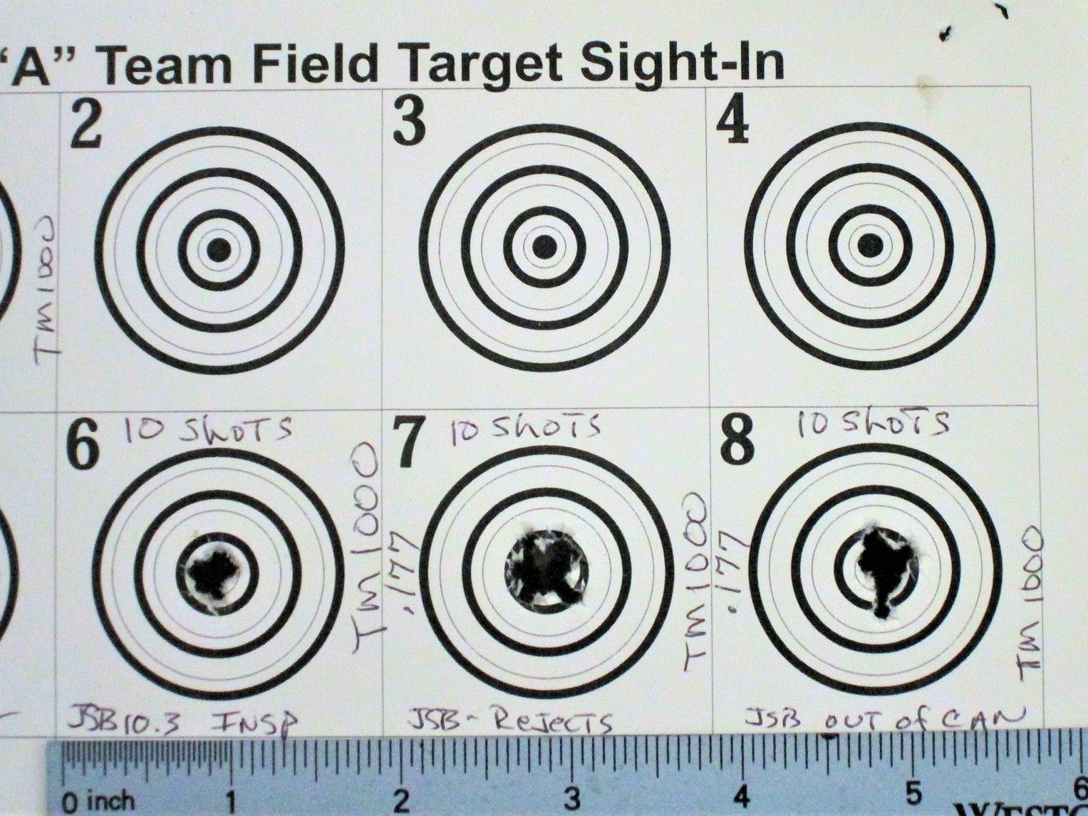

Sorting works. Here's my results with myTM1000 in .177 caliber. You can see how the variations can result in a one point loss in a match.
Reactions: rsfrid
Good report. I've been weight sorting for a couple years. Yes it can make a difference, especially under ideal conditions where the fliers are entirely on the pellet.

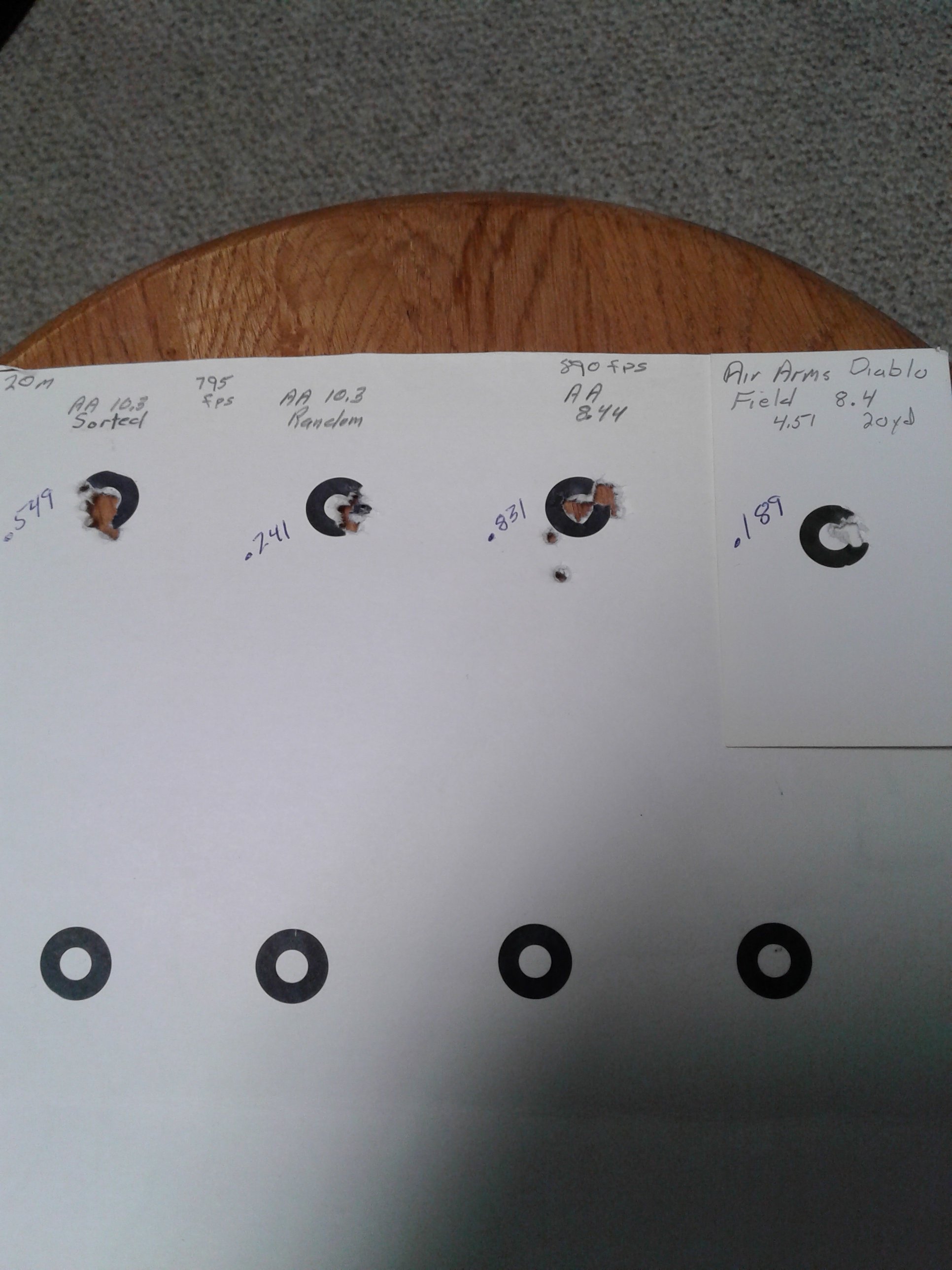

Yesterday I weight sorted 10 pellets down to .02. Then I took 10 at random. Air Arm's 10.3 Diablo Field Heavy. Shot the 10 shot group at 20 meters(22ft) off front rest and rear bag. Yep, random shot a bit smaller. So in the photo is the random pellets on the far left, then the weighed pellets then for comparison 8.44 AA, and on the far right 10 of the 8.44 prior to the current spring. The 8.44 was the best until I replace the spring and increase the fps by 100. Ever since I get verticle with them. Before the 8.44 were best with the 10.3 shooting slightly bigger. With the added 100 fps the 10.4 now do the best. I never sorted pellets before, might not again unless I can see a difference outdoors this summer. I think (dangerous) with a Springer there is so much on the shooter that sorting might be busy work. Now, a top end PPS, no. Measure ments are edge to edge less .177, or center to center.

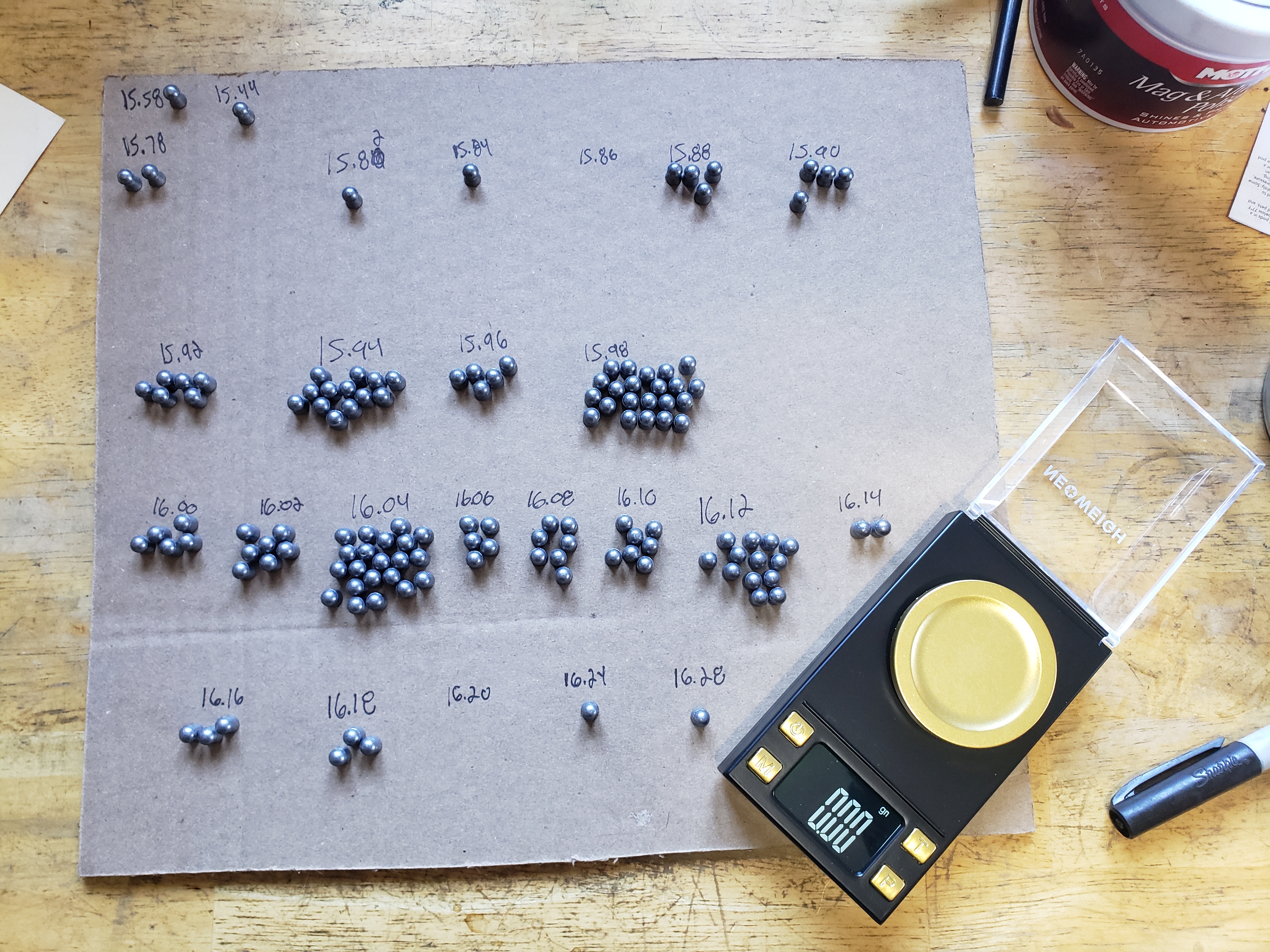

Ok so I'm really not sure exactly how to process this. My gut is telling me to seperate the 15.98gr (possibly 15.94gr?) through 16.12gr into a seperate tin for testing. These pellets as a whole have done very well for me aside from the occasional flier. Looking at the group here I think its safe to say where those occasional fliers came from...
Just looking for some insight from guys who have done this before I start grouping them. It's a bit too windy to do that today anyway so hopefully next week.
Way too precise on weight. Tightest I’ve ever done was say 15.8-15.89. But you can do 15.1-15.29 for 2/10g spread. That’s plenty good overall.
