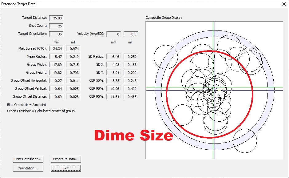

Shot this target with my HW-98, .20 cal, JSB Exact, SWFA 10x at 25 meters this afternoon. Wind was 3 to 8 mph from 5 to 7 o'clock. I made a zero change at the end of the first 5 and again at the end of the second five. Anything outside the seven ring is on me.
On Target produced this aggregate.
That’s a good first target. As Dave said, shooting BR cards is an order of magnitude more difficult than shooting groups. Not many take up the challenge.
It looks like this is a printed copy of the 25m card…and it looks like it printed small to me. The 10 ring should be .079” and the 9 ring should be .315”. If it is small…then you actually scored even better.
