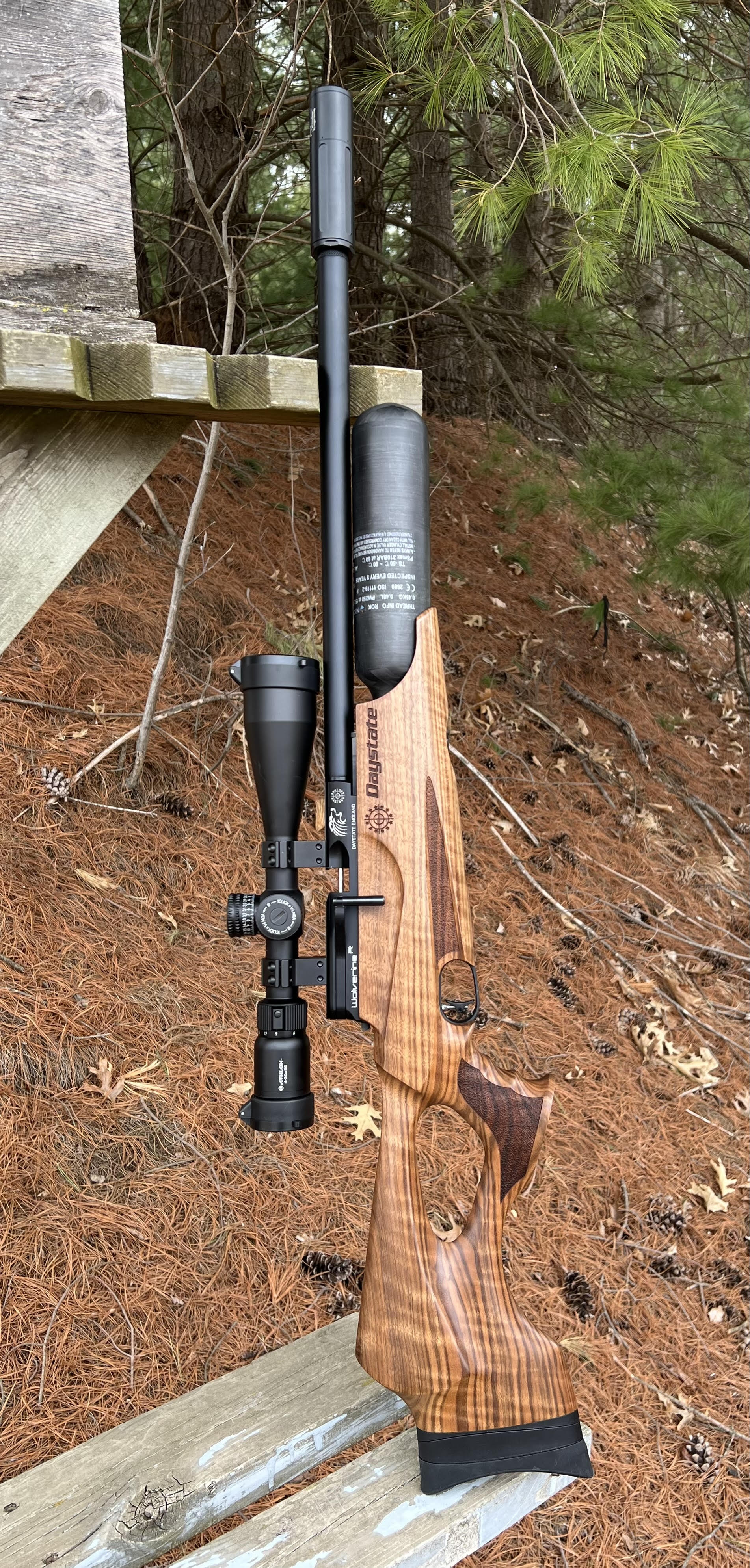

I recently bought a Wolverine R (non HP) in .177 cal on sale at AOA. I love walnut stocks which I think are going away and I was not disappointed. I chose this caliber potentially to shoot FT because of the power limitations, for general plinking and Daystate’s reputation for accuracy. For those, it excels. 160 shots per fill is truly a reality. I also like .177 caliber as it can do the things I like very well and that's paper punching. Don't sell them short because of the power mongers here. I agree with EPG about the trigger. I could get it down to 20 oz and that’s as far as it goes. I’m working with his suggestion to get it down, but it will never match the 4 oz I had on my RAW HM1000. If I can get it down to 10 oz., I’ll be happy. And why you can’t decock it? Only the safety nuts in in the UK can answer that. I recommend this rifle for its advantages outweigh its disadvantages and it's far better than the cheaper third world guns people seem to be enthralled with today. It's $1379 at AOA which is quite a bargain IMO.
I recently bought a Wolverine R (non HP) in .177 cal on sale at AOA. I love walnut stocks which I think are going away and I was not disappointed. I chose this caliber potentially to shoot FT because of the power limitations, for general plinking and Daystate’s reputation for accuracy. For those, it excels. 160 shots per fill is truly a reality. I also like .177 caliber as it can do the things I like very well and that's paper punching. Don't sell them short because of the power mongers here. I agree with EPG about the trigger. I could get it down to 20 oz and that’s as far as it goes. I’m working with his suggestion to get it down, but it will never match the 4 oz I had on my RAW HM1000. If I can get it down to 10 oz., I’ll be happy. And why you can’t decock it? Only the safety nuts in in the UK can answer that. I recommend this rifle for its advantages outweigh its disadvantages. $1379 at AOA.View attachment 558595
I too am one for stocks, the more character, the better IMHO. That's a beauty!
