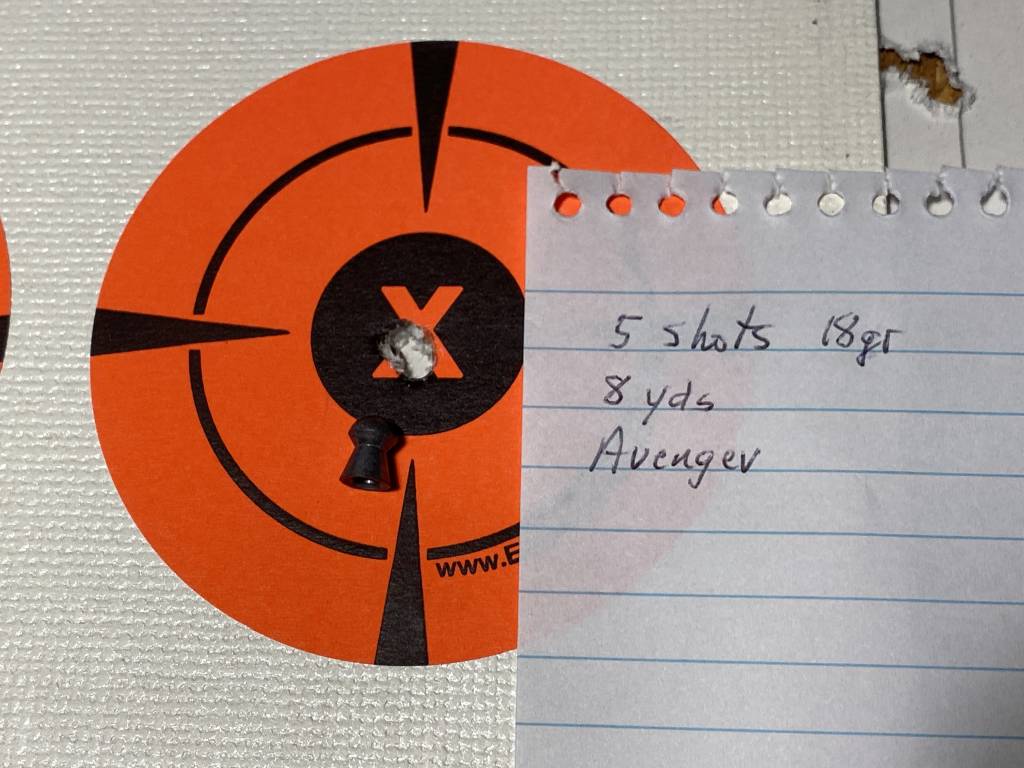

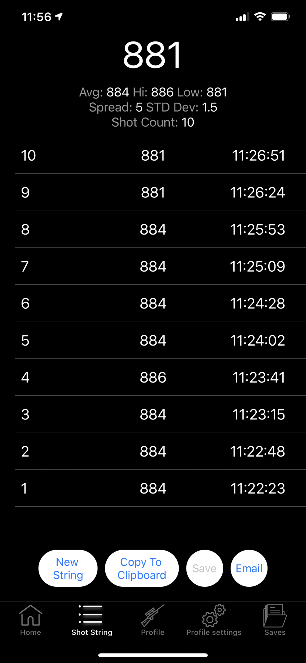

I have the wood stock version in 22 for indoor shooting. I have it tuned for H&N 18 gr pellets at 884fps and shot my first one hole group. Granted it was 8 yds indoors, but this will show you the Avenger can shoot if you do your part. I make no excuses for anything on the gun, it all works well so far.

I bought the plastic Avenger in .22, then sprung for the replacement wood stock. My experience with the trigger was the same as AirGunShooter upthread; with a little bit of work you can make the trigger nice. It likes CPHP just fine, and is plenty accurate. The external hammer spring and regulator adjustments are a nice touch. I have it set up now to get 80 or so shots using the CPHP at 840 fps.
