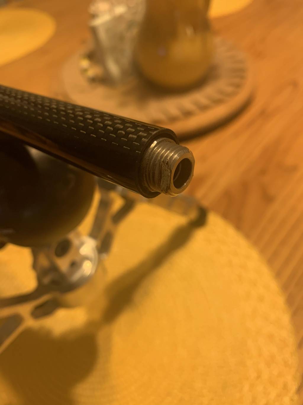

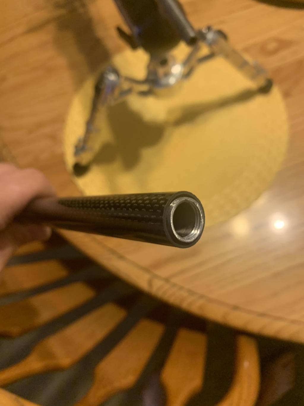

You got the idea I cut .1brass into 2 washers and slid over the barrel which was enough for the shroud to bottom out and put some tension on the barrel. Granted as you say it’s only 1 grub screw your pulling against so while you can’t gorilla grip things it does stiffen the barrel
I did the same thing with a little nut that I ground down. It fits almost all the way inside my barrel tensioner so that I can tighten it by turning the carbon tube. Once it’s snugged down, it keeps everything tight so it’s super consistent.
