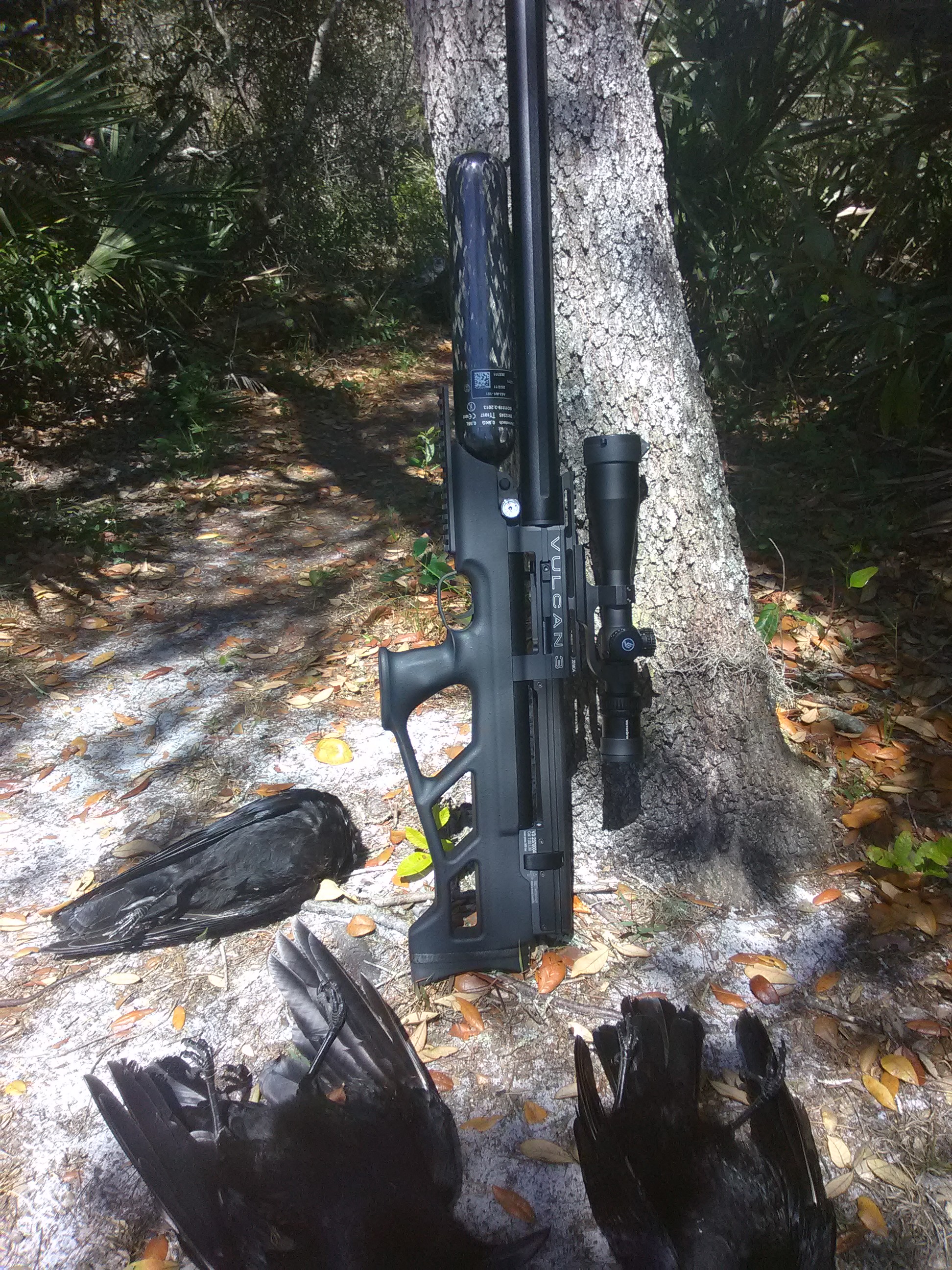

I have the Vulcan 3 in the smallest size / caliber, and it have been pretty much a joy to shoot, only let down when i have spent too much time trying to get something to shoot well that would not shoot well in it no matter what.
Also stock, if you want to tweak on the regulator, you have to bleed both the tank and the rather large plenum pipe, that cost a lot of air which may be a issue if it is not readily available to you.
Also the Vulcan 3 regulator, it have no markings on it, so if you do not have a reg tester ( additional expence ) it is somewhat guesswork where you are on the pressure. at least Humas aftermarket regulators have a scale you can go by, but i am not sure its 100 %, which is also OK you dont need to know your pressures just what work, and where to put the regulator if you go a little back and forth in what you shoot.
The ghost are easier to tweak / dial on, and if you go pesting in a barn of other fairly small place there is no need to drill the poor pests with +40 - 50 - 60 - whatever food pounds of force, so dialing back to 20 - 30 FP you also get many more shots on a fill.
