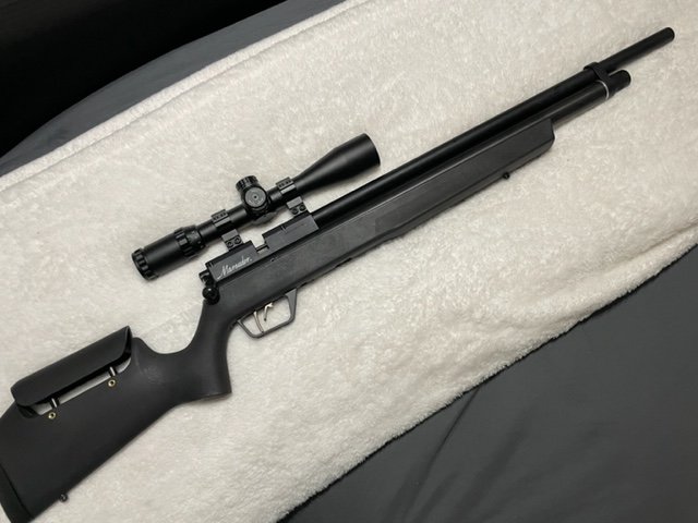

OK. By the time I got the scope on it and pumped it up it was dark out. Have to at least see if it works though right? Shot 5 shots into an archery target just for function out behind an out building with my boy holding a flashlight. Trigger is real light. Cocking action not so smooth. Pretty much what I expected. Pretty large in size but feels lighter than I expected by the specs.
Marauder w/ Center Point 3-12X44

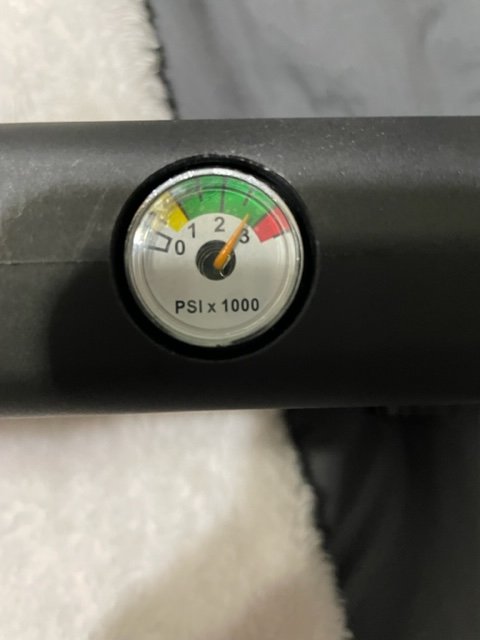

This isn't gonna work though. I filled it to like 2980, just BARELY below the 3 line. Dry fired it twice and shot 5 pellets. Now the gage reads like 2750:
Losing 200+ psi in 7 trigger pulls isn't gonna fly. Especially as long as I'm still filling with a hand pump, ugh. I assume backing off on the hammer spring would help? I have a chrono ( long time PB reloader) we'll start getting it sorted out this weekend.

All common small gauges are general reference only. But depending on your shooting desires tuning it down Will get you more shots. Turn it down using all adjustments ideally, or just use the transfer port strangle screw (?) around 600-700fps they certainly are quite and a bunch of shots. The 1st airgun to bring 3 major adjustments to the general public.
While you are in there take the extra torsion spring out of the trigger and adjust, the 1st gen1 was a mirror copy of a Theoben match trigger(mag is a copy also) and even with the slight change an excellent trigger.
