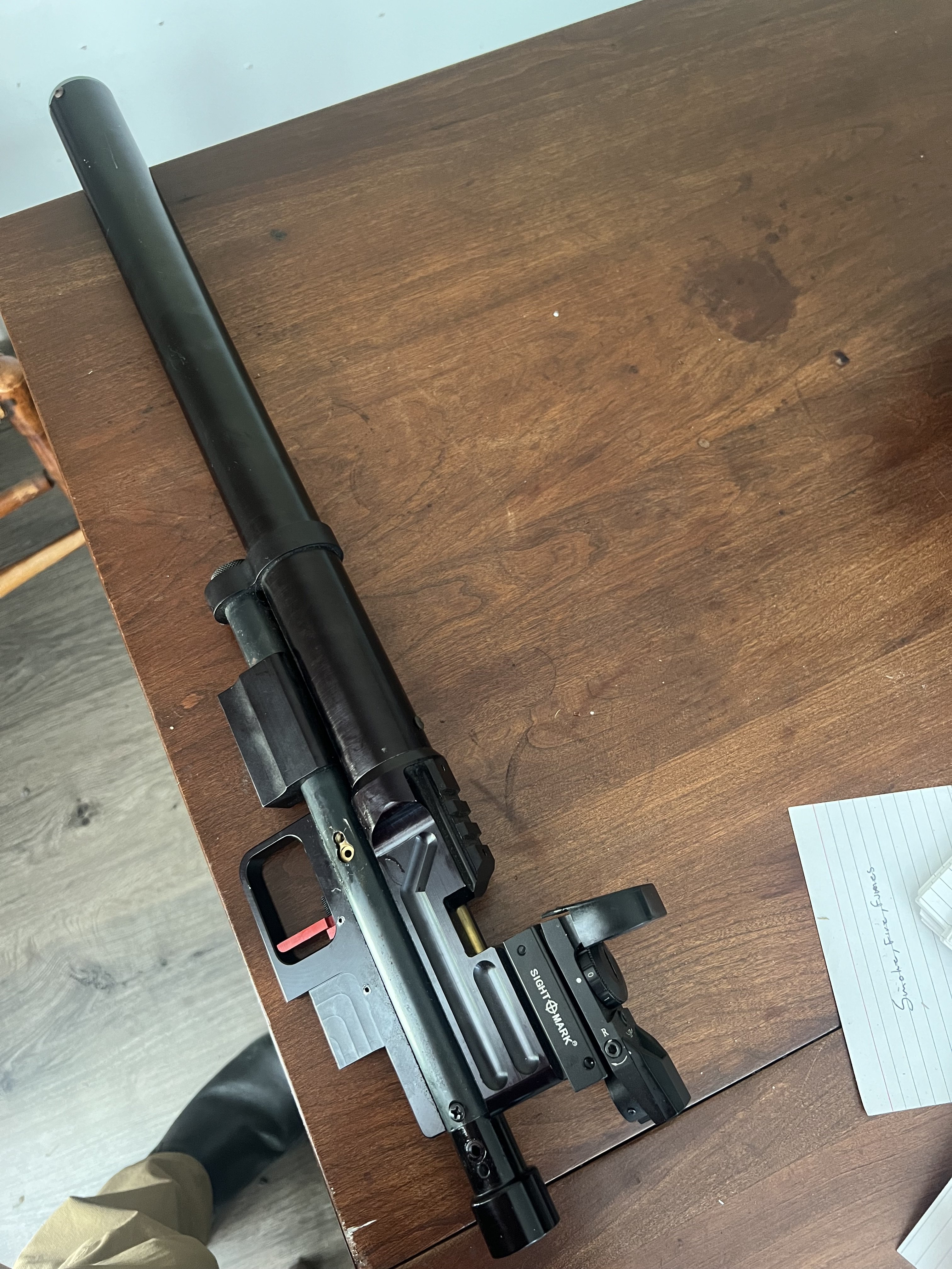

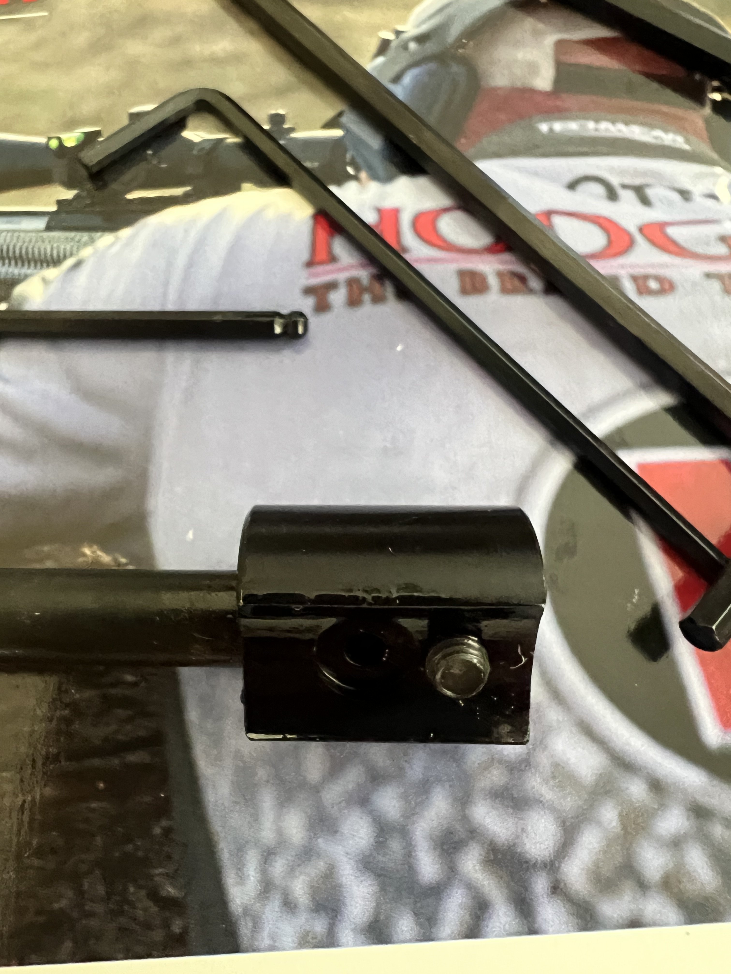

Hi. First time poster. I have a very modified Crossman 2240. It’s a PCP conversion and is heavily moderated. I would like to keep shooting the rifle as it is quite fun. It uses a Ninja Paintball buddy bottle as the air source that screws into the back of the rifle.

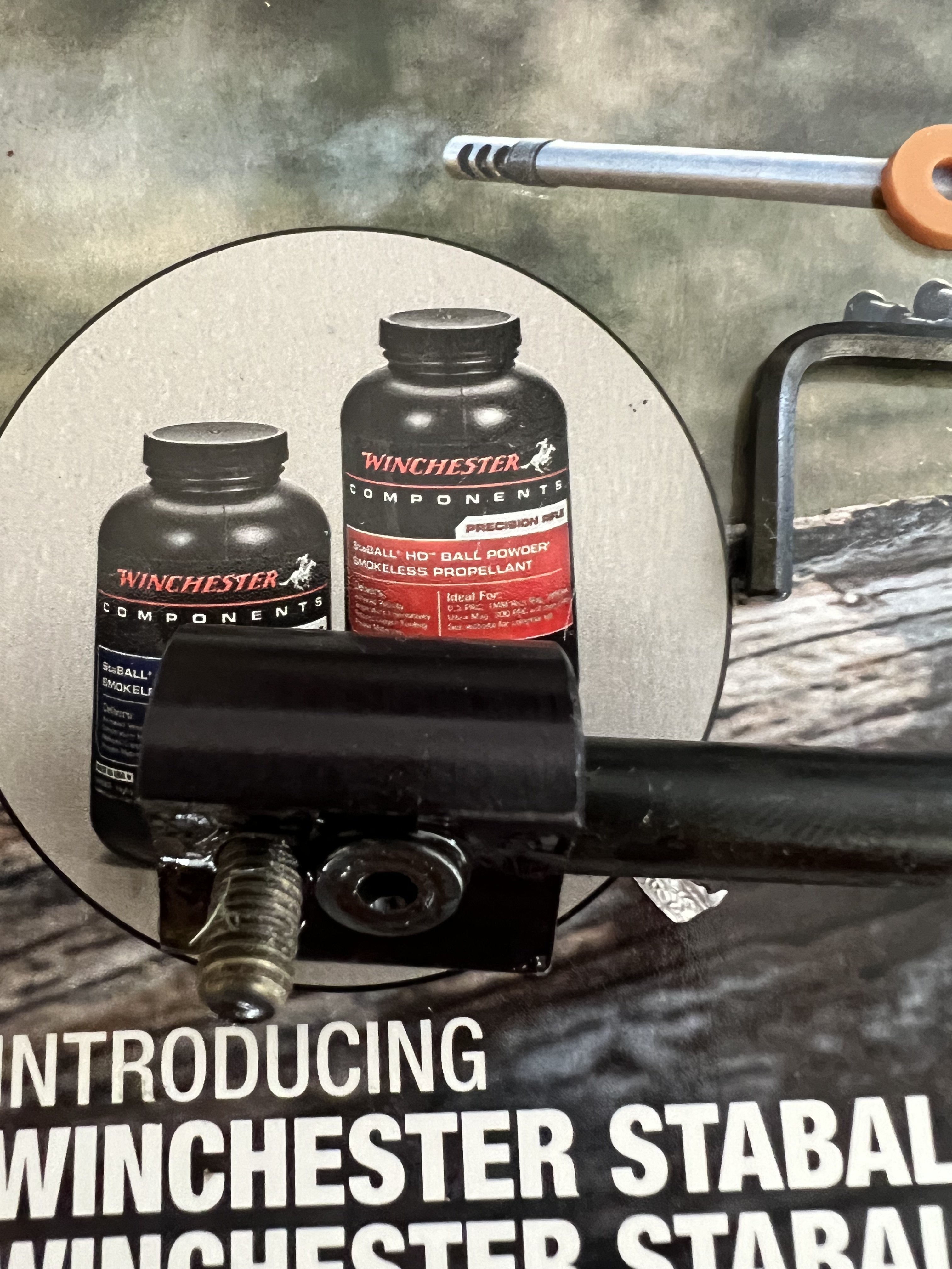

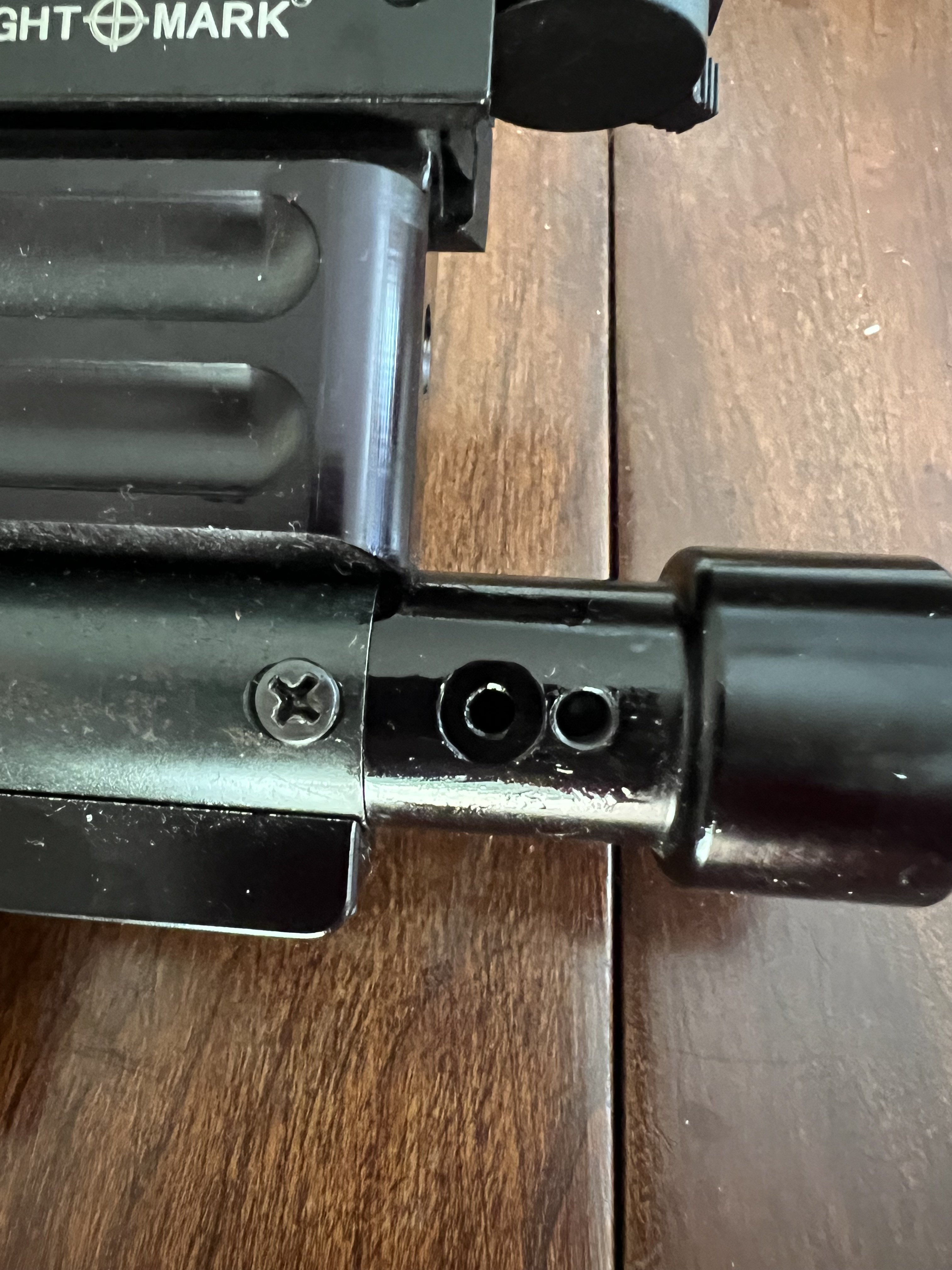

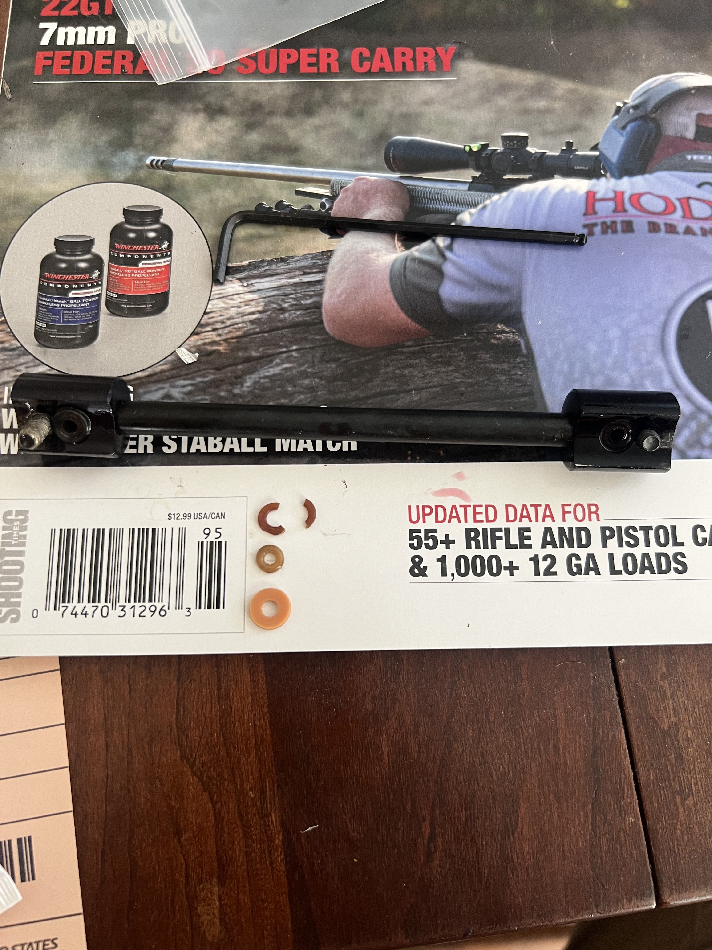

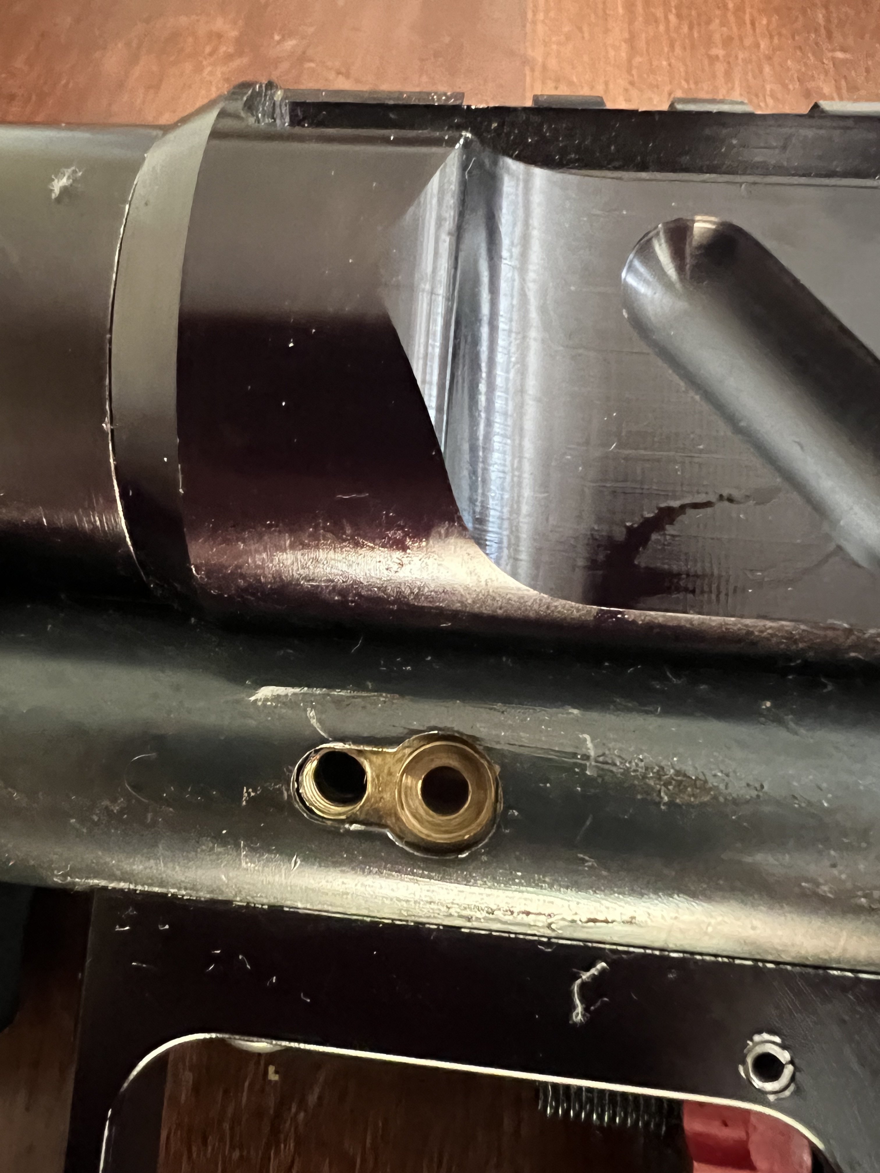

Sadly the seals have dried out and cracked and a normal seal kit will not seal the interface between the bottle and the rifle. There is a tube which connects the bottle to the transfer port and it has two seals. One is flat the one that is broken in the photos. The other is a typical o-ring seal.
I don’t know any of the sizes of these seals and I’m wondering if anyone here can help me with finding new seals. So I may shoot my rifle again.

View attachment 482266Hi. First time poster. I have a very modified Crossman 2240. It’s a PCP conversion and is heavily moderated. I would like to keep shooting the rifle as it is quite fun. It uses a Ninja Paintball buddy bottle as the air source that screws into the back of the rifle.

I went on amazon i think i spent 15 bucks got 300 plus o-rings with chart for sizes i use them all the time and that way you will def get the size you need
