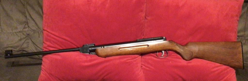

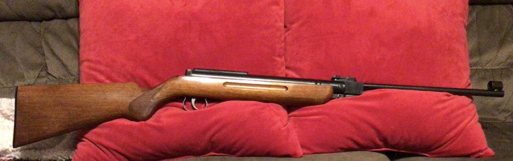

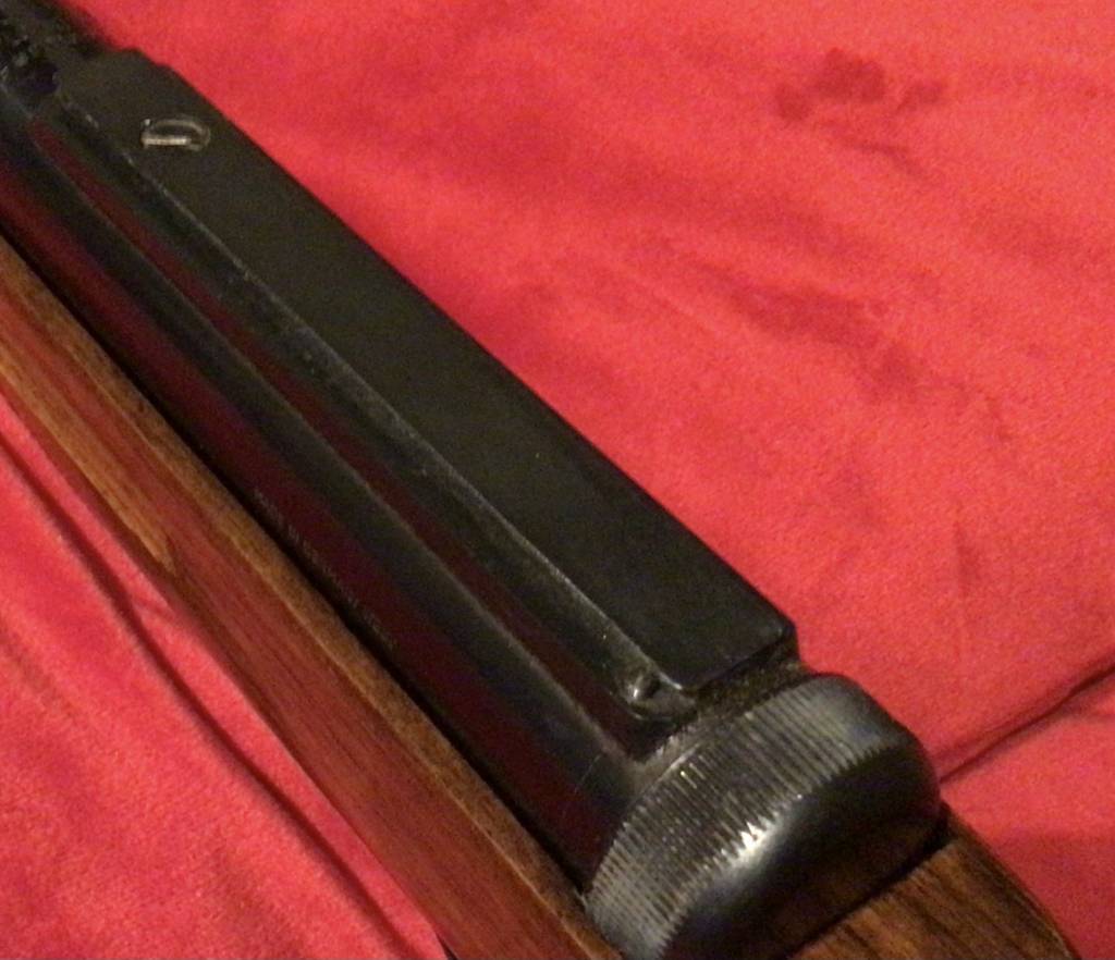

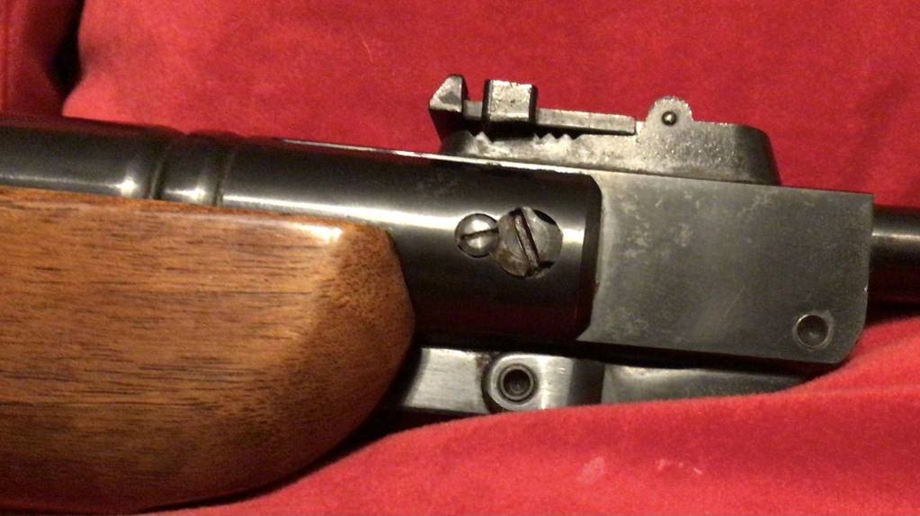

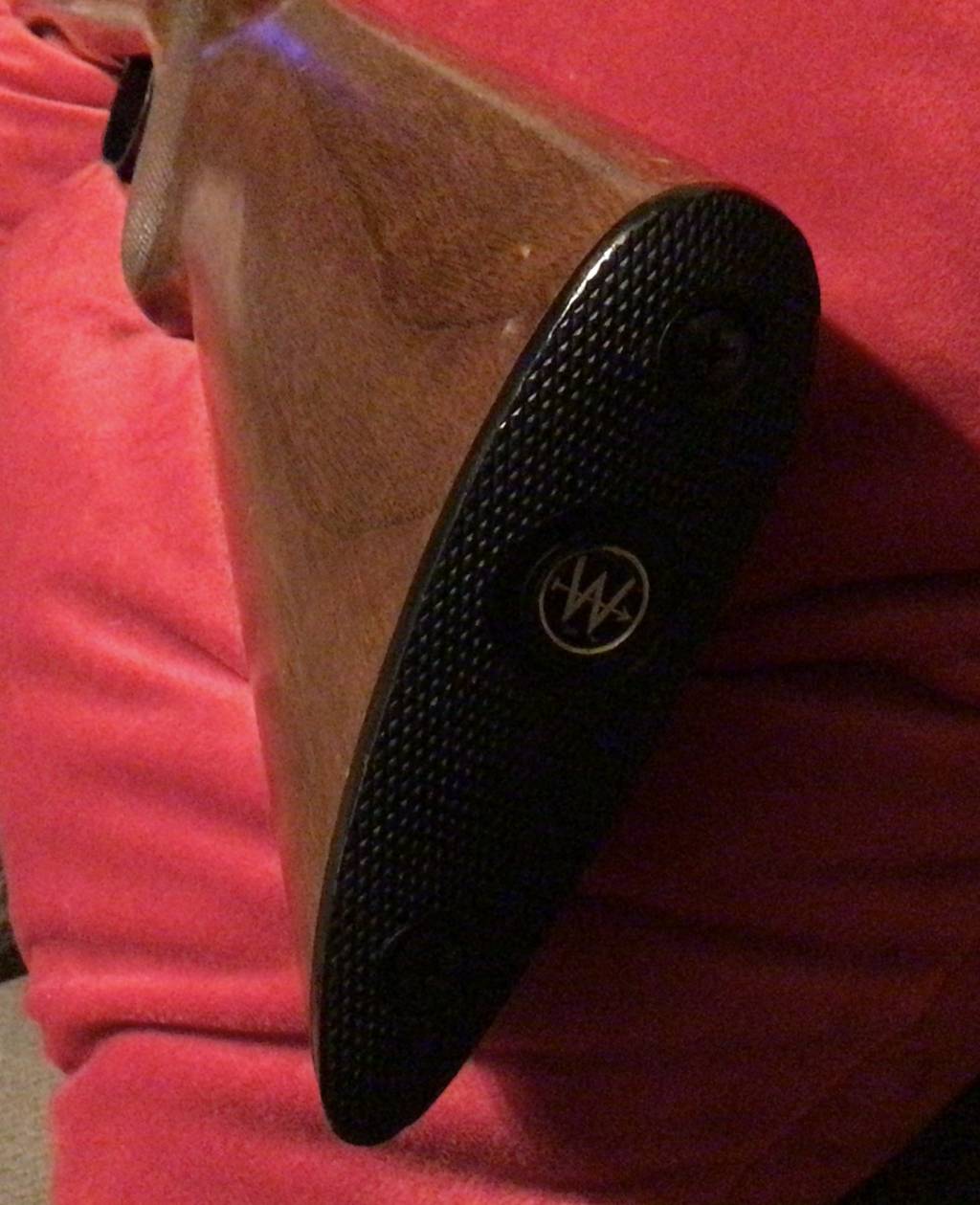

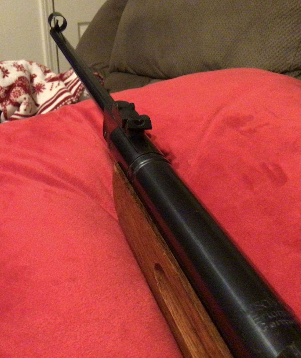

Well with my first purchase of 2021 I got a vintage .177 Bavaria/Wischo (B.S.F.) Model 55N (deluxe walnut stock), I have achieved a dream of mine and now own all 4 air rifle models that kicked of the magnum era (.177 Feinwerkbau Sport Deluxe, .177 Beeman R1, .177 Beeman Model 250 (aka Diana Model 45) and now the .177 B.S.F Model 55N.

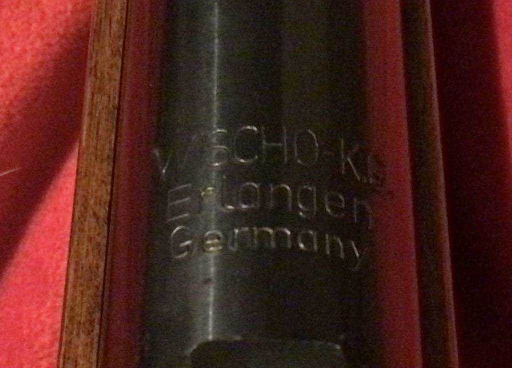

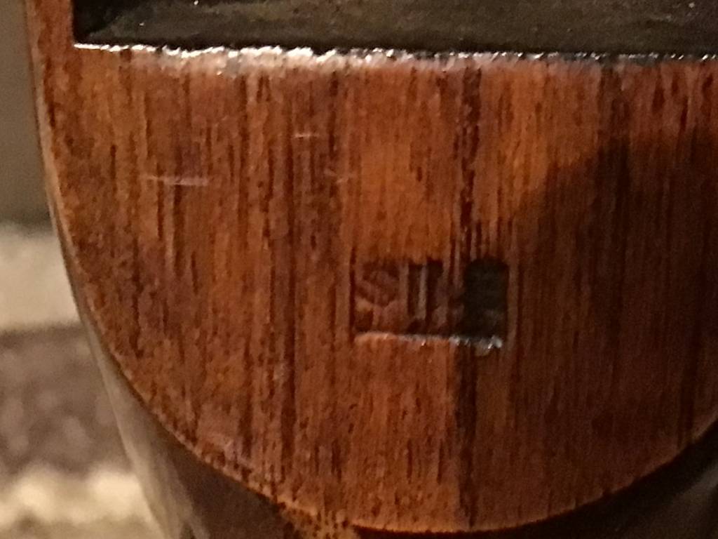

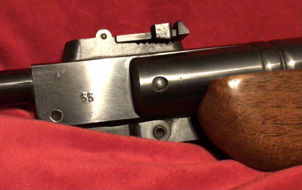

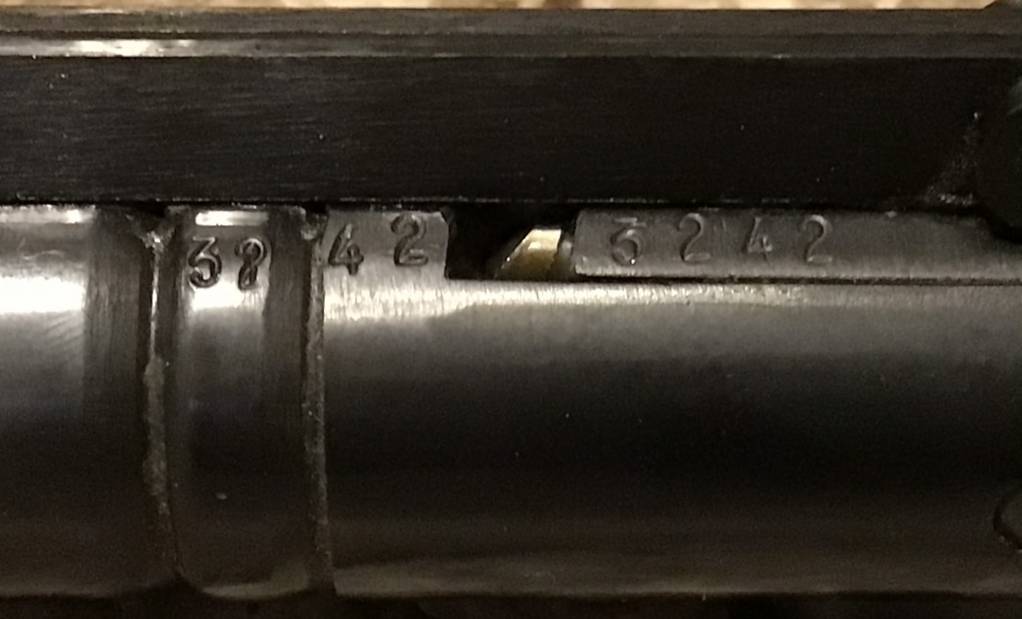

My B.S.F. Model 55 surprised me when I found matching barrel and action serial numbers. Also it has some sort of stamp in the stock just behind the action (not sure what this is for).

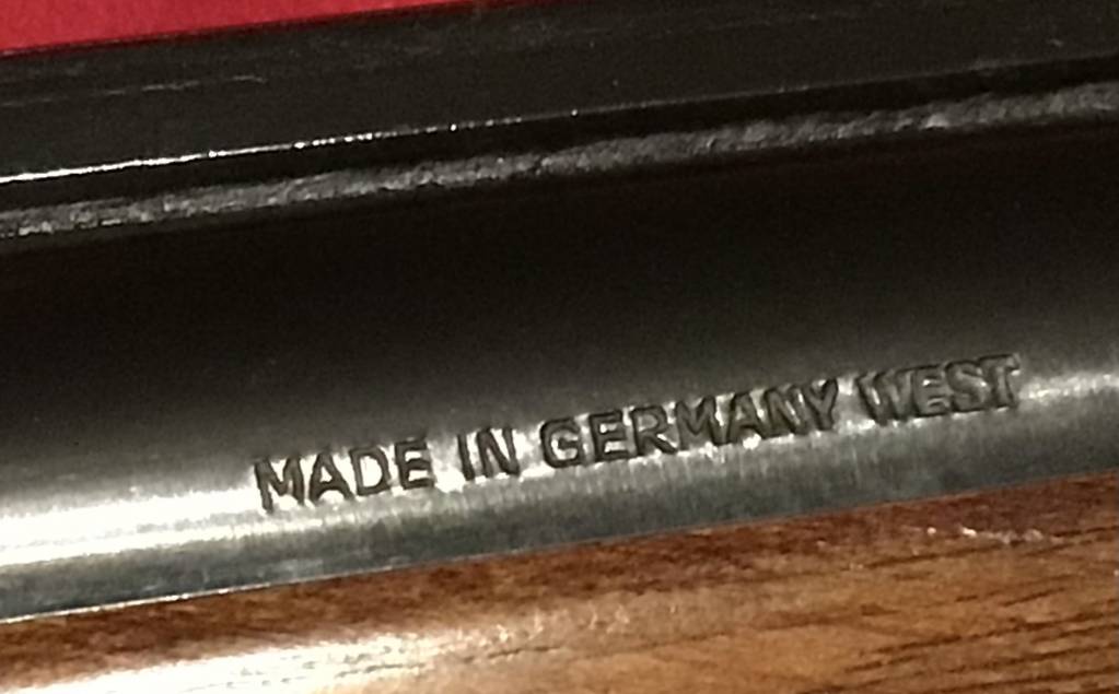

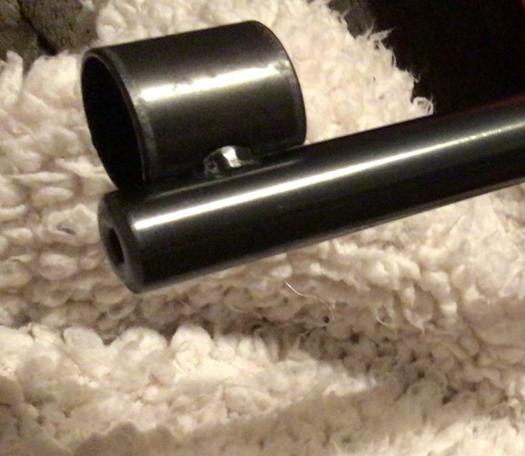

In addition, it has the multi-steel plate B.S.F. trigger, instruction in German stamped on the trigger guard for trigger adjustment, double groves on fore end of compression tube, peep sight rail with stop lug, original front and rear open sights, articulated cocking arm and no safety and leather breech seal (very good condition) so I am positive it must have a leather piston seal (fingers crossed it is still good). Also it is stamped “Made in Germany West”.

The stamp on the stock is "SILE." That''s the Italian firm that made the stock. I think today they are more in the business of custom shotgun stocks and such, but back in the 60's and 70's they mass-produced airgun stocks for many companies including BSF.

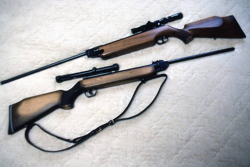

It may come as no surprise the the "Wischo" (BSF) 55n was my first 'adult' airgun: from ARH in 1971. I still have it, and I'd estimate 60,000+ shots fired over those years (I even wore through the original cocking arm-first and only time that's ever happened to me). Mine did have a habit of breaking mainsprings (maybe 4 or 5) and I had trouble with the scope (a Bushnell "Scopechief" model ARH also sold-I think the scope cost $17 at the time) staying together (the front lens shattered twice).
Like the typical 'power obsessed' kid at the time, I picked the 55n over the slightly costlier HW35 because the velocity spec for the 55n was around 750 fps vs the HW35's 710 fps. Eventually, I ended up buying a HW35 L also, but I really liked the smaller/lighter 55n for 'field activities'. When ARH went out business, I bought a Wischo 70 stock (larger, but plainer [not walnut; beech I think]) for it, but eventually put the original 55n stock back on as I like its look better.
Eventually, I had enough of the broken springs and the leather piston seal kept folding down over the piston (I may have over-lubed the leather, making it too soft) and the gun sat with a broken spring for 20 years. A few years ago, I found and installed a Jim Maccari/ARH mainspring and purchased a leather piston seal replacement kit from Vortek (26mm dia. "Vac-seal"; can't recall if I had to sand it to fit) and the old 55n is going again (though for some reason, it won't quite make original 'power' levels). The only other re-current problem was the trigger return spring breaking (looks like a safety pin; in fact the last time it broke, I fashioned a replacement from a safety pin and that one's lasted longer than any of the factory replacements I put in!).
ARH's ARM Volume 17 ("55n Handbook") gave me the knowledge to take the gun apart, though as a light-weight kid, the "lean down on it" method to release mainspring pressure outlined on pg. 30 (no spring compressor) in that magazine was not optimum to say the least. The other instructions I did not care for (page 31) was to pound out the pin securing the cocking arm to remove it for piston access (much less harmful to remove the barrel pivot bolt-no pounding with hammer required!). That same information is given in the similar ARM 18 ("The Weihrauch Handbook"), and later in the ARH "Complete FWB Sporter Owner Manual 12/124/120 Series" though at least ARM 18 does mention removal of the pivot bolt as an alternative to pounding out the pin. The factory mainspring is quite stiff (I still have a new/un-used one that's at least 45 years old): the Maccari spring is much easier to install, and the velocities with it are only around 40 fps less (with much smoother firing sequence) than the OEM spring. The last time I had to replace the breech seal, I made one out of a piece of stiff rubber ("Tygon"?) tubing and that's worked fine since (a difficulty with the 55n's breech seal is that the slot it fits in is not of uniform depth (being significantly deeper at the top side than the bottom). Anyway, it's as fun to shoot as those old ARM magazines are to read? Enjoy yours! Photo is my 55n (with the Model 70 stock and the $17 Bushnell scope) the the HW35 I got some years later.
