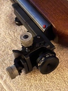

Balanced, light weight, extremely accurate to 60 yards, easy to cock and you can shoot it all day, excellent trigger and dovetail rail for a Williams Peep sight.
There are two models of the Williams Peep, you want the one designed for air rifles, the PB one is to low to see properly with MOST air rifle stock combs. And the extreme ballistic curve of pellets.

As for Williams peep sights, the ordinary common williams peep is yes not a good option for most springers. You cannot get your eye down far enough to use it, at least not without unusual effort leading to inaccurate shooting. However Williams makes various peep sights and the model for high line of sight air rifles is the FP-GR-TK. Hard to find and not stocked by most stores. Not cheap either, it was around 70 bucks most likely now close to 100 bucks.

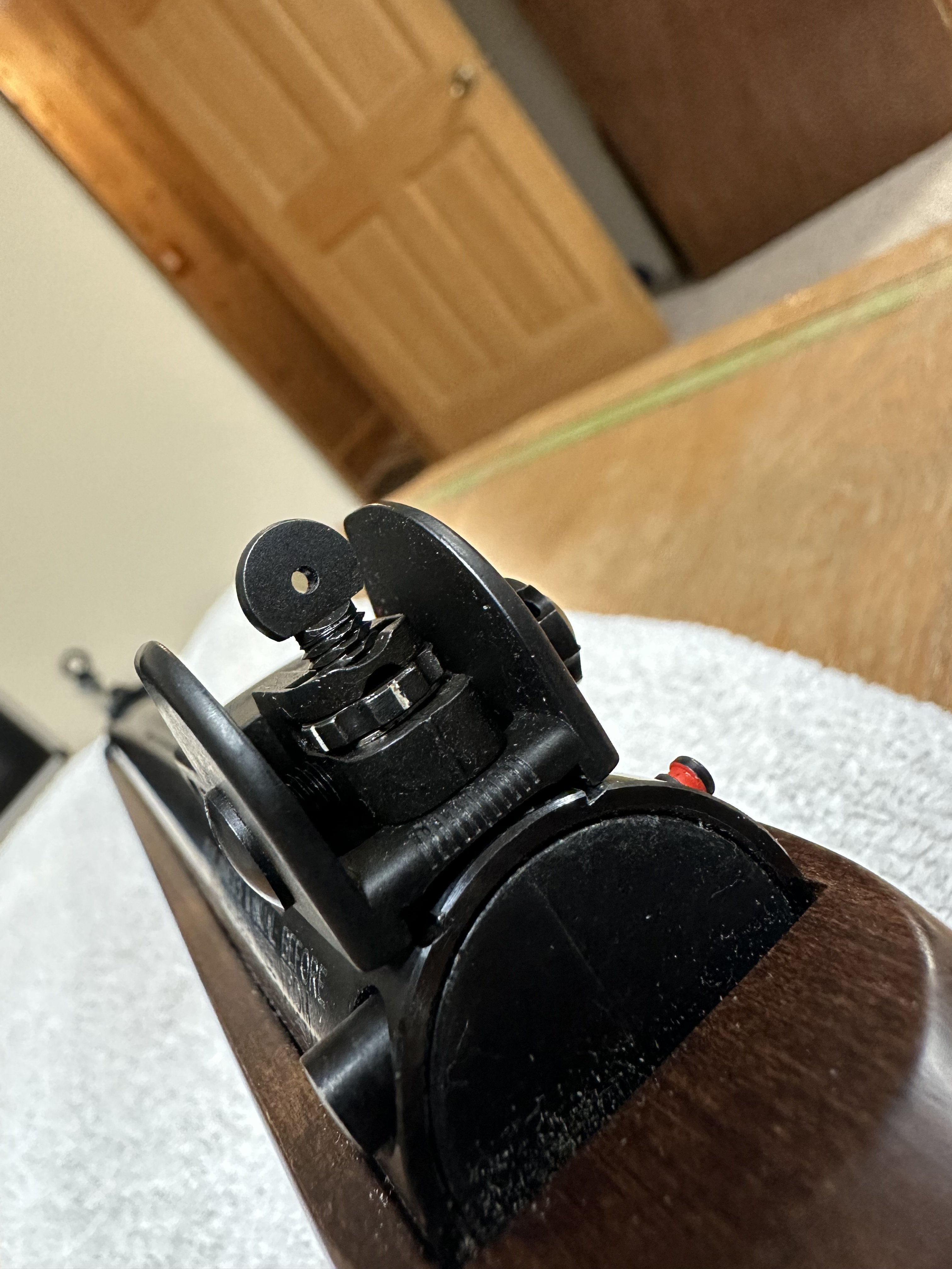

The comb is too high for me to see the sights right on my HW95L. Mine is an earlier stock. Anyone else notice that? A guy had a newer one with a Williams peep sight at a shoot I attended and you had to squish your face to use it. Not comfortable. He didn't like it either. Same thing as mine.
The standard stock seems to be ok.
The standard sights work fine for me but with a Williams peep I had to damn near put the stock on top of my shoulder to get a good sight picture.

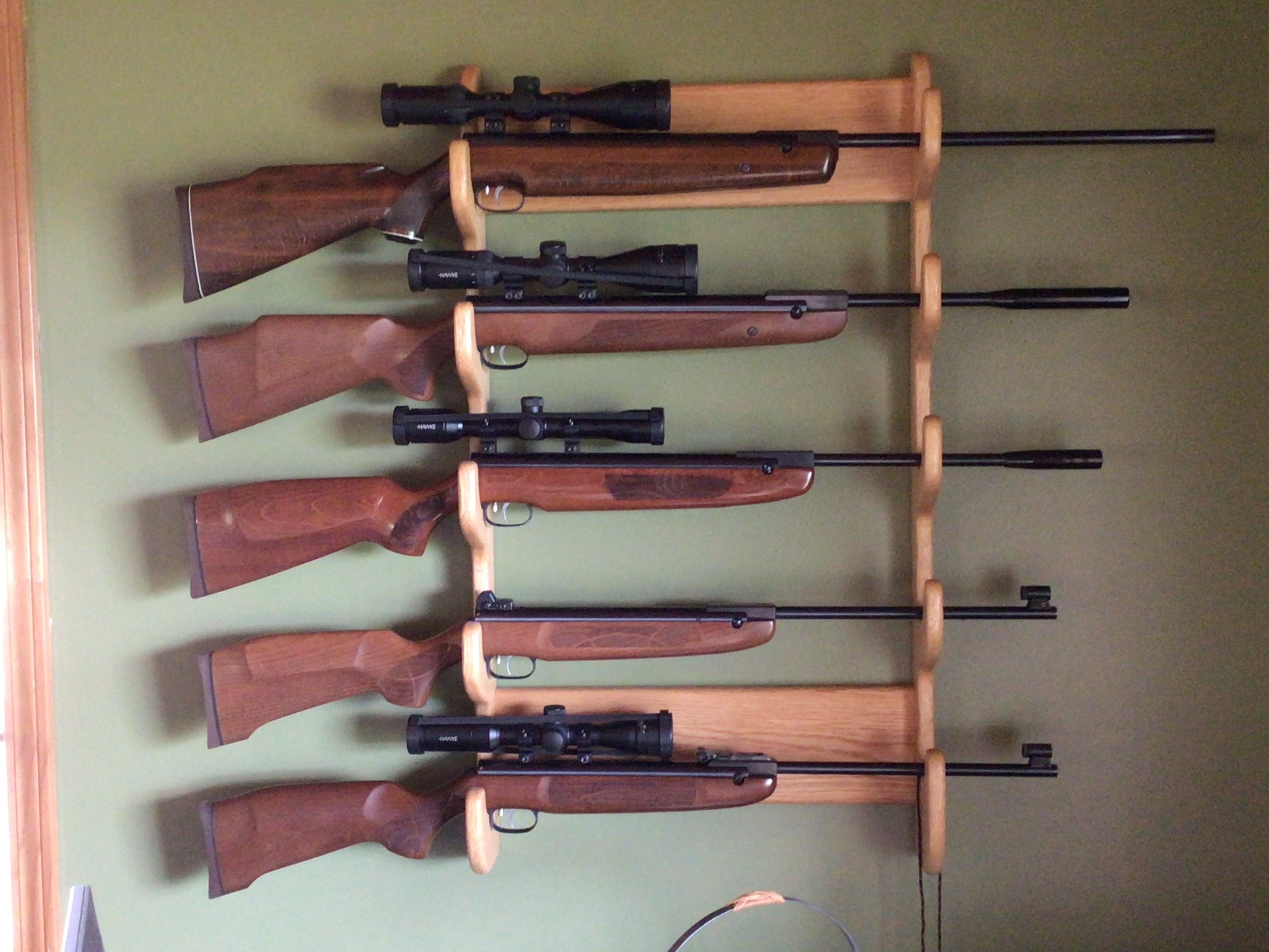

The Hw30s are my favorite rifles. I've got three of them if you include my wife's. Two of them are scoped. The third has peep sights. All of them are 177, stupid accurate and can easily be cocked all day. The guns are smallish and a little tail heavy but I still shoot them offhand as good as anything else I own.
The HW95 family guns are big full sized rifles that I don't enjoy shooting offhand. I shoot them benched. I own four of them in three calibers.
The gun that I like the balance and fit the best is my 177 HW50. It's smaller than the 95 and almost two pounds lighter. Out of all my HWs the 50 shoulders and points the best for me . It's not fun to cock all day though. If you reduce the power, cocking will get easier and the accuracy should improve. A 10 FPE HW50 would fit your needs well.

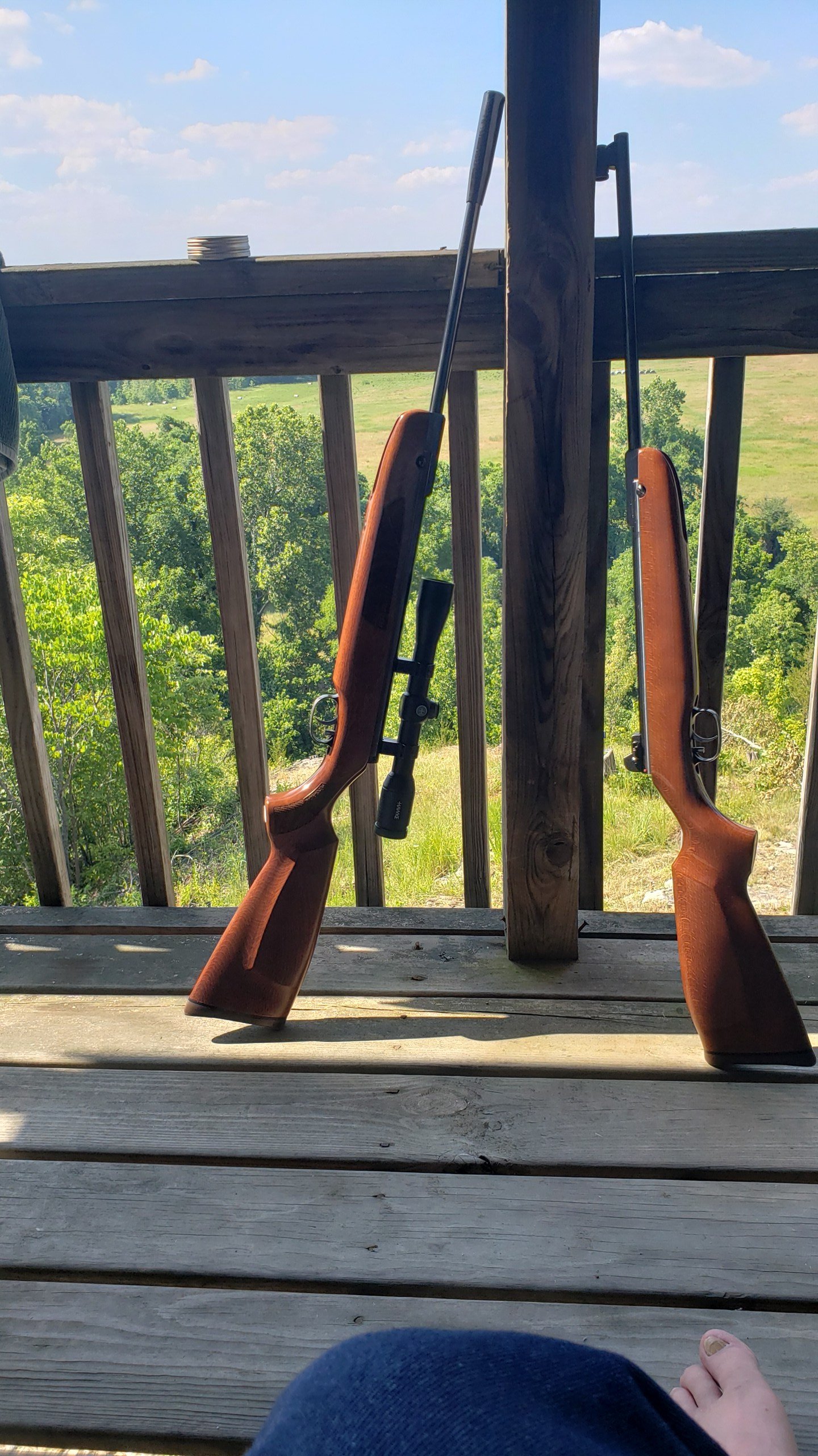

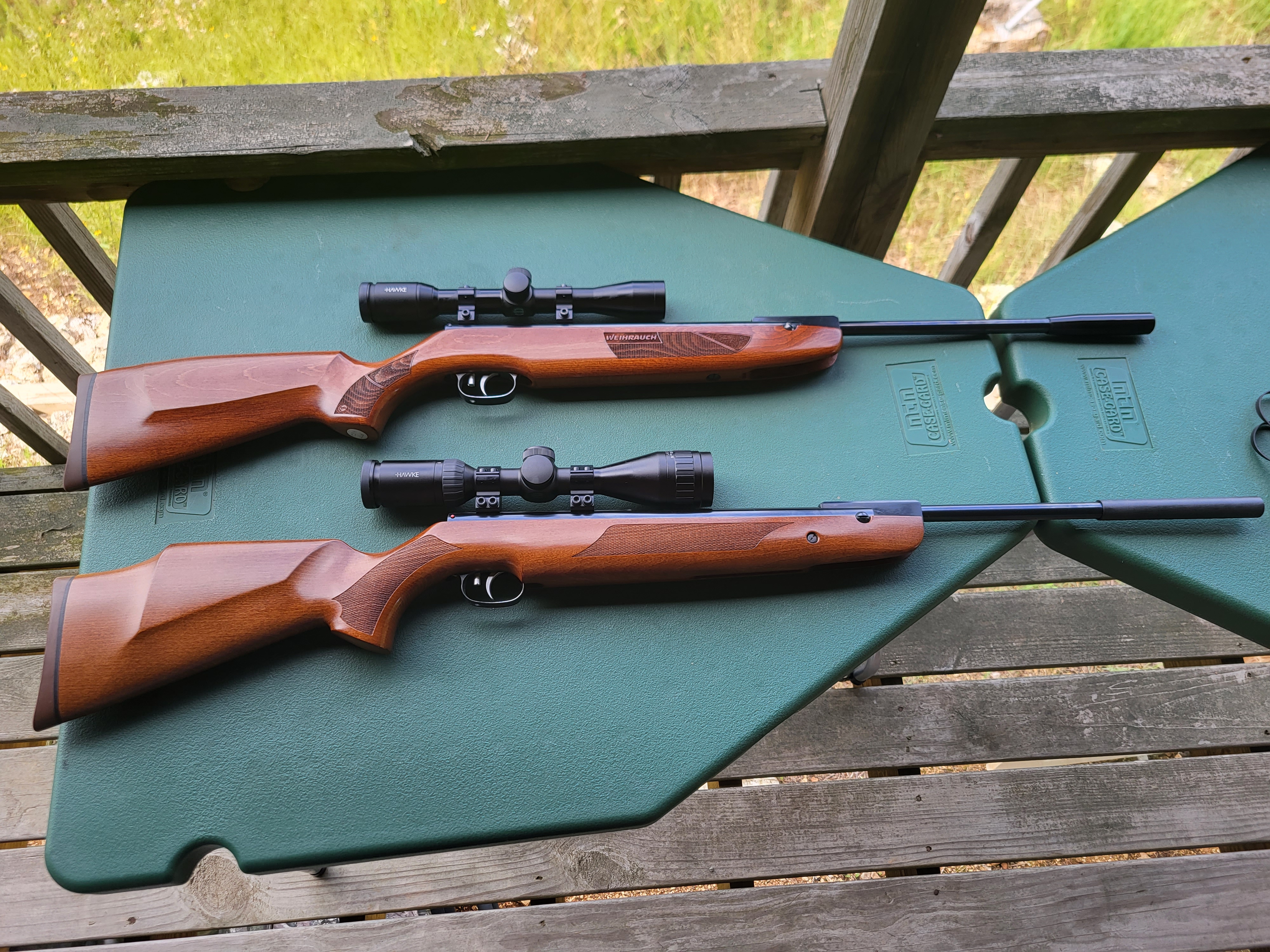

50 on the left. 30 on the right.
50 on the top. 95 on the bottom.
Sometimes it wears this, and sometimes it wears that.
Oh and there’s a Hawke 2-7 that can be found on it too.
It’s my do everything rifle. A 7.33 dome is deadly inside 30 yards.
