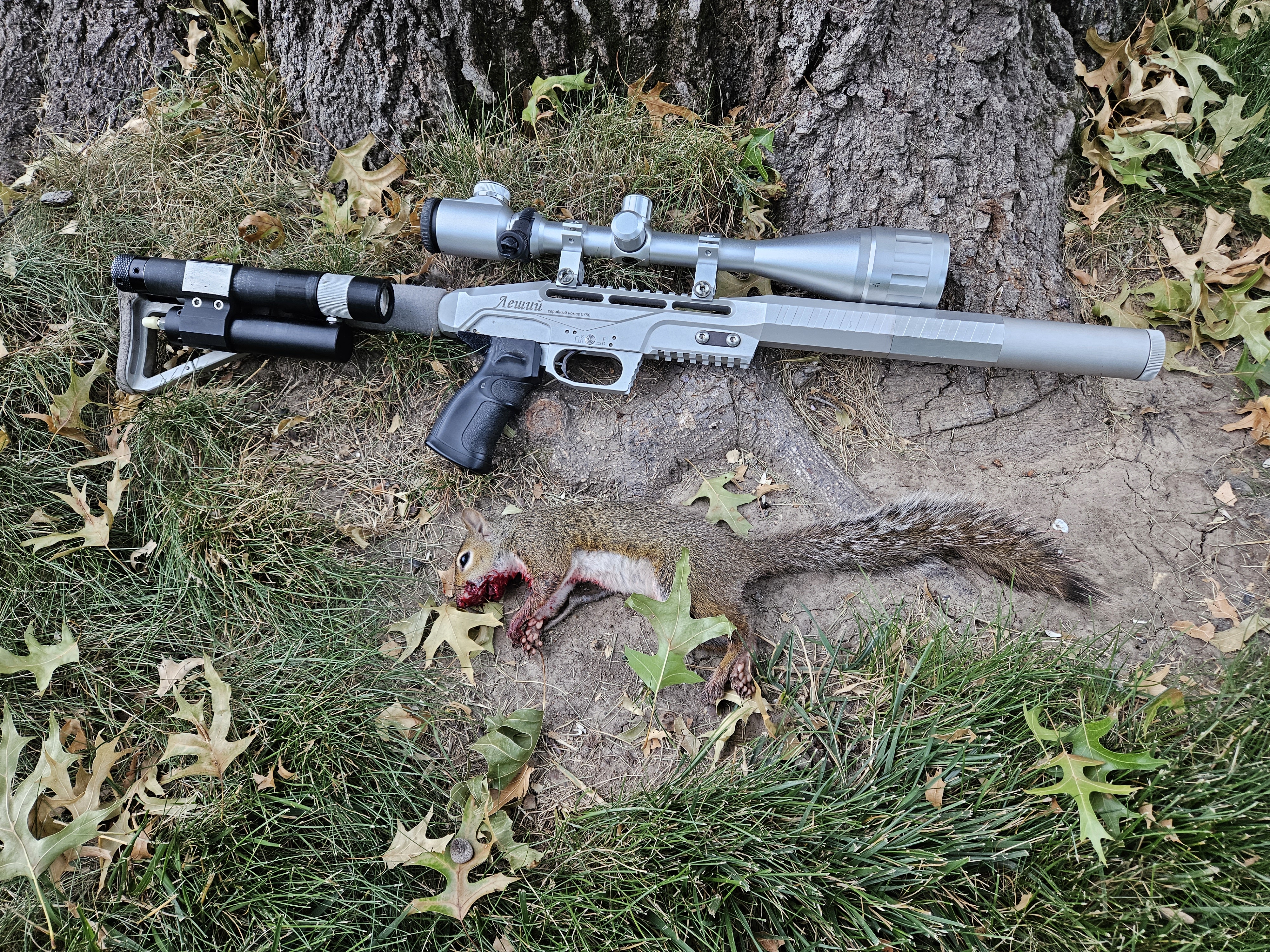

Well I bloody the custom Leshiy Classic 9mm this evening shooting 77.62gr JSB at 650fps about 30 feet up a pin oak off my patio the pellet hitting him was louder than the gun firing.
That's a double air tube that my friend Rodney added too give you more air, one came from Europe and the other one was made by John Hagan in Illinois if I remember correctly, Rodney built this Leshiy 9mm from a 25cal he got the barrel from a guy in Europe he turned it on his lathe to fit added a power valve and extended the shroud and baffle to make it quieter.
Does that Leshiy have an extension to the octagonal section of the shroud as well as the cylindrical extension? If so, what's the story there? I assume the same friend did that? Did he also make modifications for the grip?
I'm on my phone & do not have my glasses so might be seeing things.
Yes he extended the octagonal section I don't remember where he said he got it but he bought the gun from the Edgun guy in Spain when they first came on the market. I believe he did something with the grip.
