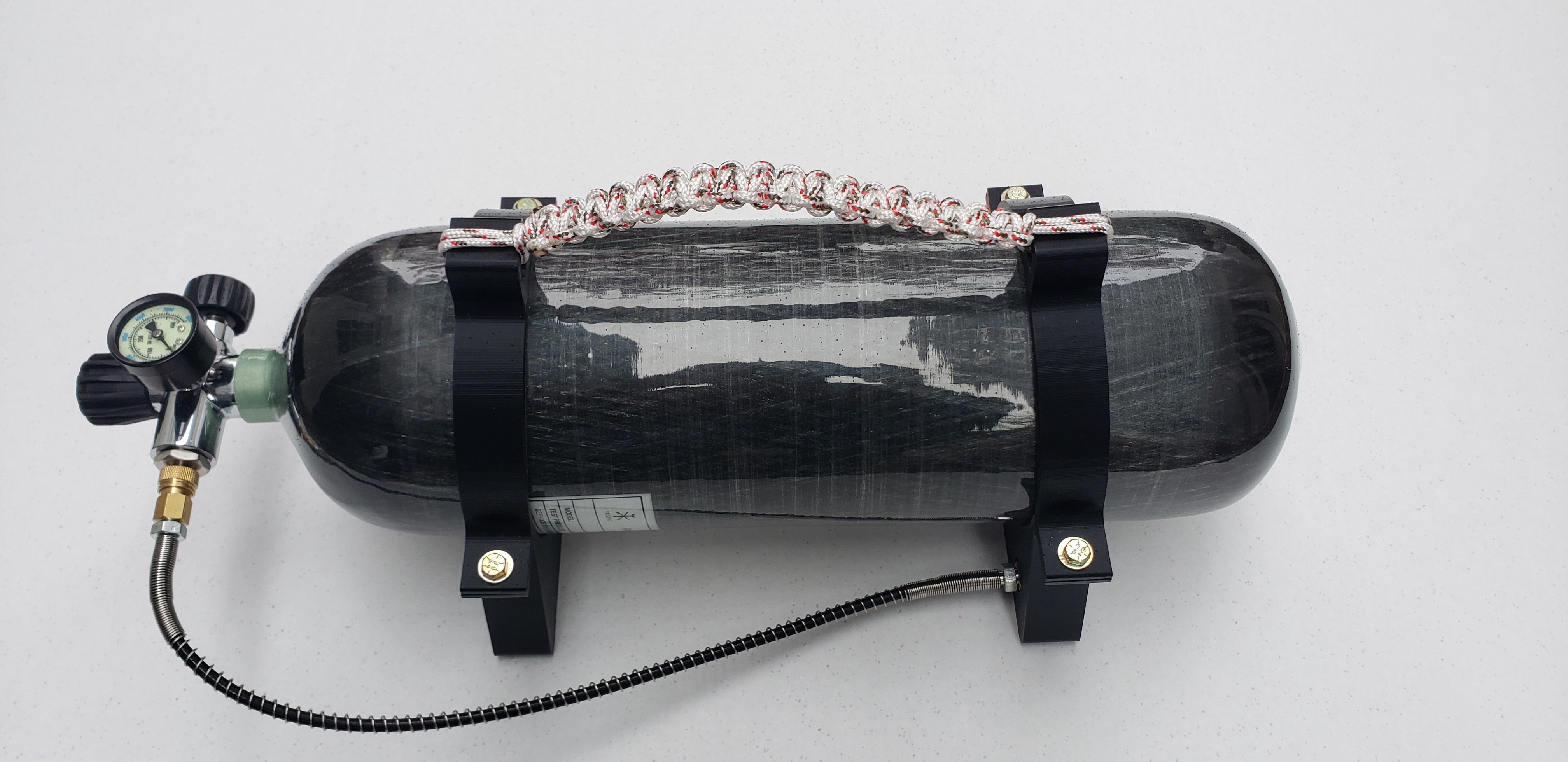

Hello again! I ended up going with the Tuxing 6.8L tank and I'm very happy with it. The seller messed up and shipped the tank without the valve and the hose and that was annoying because I had to wait another week to use the tank.
Have filled my gun with it a bunch of times and absolutely love it.

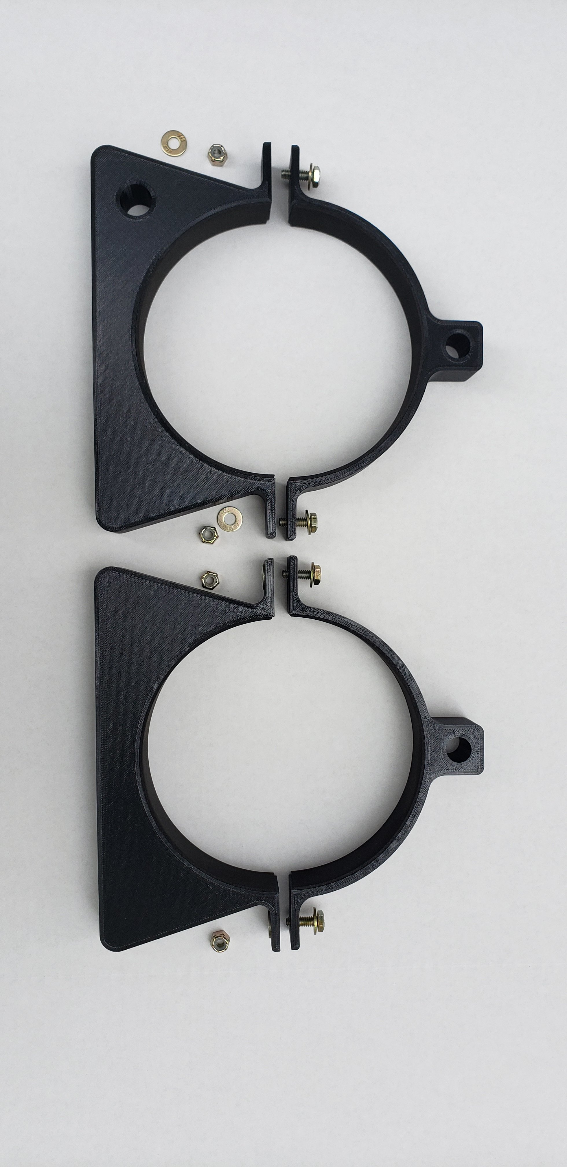

Quickly learned that I need an easier way to carry the tank and to keep it protected and from rolling. I have a 3D printer so I designed and printed "feet" with foam padding on the inside and with a hole to hold the hose in place, and I made a paracord handle. Works quite well!
