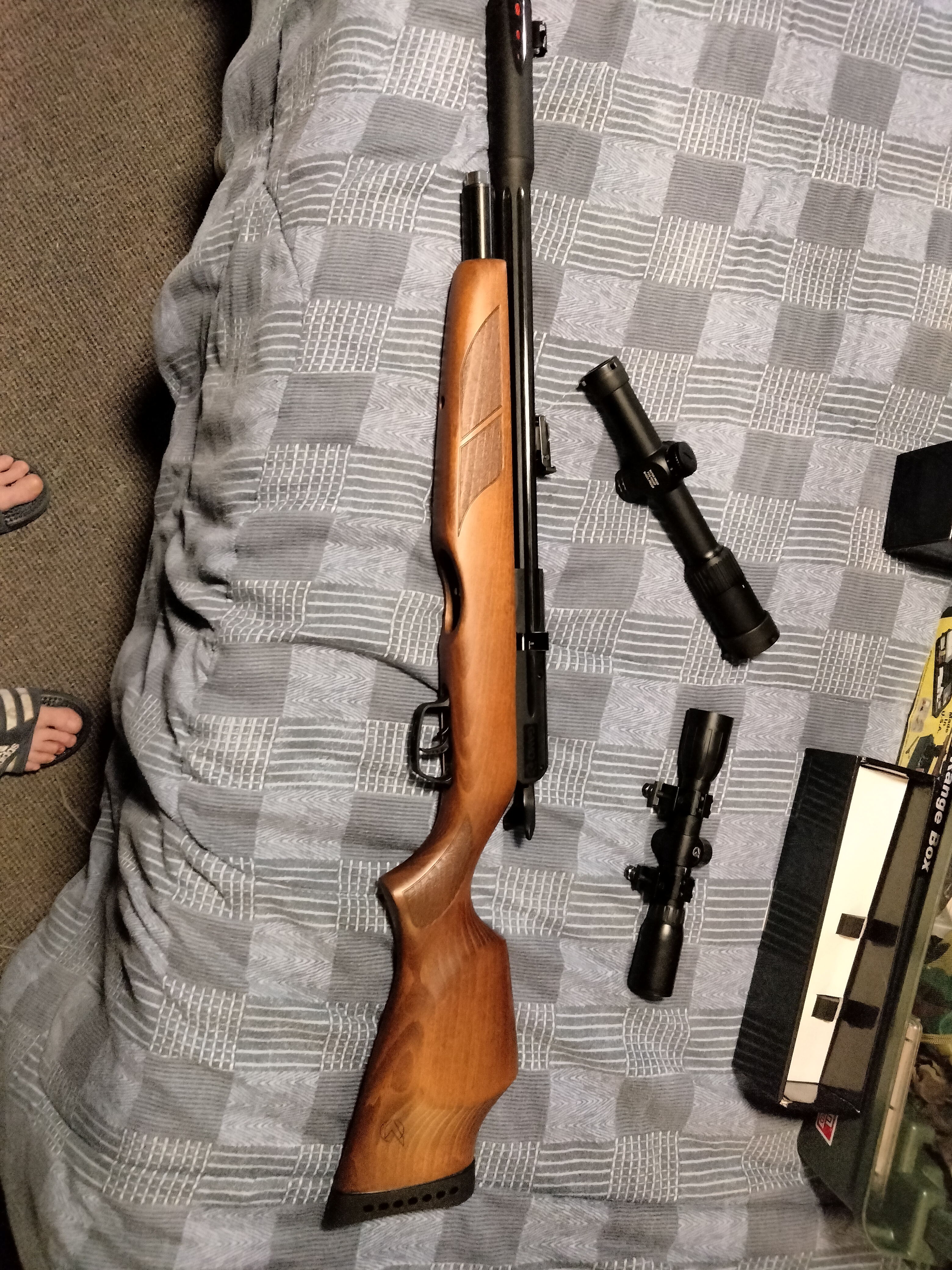

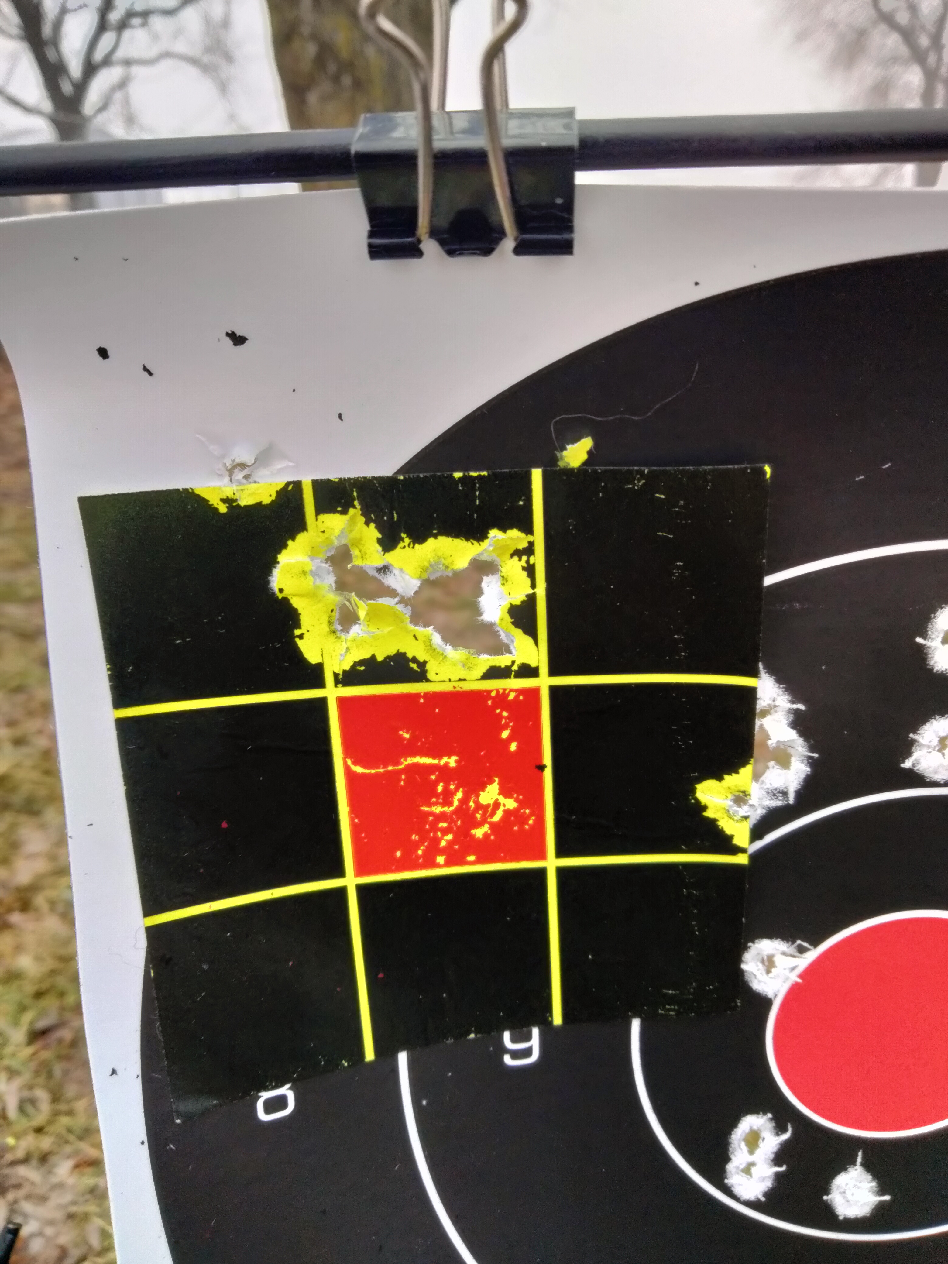

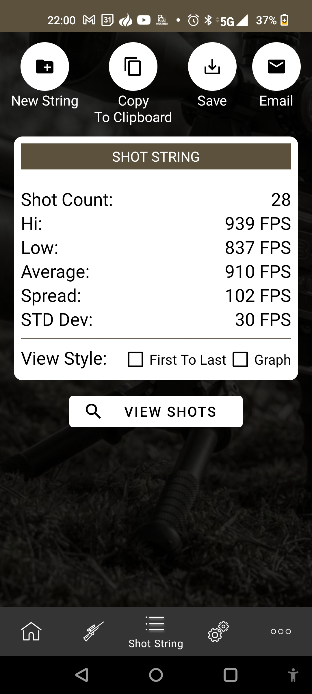

Hey everyone I've been watching the reviews on the Gamo arrows for a while and finally decided to crack the wallet and get one. Got it in the other day and put a few rounds of it this afternoon. This was just with the fiber optic open sights at 20 yards. I'm pretty impressed. Not bad for almost dusk and shooting from the inside of a dark shed. Although my shot count doesn't show it I got probably a full five magazines out of it. And it still had some air in the tube. I got to say I was a little surprised with the blistering speeds this thing was shooting 14.3 grain CPHPs. And I'm pretty happy with the little group at 20 yards. I'm going to throw a scope on it and do a head-to-head accuracy testing with it and my Notos soon.

I've noticed Gamo is advertising the .22 Arrow with the wood stock as being able to shoot up to 1,200 fps (alloy pellets), 29.5 fpe, and 40 shots between fills, but the .22 Arrow with the polymer stock as only being able to shoot up to 900 fps, 17 fpe, and 60 shots between fills. I've messaged Gamo and asked if the internals are different between them or if they're the same but the wood stock Arrow is just tuned to the highest power setting. Not surprisingly, they haven't responded to my question. I have read that it is possible to adjust the power level on the Arrow in the same manner as the Gamo Urban is adjusted, so I'm going to do a little experimenting this weekend with some 14.3 CPHPs, my chronograph and a 4mm allen key.
I'll report back with my findings.

I thought the different specs listed for the wood stock Arrow vs the polymer stock Arrow on the Gamo website was a misprint, but your chrono results would indicate the wood stock Arrow is indeed considerably more powerful than the polymer version. More power and wood stock for only $10 more?!?! Seems like a no-brainer to me!

1) My backyard is only 30 yards at it's maximum distance, so my Arrow is more accurate than I need it to be. The splatter target was 25 yards away and I was getting consistent 1/4" or smaller groups.
