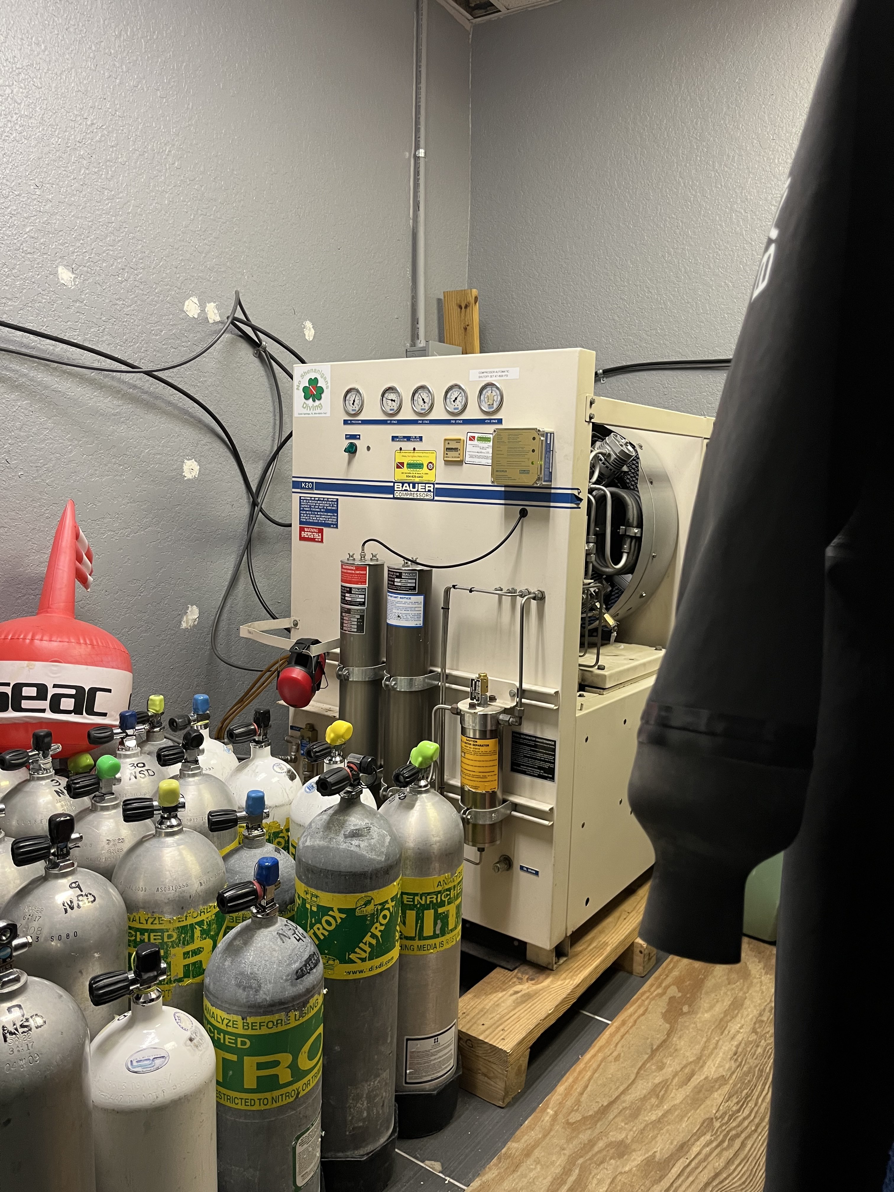

The absolute best compressor is the one that somebody else owns and maintains. Because they can be quite frustrating and costly. Most people will have a dive shop, paintball shop, fire station, etc within a reasonable driving distance of them that they can pay to get a fill-up. A bonus is that these places will assuredly provide the highest level of clean and dry air...something quite hard to do at home with cheaper compressors unless shelling out quite a bit more money, and also requiring even more maintenance. So my advice to most people getting into PCPs is to invest in a quality tank that can be filled and will last for many years with zero maintenance before testing is needed to maintain compliance.
I understand not everyone will have such a fill station within driving distance, but you might be surprised if you take the time to search. I live in a rural area and have no less than three fill stations within 45 minutes of my house, one as close as 20 mins. $10 to fill my 60 minute SCBA. And then I get to simply walk away with my clean 4500lb air while somebody else gets to worry about the maintenance. Nothing comes close to beating that cost of compressed air. I would still use this method even if it were a three hour drive. I would probably just buy an extra tank.

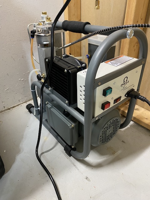

I agree, this is the one I have. It’s not super fast but is built very well. It operates with one piston and a large lower RPM motor, and it is quite enough that I don’t need hearing protection when it operates.
Another vote for the Omega Air Charger. I have had mine for five years now. Great compressor.
This unit was fast to fill a bottle.
My 10 minute away dive shops gear.
