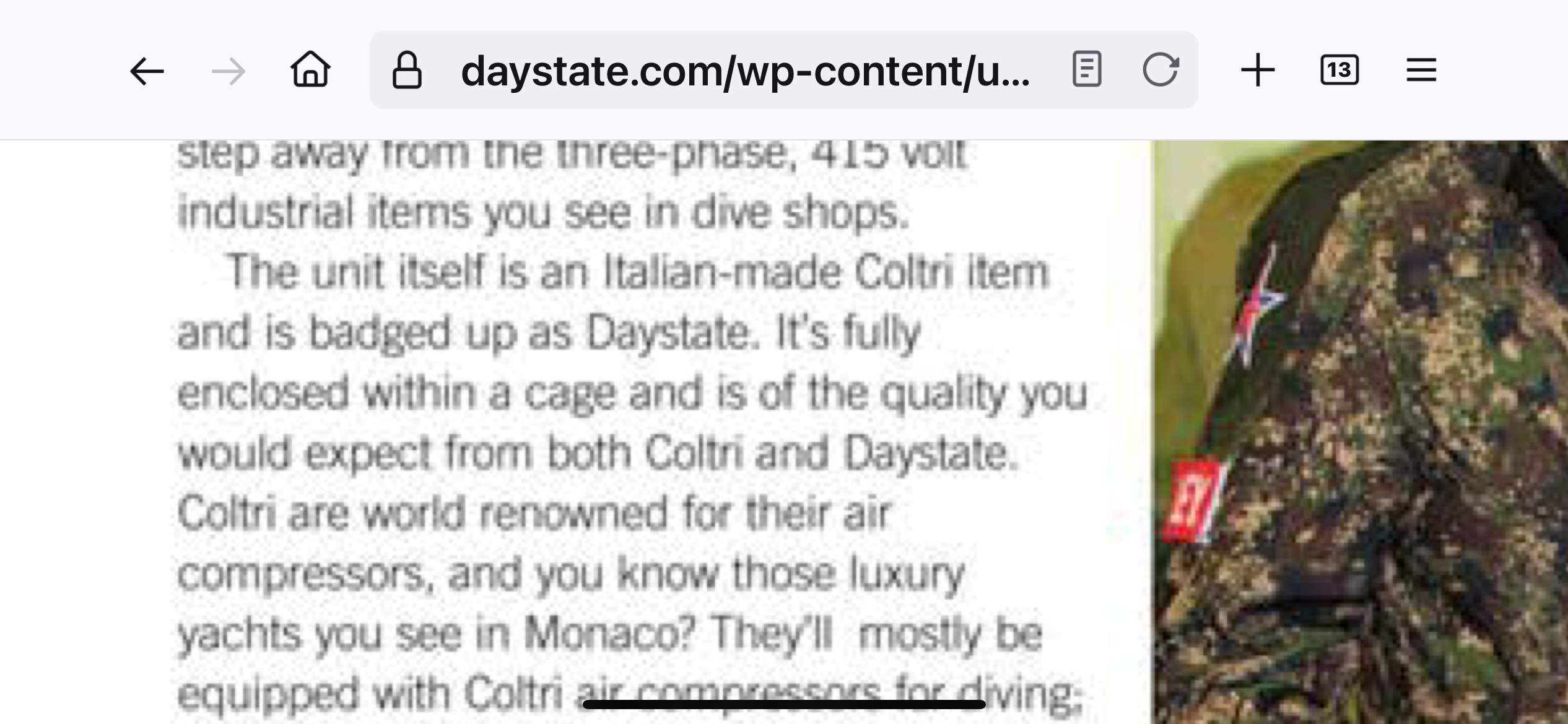

The Daystate is built by Coltri in Italy
If you believe that, I have a bridge to sell you. On another note, this device looks simple. It is not. It is quite complex with many parts. Hence the high cost. I bought one and it really is easy to use and it definitely saves air.. However mine broke the actuating pin under the lever. I have ordered another one as a replacement. We will see. I am editing this to reflect the subject, which is the Easy Fill adapter, like the EDgun and Daystate offering. The Florida man comment states the device is actually made by Coltri in Italy. It is not. They are all made in China and sold under different brand names. I really like the design and it functions really well, when it is working, but I fear the quality is less than ideal. and actually rather frail. I will disassemble the new one for dimensions and make new parts as required out of better material.
He is correct. Made by Coltri.
Just what I have read.
