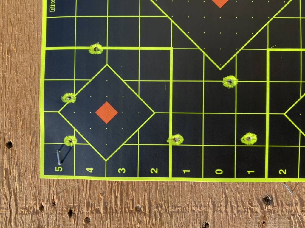

First time shooting at 200 yards, at least I got on paper =P
Have to do a lot of work this weekend, but because of that I ditched work 4 hours and went shooting. Finally made it to the 300 yard range and popped up targets at 200 yards. Ran out of elevation by about 1 Mil at 200 yards but that’s expected, with the 20MOA rails I got 11 mils of elevation shooting 23 grain .22 NSA @900fps with my crown.
wind is always a pain at the range because of it likes to just swirl and switch directions constantly. I got a shinny strip of plastic as wind flag and it never stay consistent for more than a couple of seconds…..that’s my excuse and I’m sticking to it. At the end of the day I’m happy that I got in paper with the darn wind!

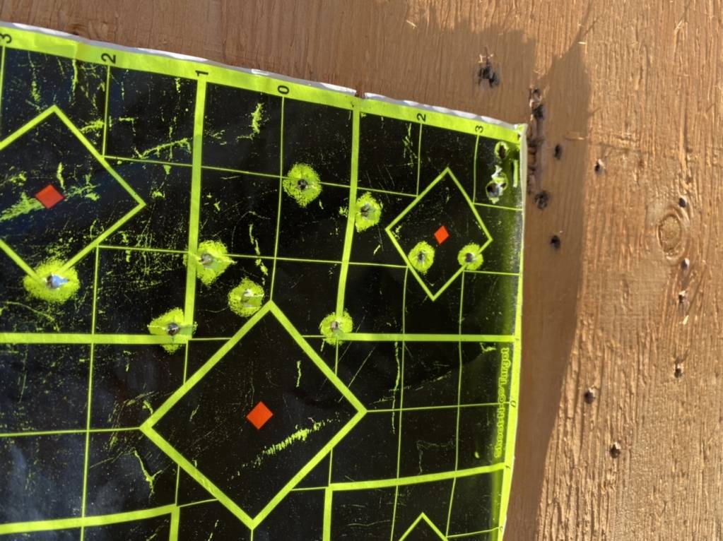

Most groups are about 5-6 inches

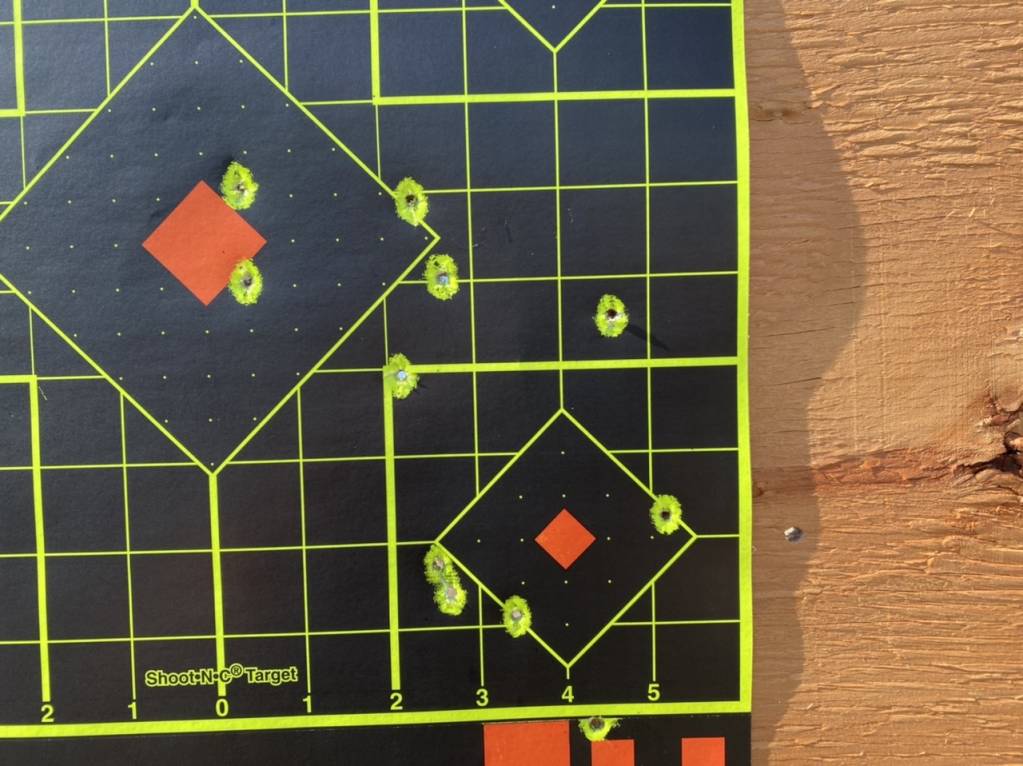

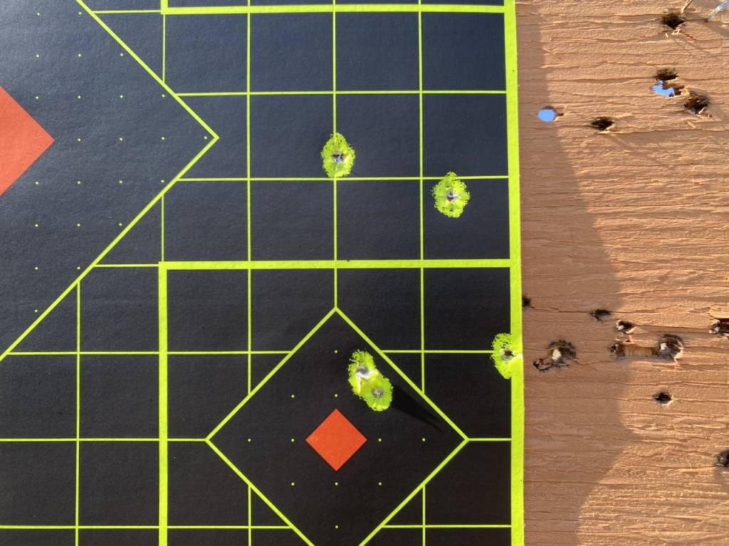

this is best group of the day and it’s about 4 inches. Double up on one shot by luck and it’s actually a 6 shot group, you can see the new/clean hole just off the paper top right of the group.

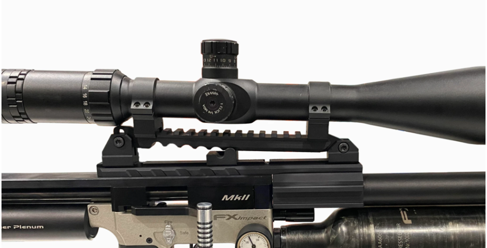

Hey Qball, Mike and others of course! Lol...I have this bad boy coming over from your motherland. KRAFORD & LYPT Fixed MOA points...Very very cool concept! extra 150 MOA!

Oh that's cool!!! Sadly it won't fit on a crown but tempting for my impact. My only hesitance is I already have a scope that has a lot of internal elevation adjustment. With 20MOA mount I have 80MOA travel or 23 mils, according to strelok I only need 20.8 mils at 300 yards. Obviously will see if that works out at all but definitely will keep that rail in the back pocket. I was thinking about an adjustable base in case I can't get to 300 yards with my scope.
