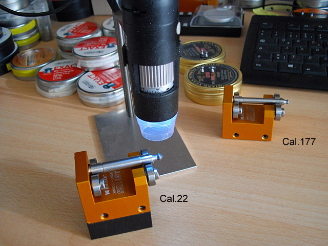

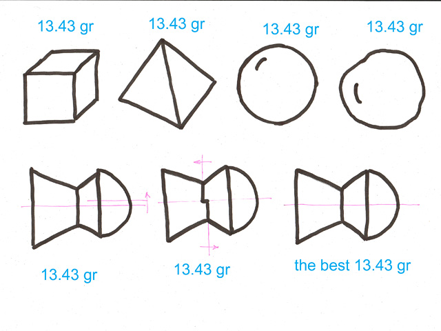

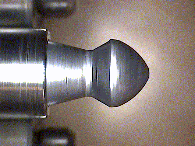

I keep having questions about what I use to check the symmetry of the pellets.
A few years ago I developed a device to check the concentricity of the Hollo era. But only for Cal.177 pellets. It's fine for flat head match pellets as well. However, this test device is not so suitable for 25 meter bench rest shooters. The round head pellets often do not have the high quality of the premium flat head pellets.
In Europe, Cal.177 pellets are mainly used for shooting.
Some time ago I changed the pellet tester and made an additional test bolt for Cal.22. I have already done several tests with Cal.177 on 25m benchrest. I'm confident that the Cal.22 tests will also go well.
Fortunately, every pellet manufacturer always makes the same mistakes. Depending on the batch, sometimes more sometimes less.

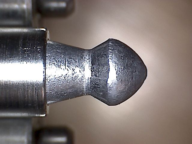

As an example H&N Baracuda Cal.22
For example, look at the wobbling of the front cone.
My Equipment

Here's another picture on the subject.

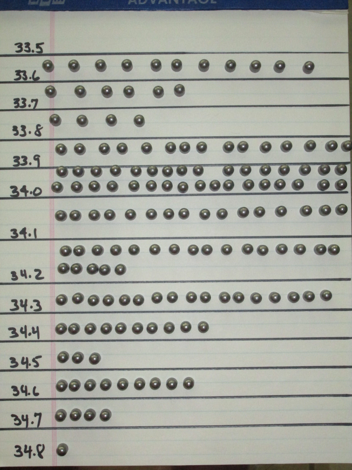

WOW i have sorted a lot of tins and never had a spread like that .
33.5 to 34.5 at 0.05? That looks like a bell curve to me. You've probably never measured them that tight? I don' t believe I've ever owned a scale that could do that, even a reloading scale that could measure 5/100 of a grain reliably... but then I've never owned a digital reloading scale.
Yep, mine does x.xx grains.

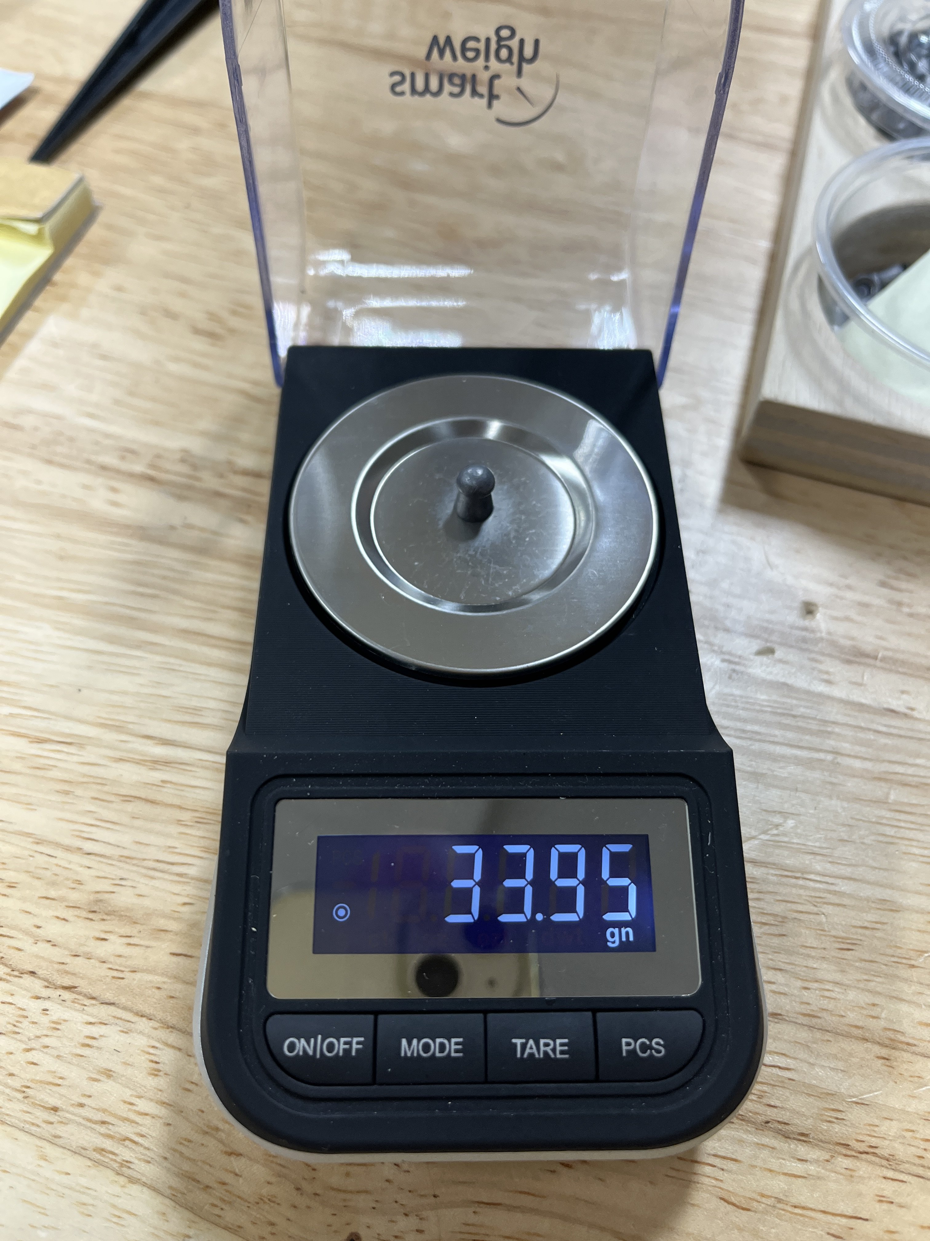

Mike, are you happy with the accuracy of this model scale? The reviews are all over the place because everybody has a different level of need for their applications. Does it work consistently for pellet weighing? The AGA video shows the same scale. Do you weigh in grains or grams to sort?
Yes, I am happy with this scale - if it's good enough for AOA it's good enough for me! I weigh in grains and this scale will go to two decimal places so within one one-hundredth of a grain and it seems to be very consistent. I don't think an expensive scientific scale is necessary for pellets. If you read the opening post you'll see my method of weighing and sorting which gives me batches that are within .05 grains in weight.
I have competed in 25M BR shooting and have played around with pellet sorting. IMO, washing and lubing did not produce any better results. Measuring and sorting head size was more time consuming than I wanted to do, but I could see some benefit to this. Sorting and segregating by weight produced the best results for me. Attached is a photo of some weighed vs unweighed shot at 25 yd from my TM1000. The following photo shows what kind of weight distribution you can get from pellets from the tin. While this is extreme for this caliber (25 I think), you could get as much as at least 0.5 grain difference in .177 cal. I've seen more. So, I shoot my competition targets with pellets of the same, or +/- 0.1 gr.

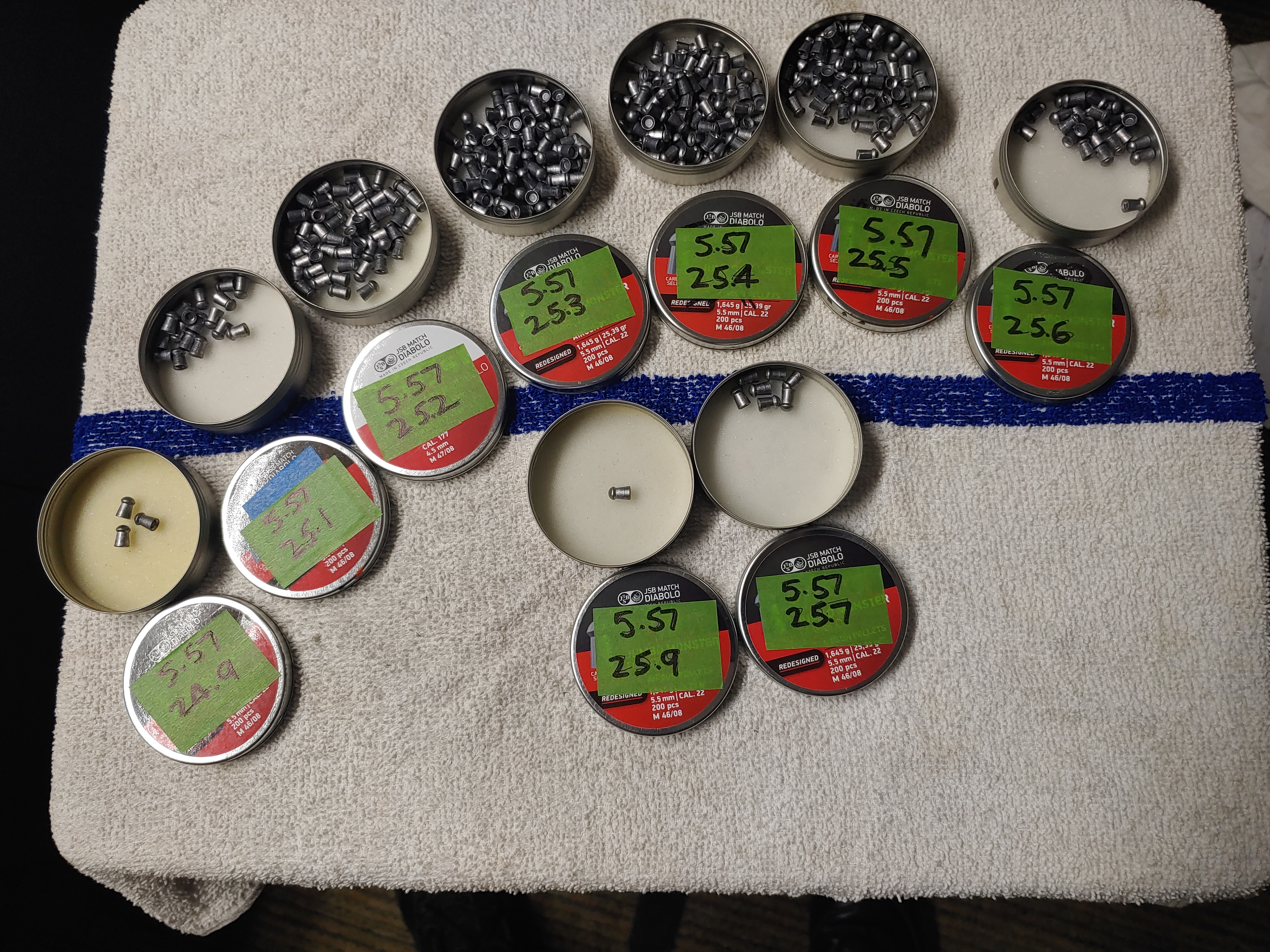

Thanks everyone for the feedback. I'll keep sorting so I have a larger population and also do a little practical testing (shooting) and I'll update as I go along. It's interesting that FX is made by JSB - and FX claims that they require JSB to use only certain dies (or maybe only one die) in order to maintain consistency.
3 tins of FX 25.39. Head size seemed to be a consistent 5.55.
Sorted a couple tins of JSB 25.39 and these 2 tins had a consistent head size of 5.57.
The majority of the pellets fell between 25.2-25.5. From ALL the .22 RDM I have sorted the head sizes in JSB run from 5.52-5.58.The FX branded seem to be either 5.55 or 5.56 head size. I have never found a tin of JSB with 5.52 head size.
