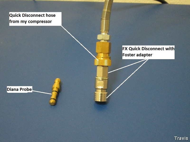

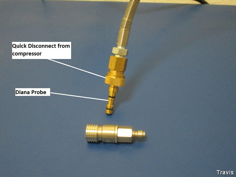

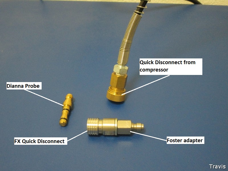

Hello Elblondie,
I had a similar problem because the Quick Disconnect from my compressor would fit the Diana Probe but would not fit the Foster fitting on the FX Crown. Also the Diana Probe would not fit the FX Quick disconnect. I did not want to change any fitting on my rifles so I made this adapter for the FX QD. Now when filling the Diana Rifles I use their Probe, and when I fill the FX I use the adapter with the FX QD.
Hope this will help,
ThomasT
