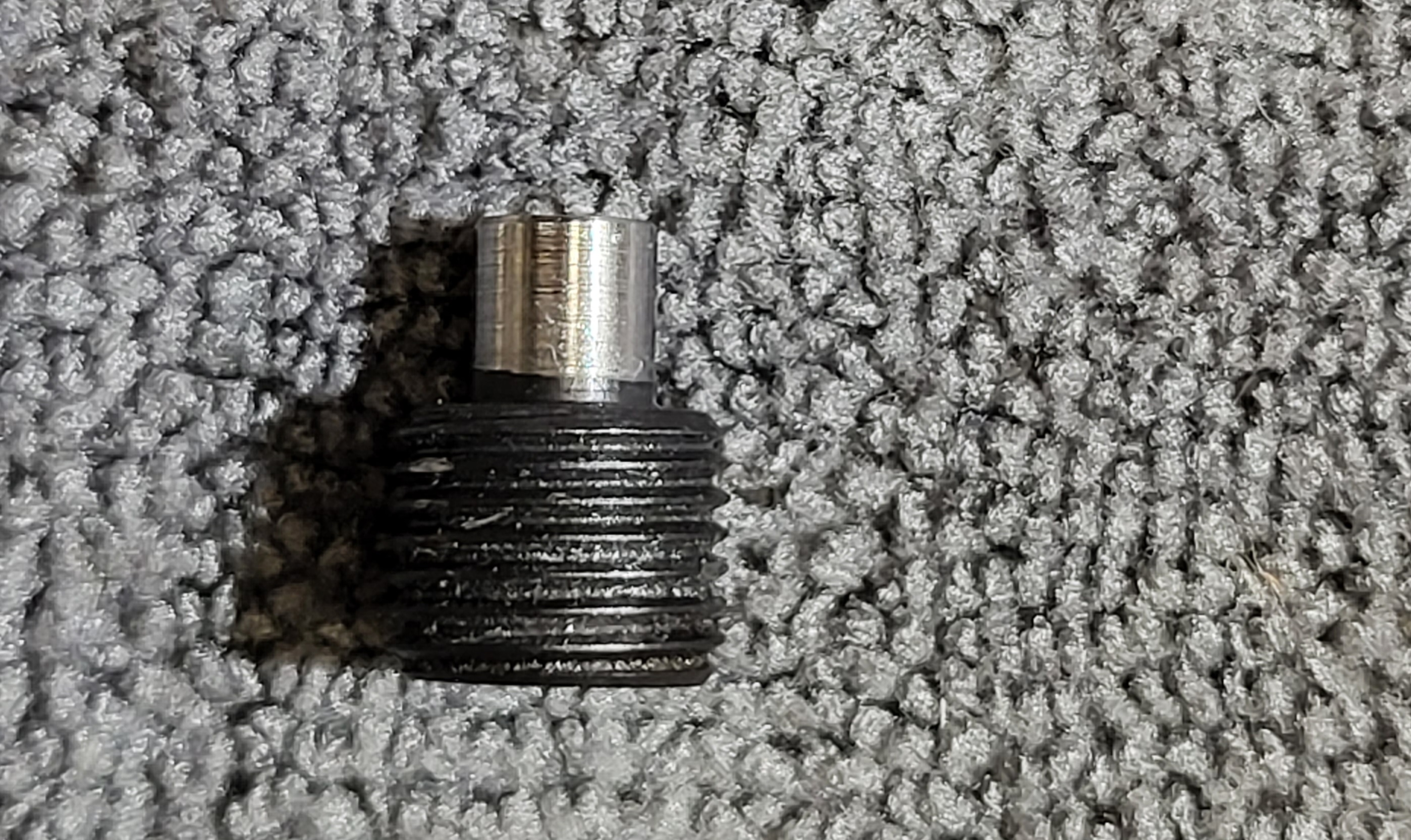

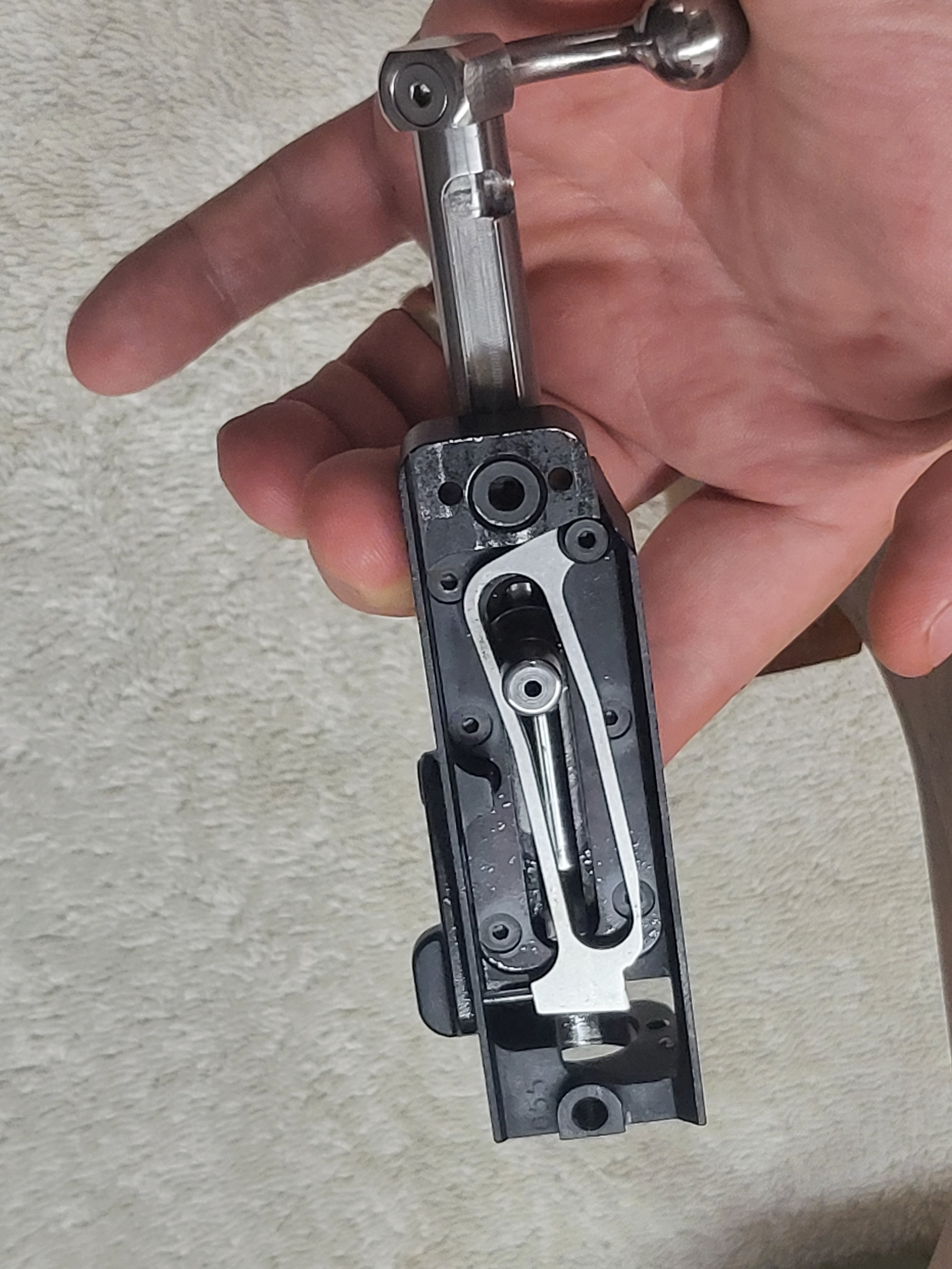

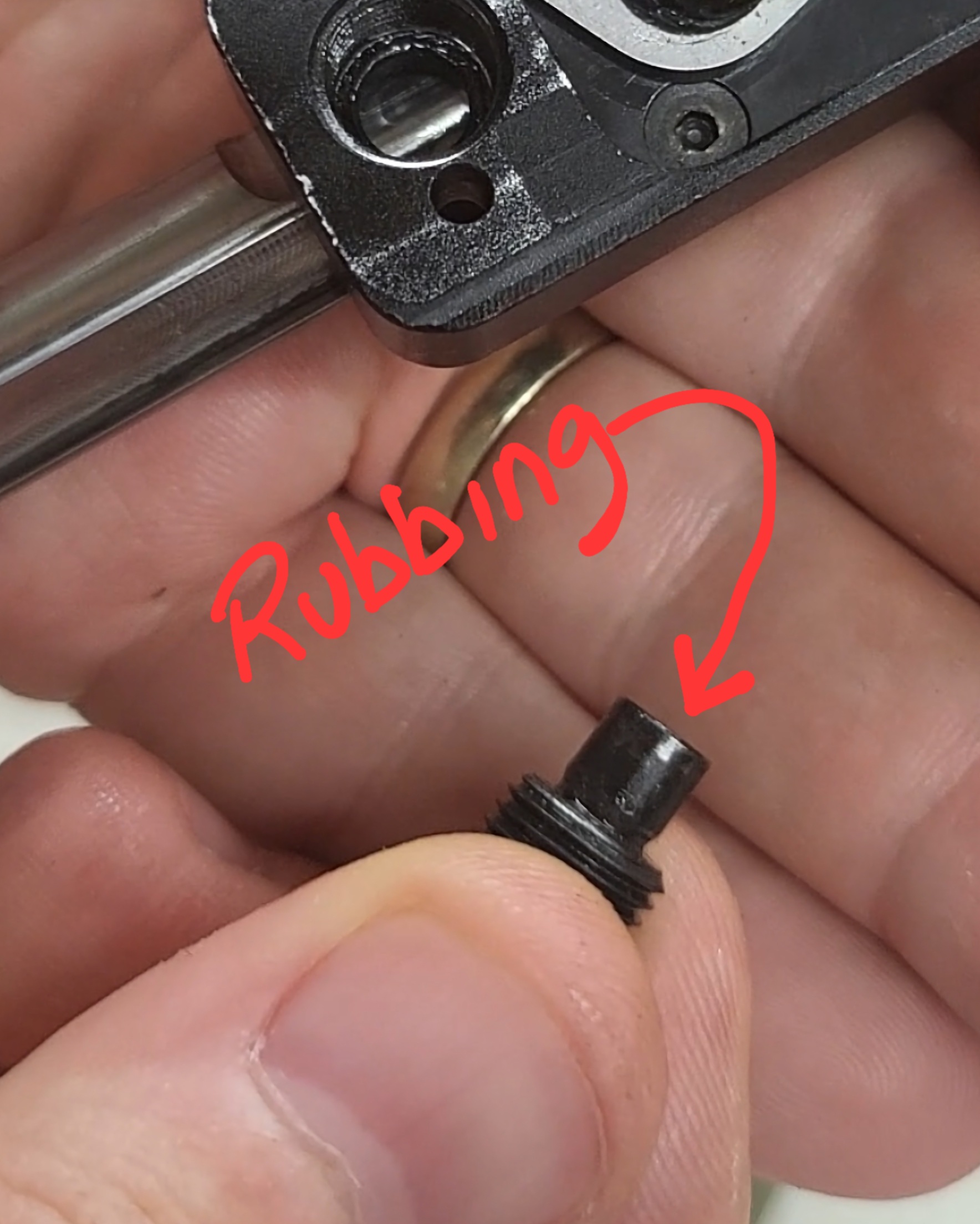

Root cause was the interface of the groove cut into the cocking bolt and the alignment dowel/pin that keeps it properly indexed. See pictures below.
You can see the shiny spot on the black alignment pin where it was scraping the side of the channel cut into the bottom of the bolt.

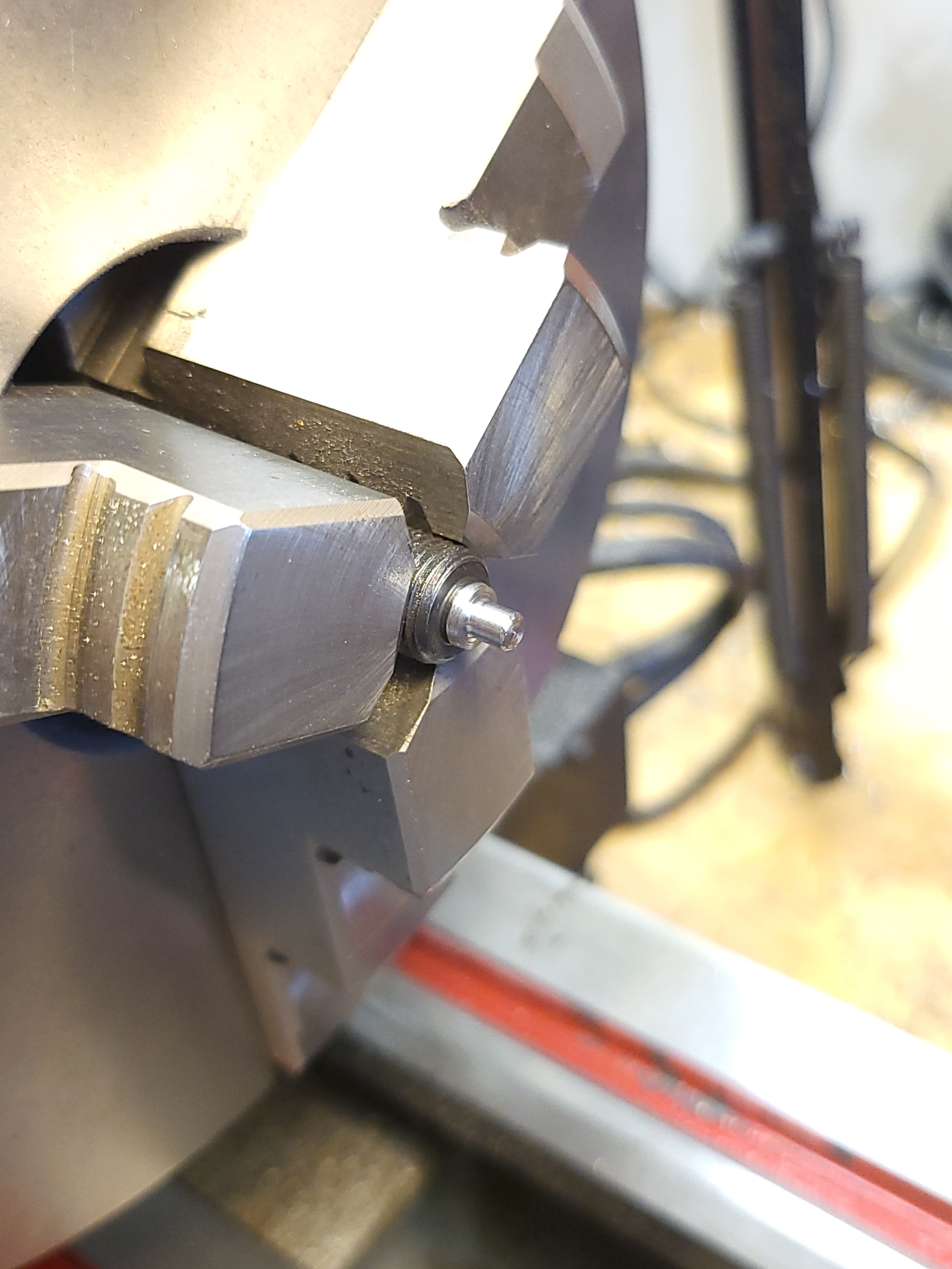

My first attempt was to chuck up the pin in the lath and take .010" off to see if the added clearance would fix it. Unfortunately, no luck. See pic below.

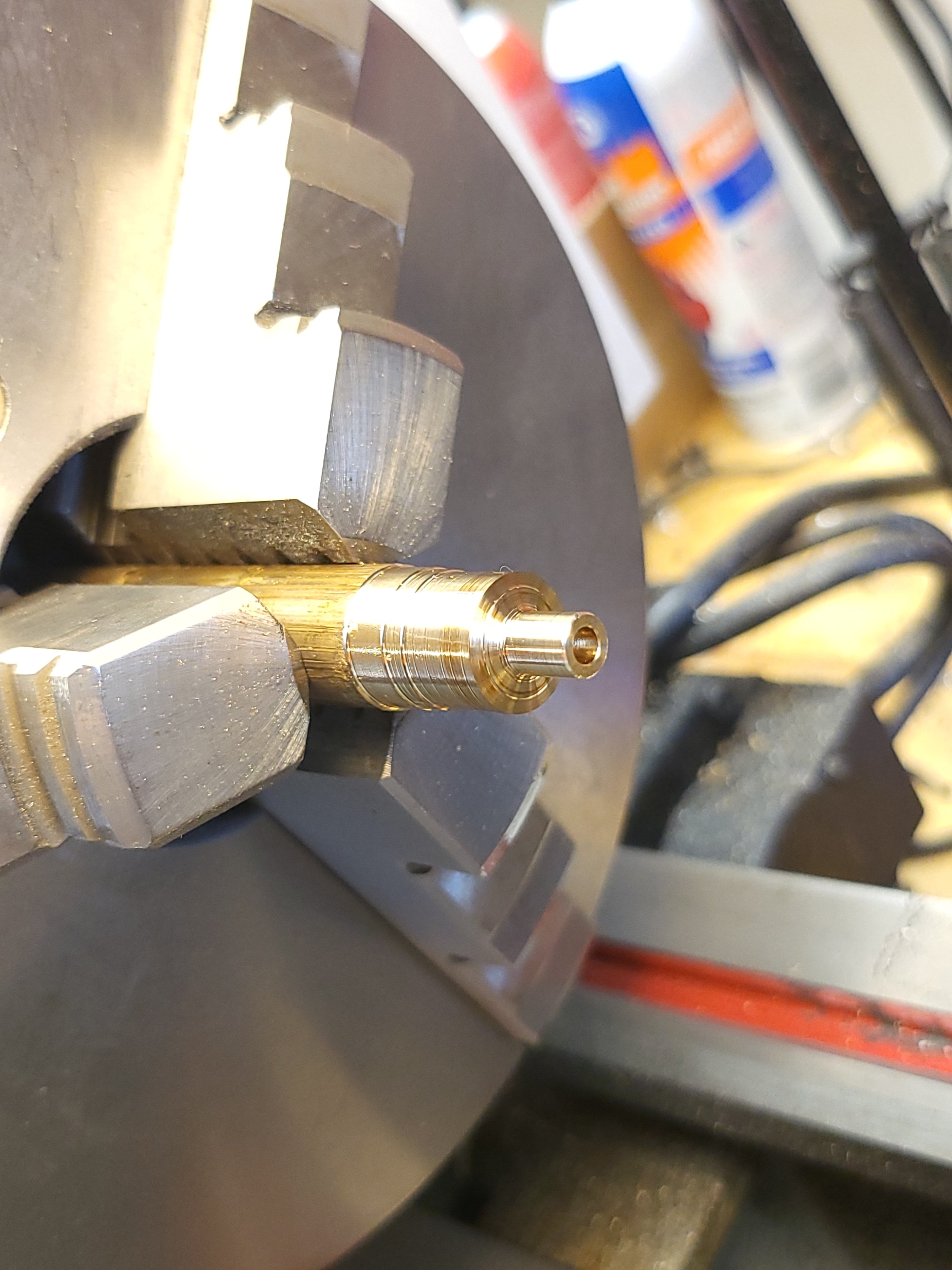

The fix ended up being the modification of the locating pin to add a bushing to it for reduced friction.
I turned down the pin and made a corresponding "aluminum bronze" bushing that ended up having the same OD as the original pin.
This worked like a charm! Operation is very smooth and quiet now. Much better than when it was new actually.
