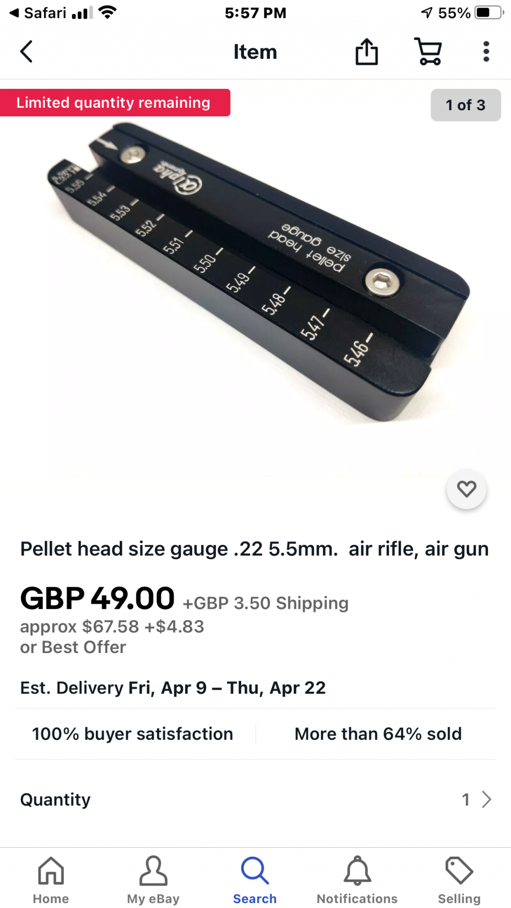

Try to eliminate all variables. I'll be getting a Pellet Gage R system once I see what head size does best in certain ones. I'm more particular about my springers but head size matters in everything. You can weigh first and buy a TR Robb sizer to size ones that might need to go down 0.001"
Would work for slugs also but they're usually dead on, especially any swaged ones.
I'm awaiting these in .177 & .22
