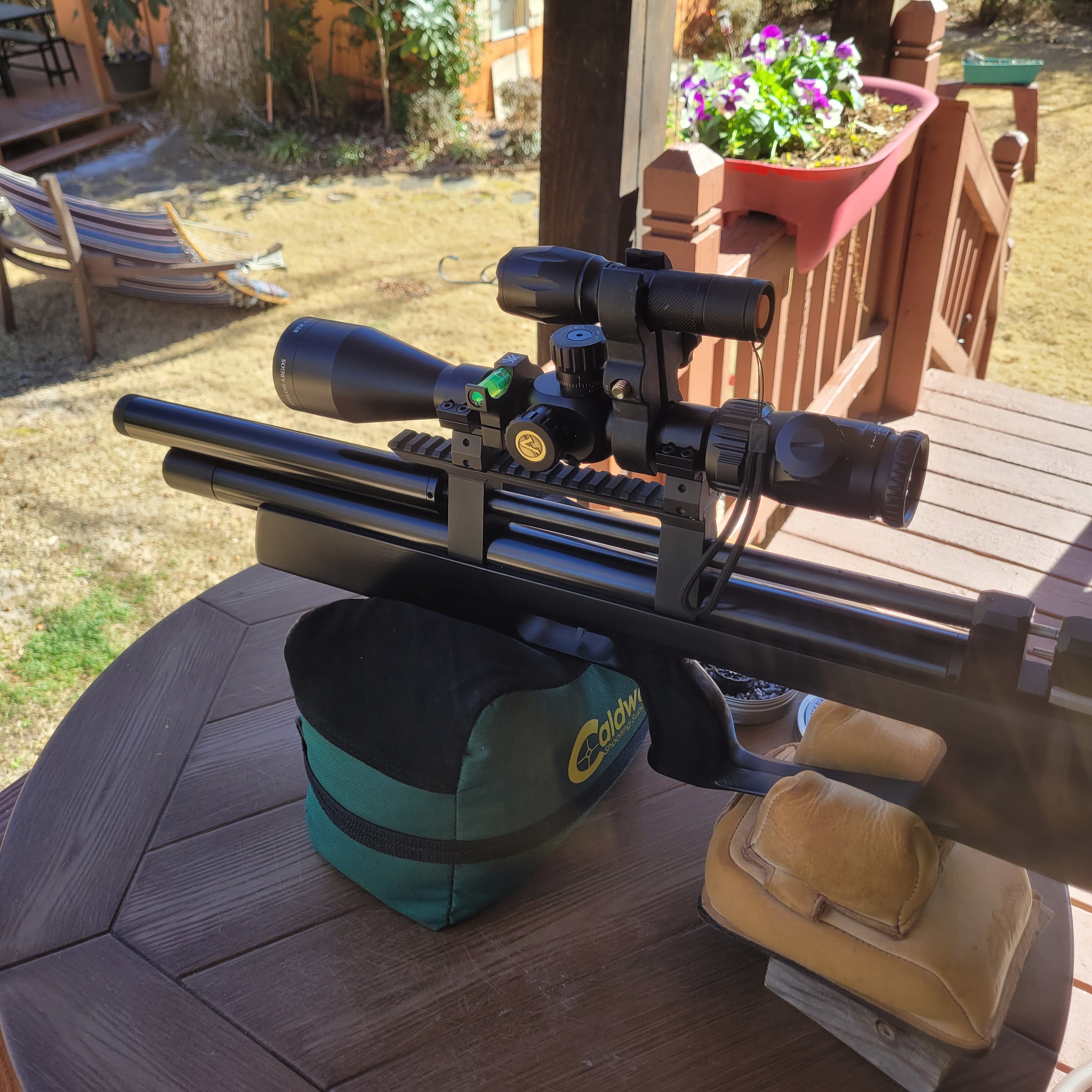

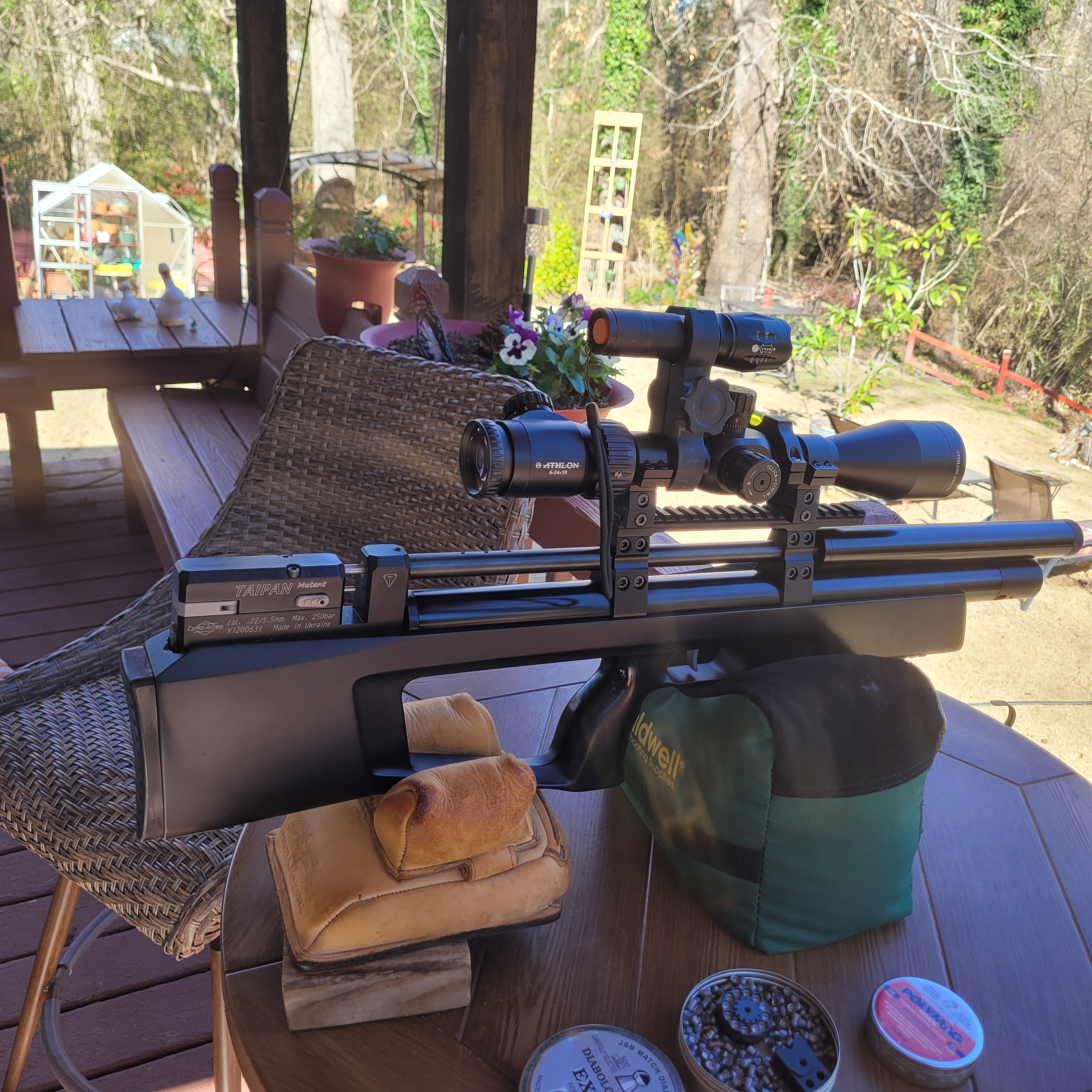

What are some tips on preventing flyaways? How do I tell if it's me or my pellets. I always seem to have a flyway that ruin's my grouping. I dont think it's my gun. I'm thinking it's either me or my pellets. I get consistant readings on my chrono. I get several good clean shots within a 1/4" -1/2" groupings and then a stray or two.
How do I minimize the stupid stray shots? Could use some tips. I'm shooting from a chair on a table with a criket calibur gun with an Arken SH4 GEN2 with a bipod and sandbag to keep things steady. I have a wind streamer close to my targets. My zero is about 25 yds away.
Can I get some ideas on minimizing the flyaways? I'm using FX 18g pellets.

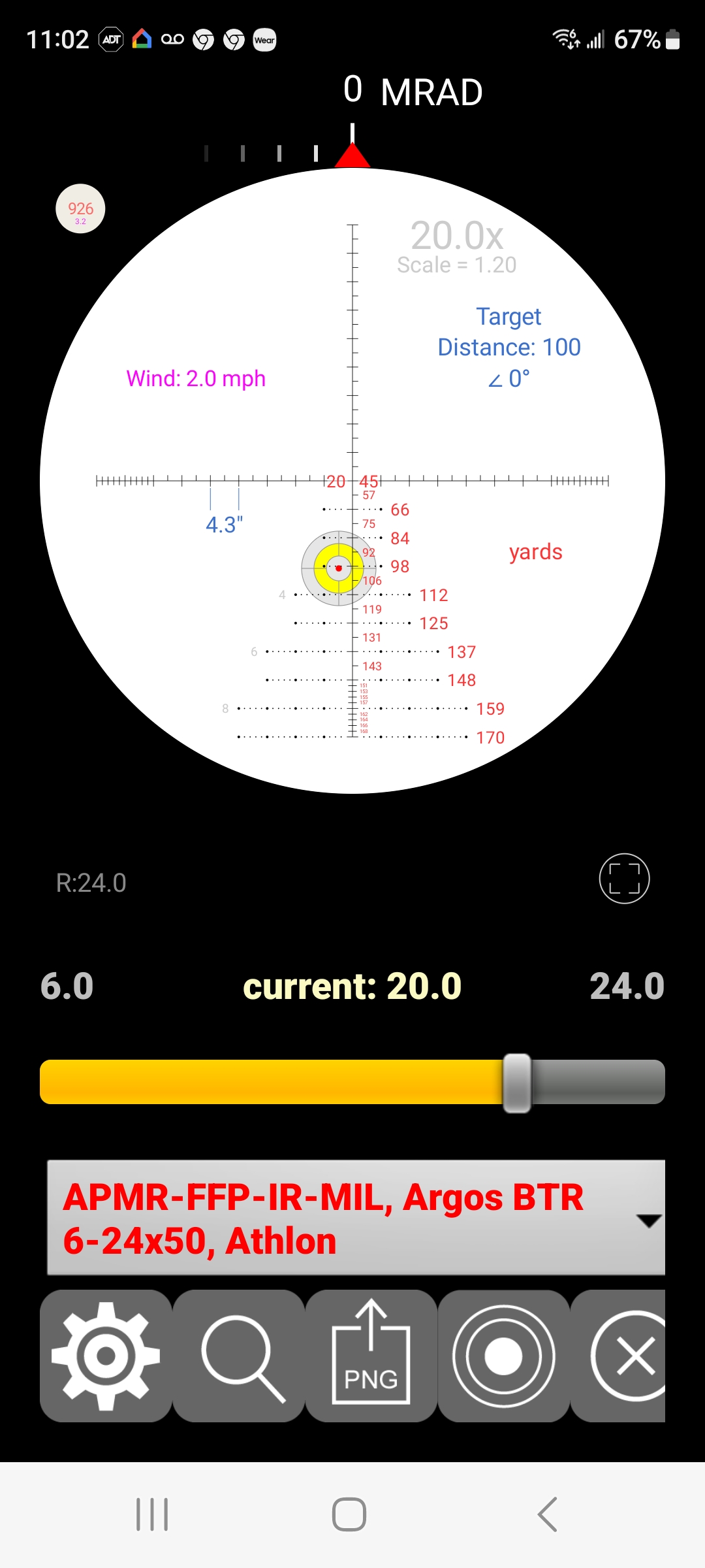

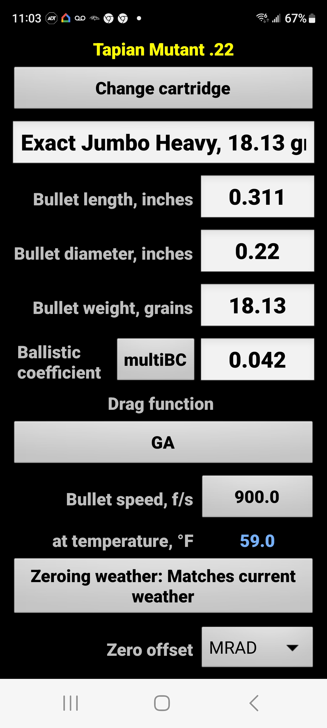

@ FIdi_G., you did not mention the distance you are shooting. Wind could be a factor. A 2 mph wind will move a pellet a couple inches @ 100 yds and you can't feel it on your face.. Try wind flags and study the wind.
