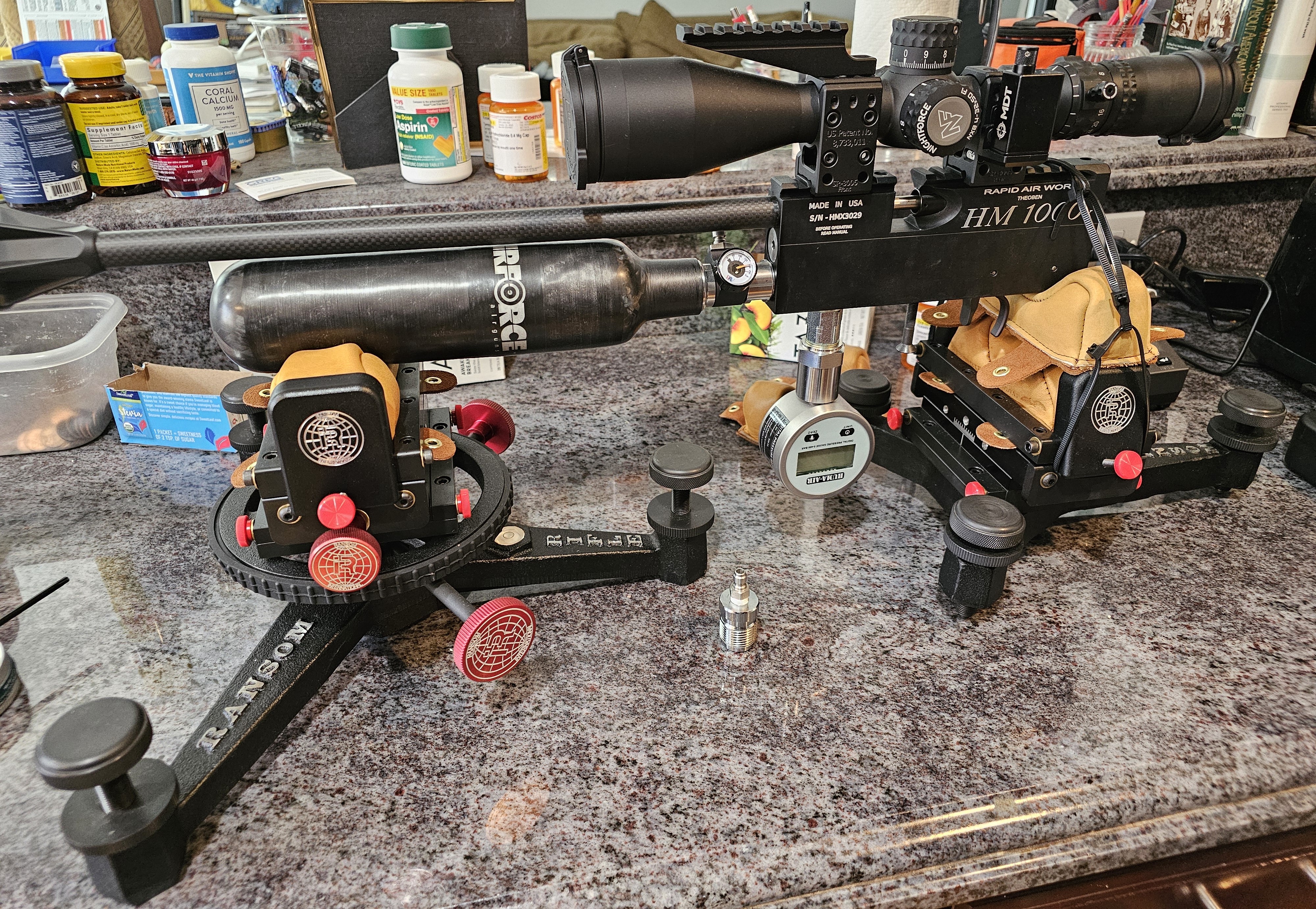

While I’m waiting for a bid from a fabricator on a custom jig to hold my action, this Macgyver method of securing my action to my Ransom rests may work. Both front and rear Ransom rests have vertical and horizontal adjustments allowing convenient and accurate aiming. If I want to remove the air bottle to facilitate a convenient way to regulate the air pressure up and down by bypassing the regulator (HUMA adapter installed replacing regulator) I can use a simple two inch wide stock secured to the action via the OEM stock screw with a 1.25 inch hole to clear the HUMA digital air pressure gauge monitoring the plenum air pressure.
The zip ties hold the action surprisingly secure against the leather rest bags and I doubt recoil energy will be sufficient to move the action. If there is movement it will be very slight and the adjustable Ransom rests can easily compensate and correct the point of aim.
If needed, I can attach my TriggerCam to my scope and see my point of aim on my smartphone. At this point I’m not sure if I want to explore adding external plenums and barrels to shoot slugs at precision and ballistic levels matching other recent air rifles like the FX Panthera or EPIC Two.

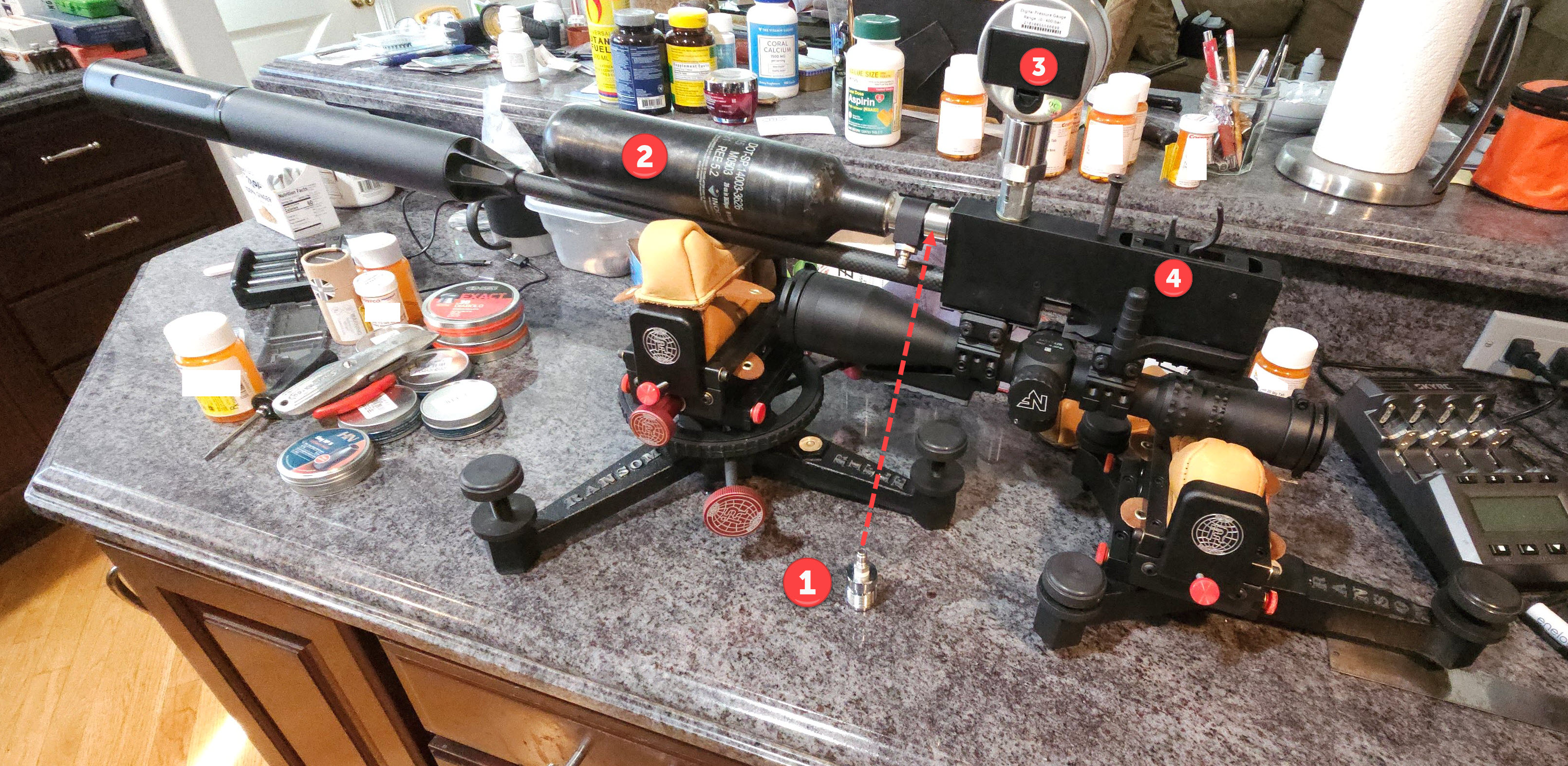

My current strategy to tune a RAW HM1000x.LRT (.30 caliber) to shoot various slugs and pellets has become somewhat of a chore. Out of the box the RAW comes tuned from the factory to shoot a specific pellet which it does very well. Tuning for other types of projectiles due to the lack of an externally adjustable regulator is inconvenient at best.
The goal is to find what regulator pressure and hammer spring tension will deliver the best precision at what velocity for each type of projectile. The OEM regulator requires you to remove the air bottle AND regulator from the action block to adjust. An option which I have done is to purchase a HUMA adjustable regulator, however, this still requires the removal of the air bottle to make the adjustment saving the need to remove it from the action body. Still having to remove the air bottle for each change wastes air and takes time and I don’t have patience in abundance.
Initially I was going to simply open either regulator to a very high pressure (say 190 bar) and provide lower pressure to the RAW air bottle from a dual regulated air gauge connected to an large external air tank. This way I can start at a lower pressure, say 140 BAR and work my way up trying various hammer spring settings. However, this does not allow a convenient way to go back and test settings at lower regulator pressures without removing the air bottle and bleeding off air pressure. Again, inconvenient and wasting air.
The solution, bypass the air bottle (remove it) and connect the external dual regulator and air supply directly to the action/barrel with additional fittings from HUMA which I purchased (see red dot 1). However, without the air bottle what would hold the gun in the front rest? I certainly don’t want to rest the barrel on the front rest.
A second concern I have is confirming what the actual air pressure is in the action/plenum and how close it relates to the indicated pressure from the external dual air regulator connected to an external tank. The installation of a digital air gauge into the action is my current solution, however, this requires the action to be tested out of an unaltered stock. This setup will allow me to note the indicated air pressures in the action/plenum that produced the best precision and at what velocity so that I can duplicate that performance when adjusting the HUMA regulator to deliver the same velocity with each projectile I’m likely to use with the digital air gauge in the action removed and the action back in the stock.
So testing the rifle out of the stock poses a challenge which along with no air bottle for support will require a method to secure the rifle in a rest. I looked into purchasing a second hand stock which I would cut off just before the digital air gauge inserted into the action. Used stocks were found in the $275 and up range, so currently that is not an option.

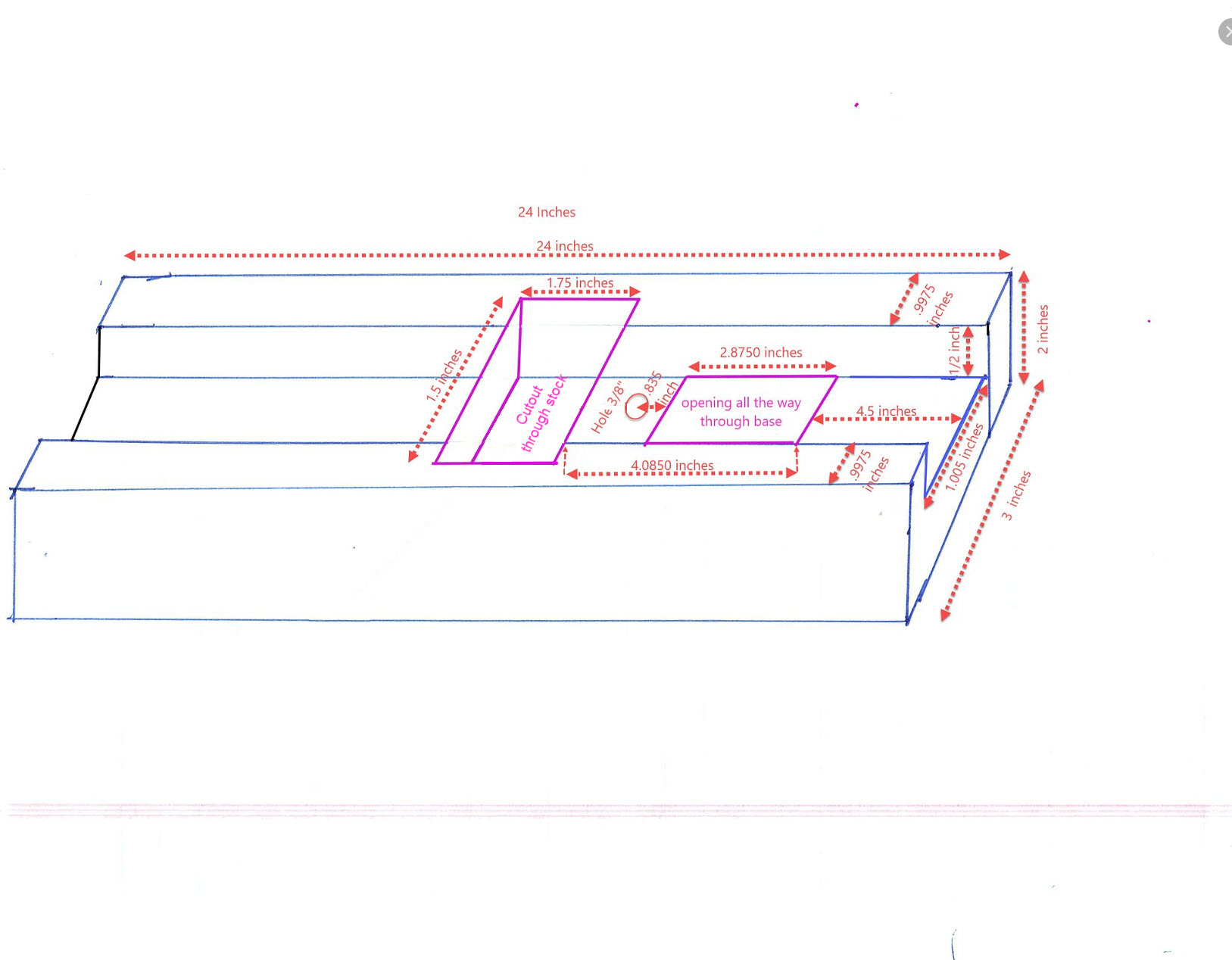

I’m currently working on a bid with a fabricator to make me a jig to hold the action/barrel that I can then hold in my Ransom front and rear rifle rests. Aiming the rifle is anticipated to be done using a TriggerCam camera and smart phone. Maintaining a vertical optic position will be handled by an MDT digital level mounted to the Spuhr scope mount. If I’m able to get behind the optic I may drop the use of the TriggerCam.
My rough sketch of the jig is not to scale and I don’t have any CAD software for my current Windows operating system. I have an very old version of AutoCad, but the upgrade price is not an option at this time.

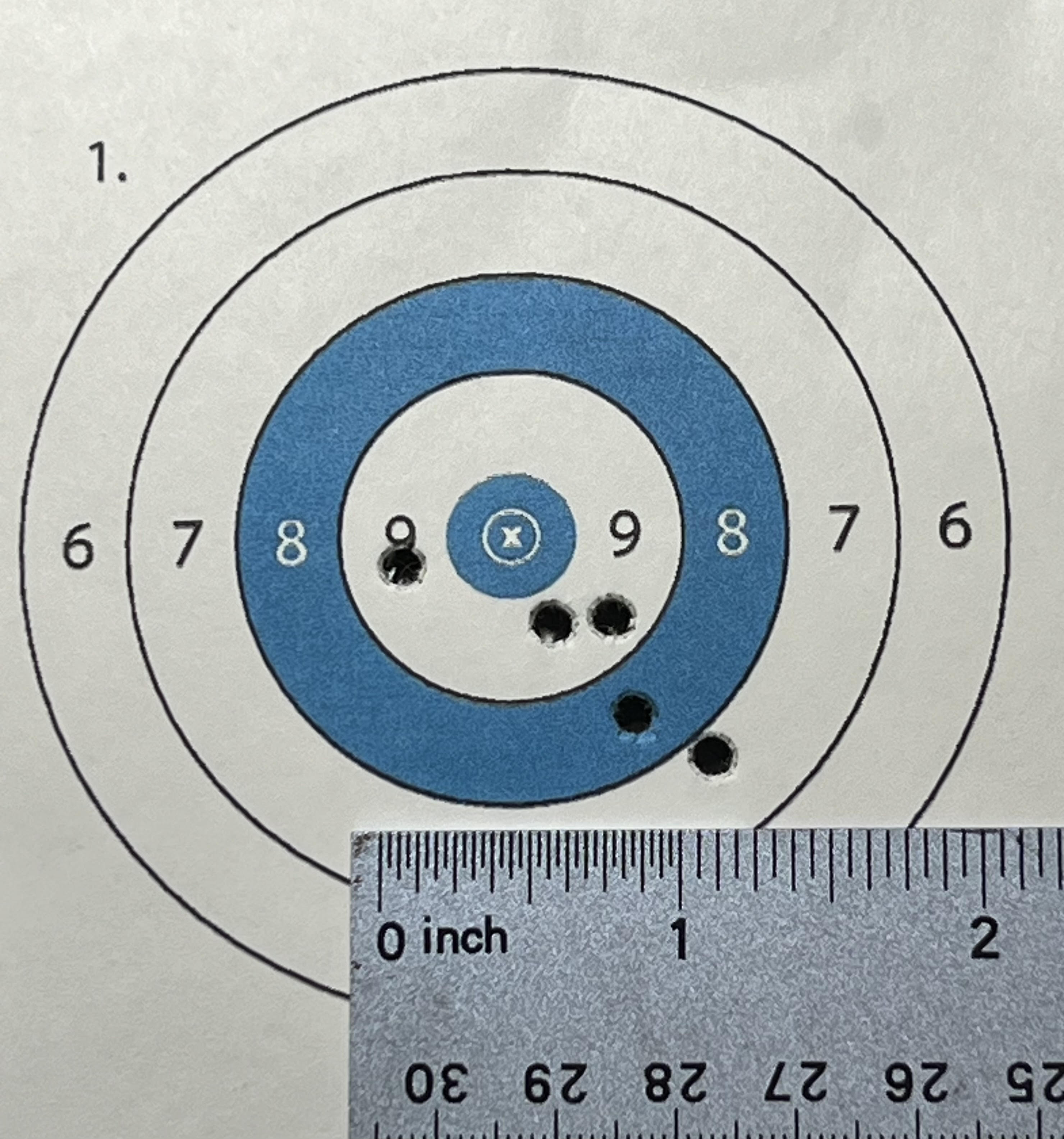

This is what my RAW HM1000x in .177 cal shot first time out after being put together by Martin. I used Zan 13.4 gr slugs. It's barrel is a choked LW polygonal. There's no reason why I should screw with this. I previously tried shooting my Crown MKII with a 600 mm barrel and after a lot of typical FX fiddling, it was close, but not as good as the RAW at 100 yards. If a gun comes set up with a specific projectile, why do you guys have to fart around with it? It shoots better than you can most likely.
