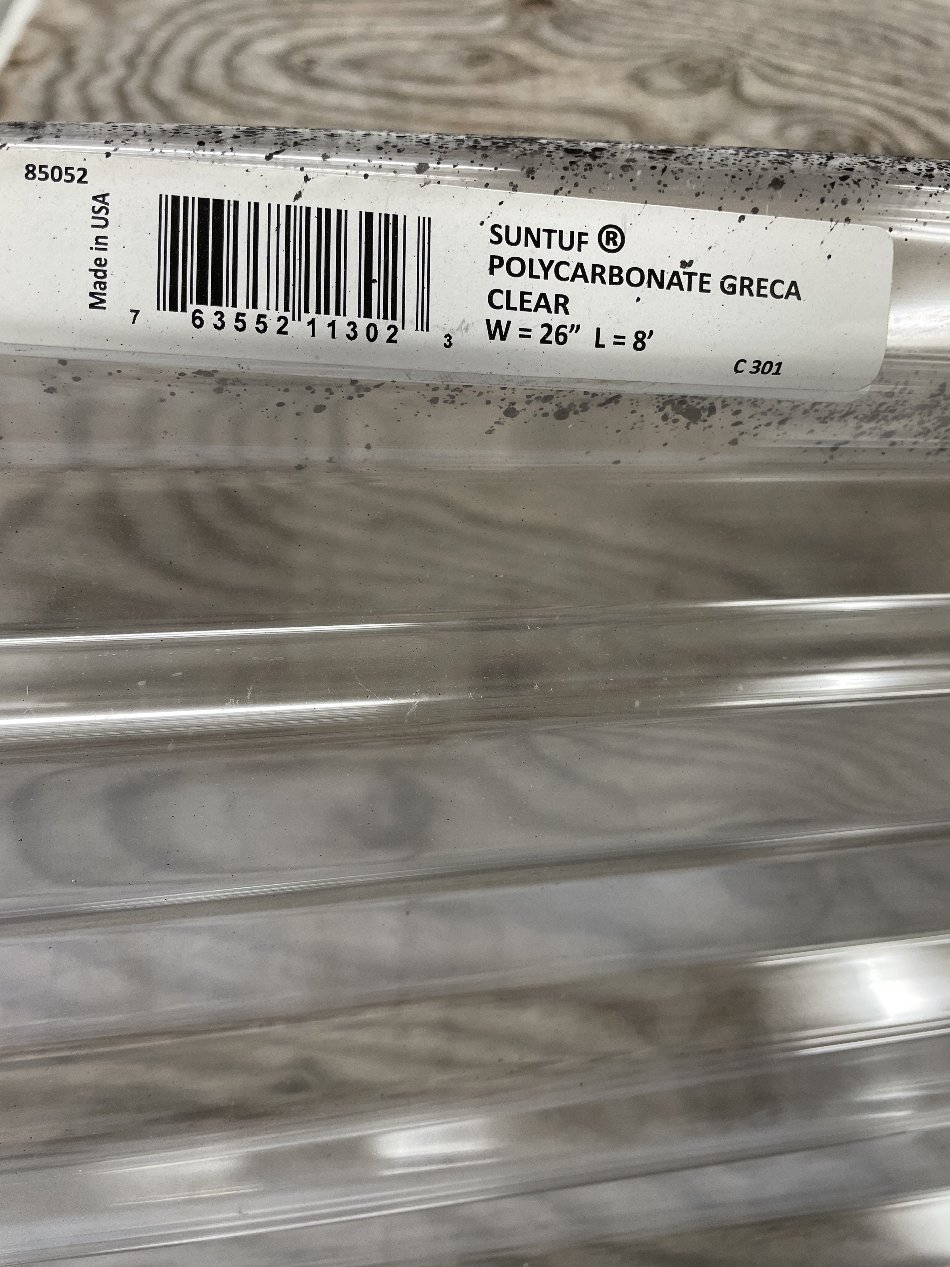

This was my first thought as well, is it really fiberglass panels or is it polycarbonate panels? They look the same but are not. Polycarbonate is much more durable, I used it on my wife's hobby greenhouse.

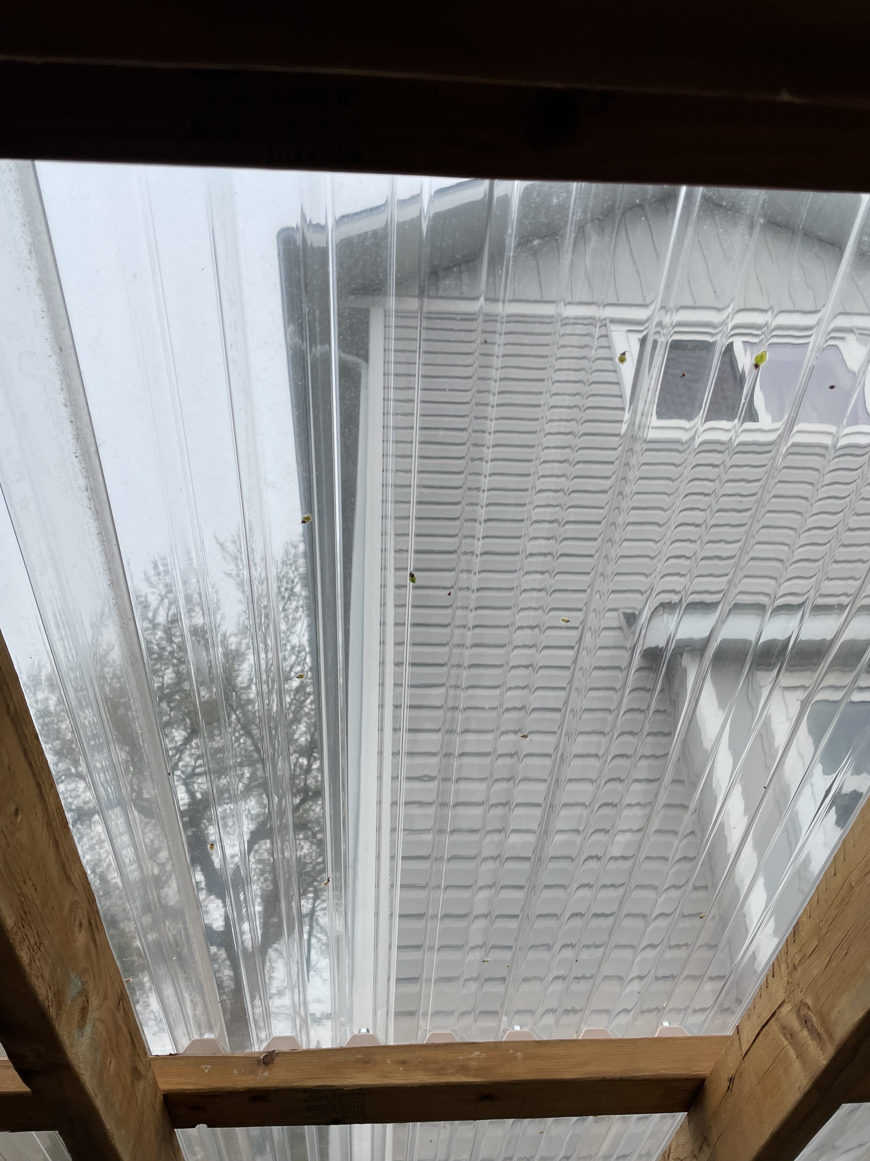

You can see pictures of the roof in this thread. Perhaps you can identify the material?
Reactions: WoodWelder

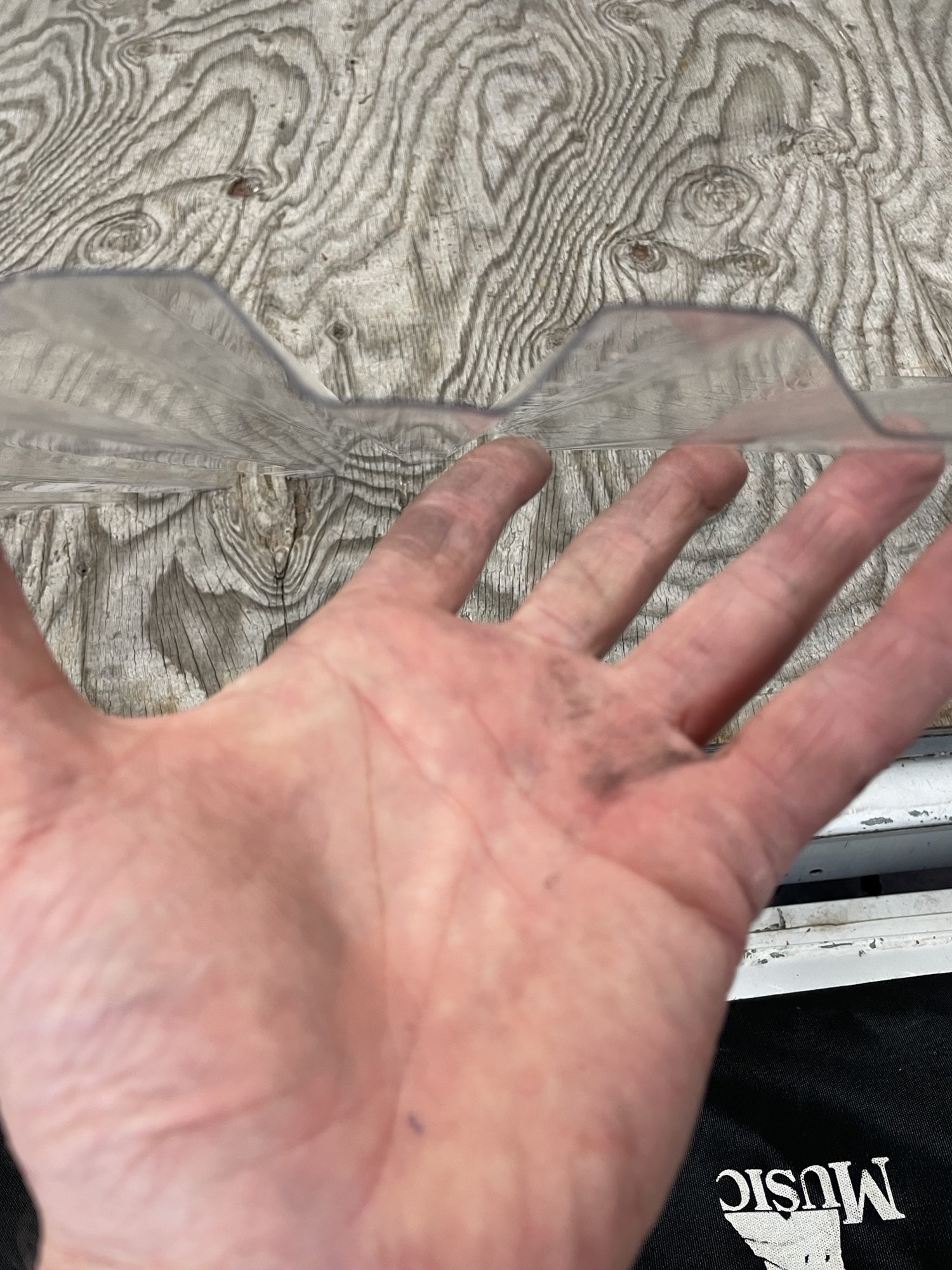

Material used SUNTUF Polycarbonate
