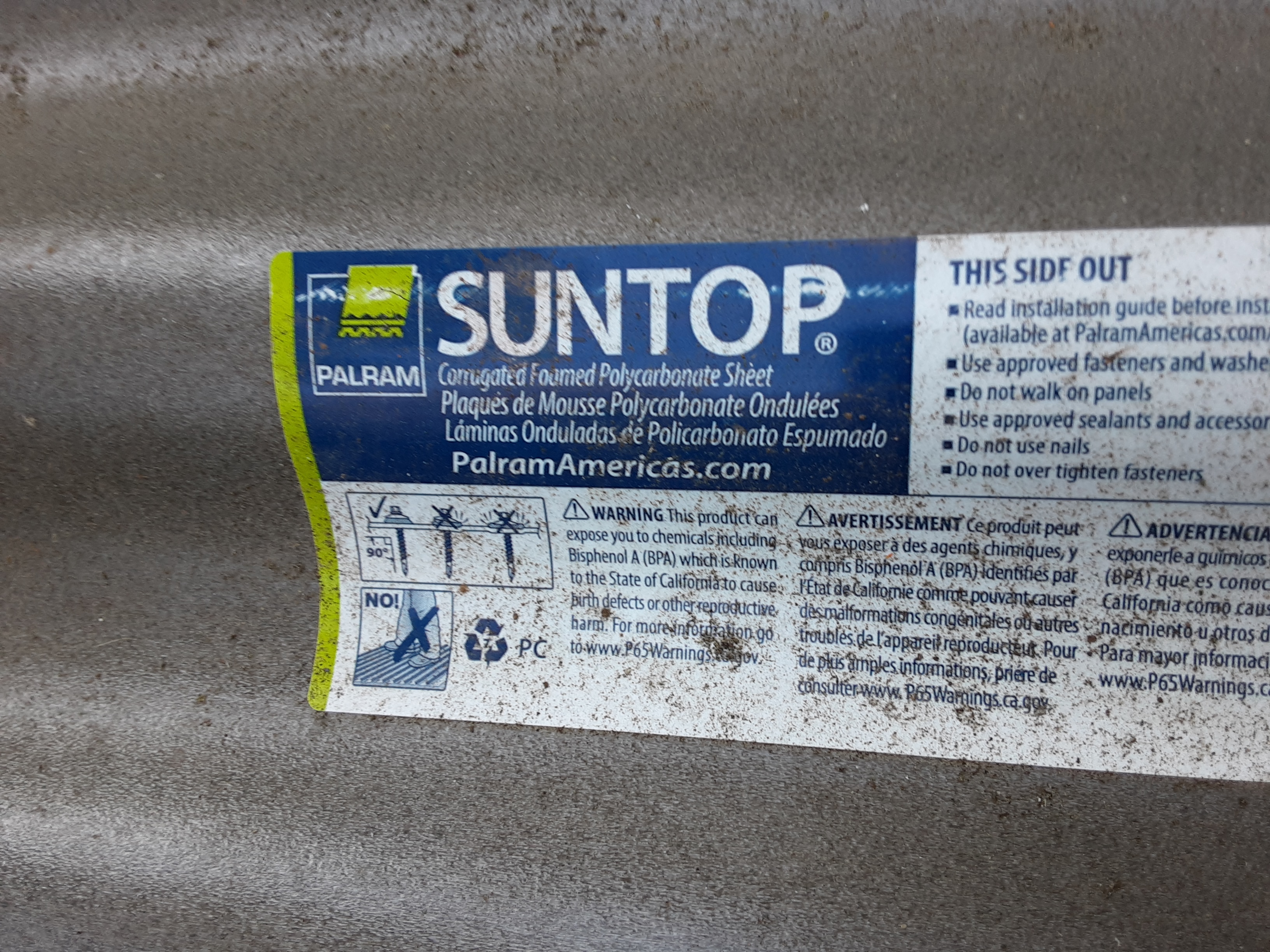

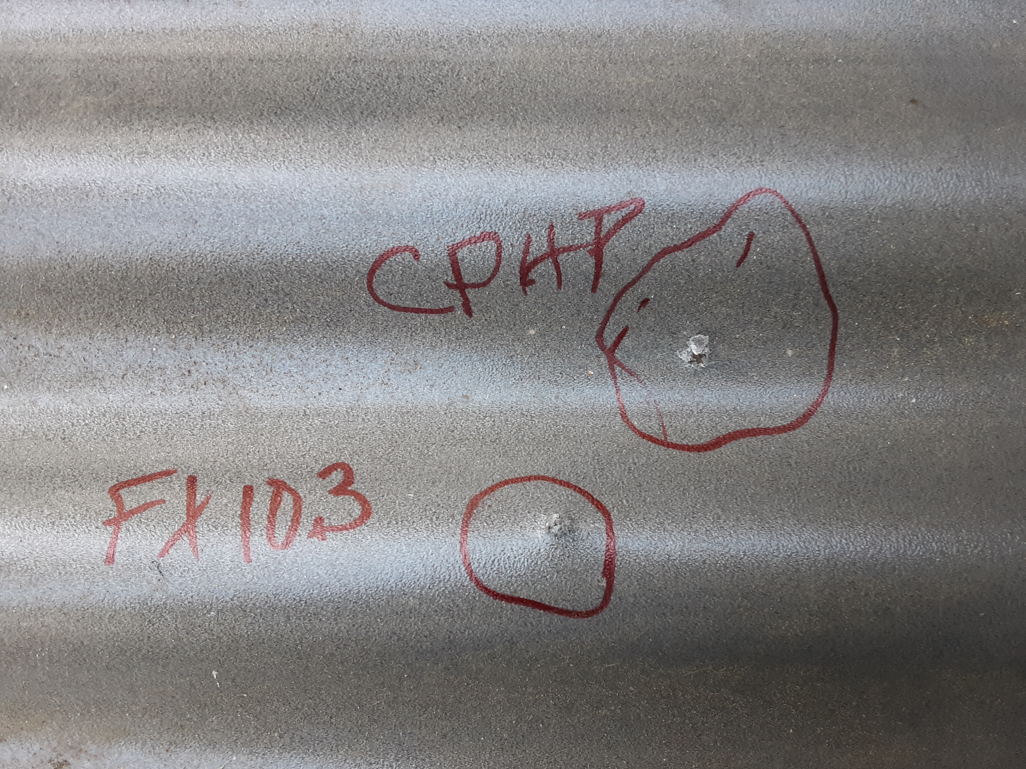

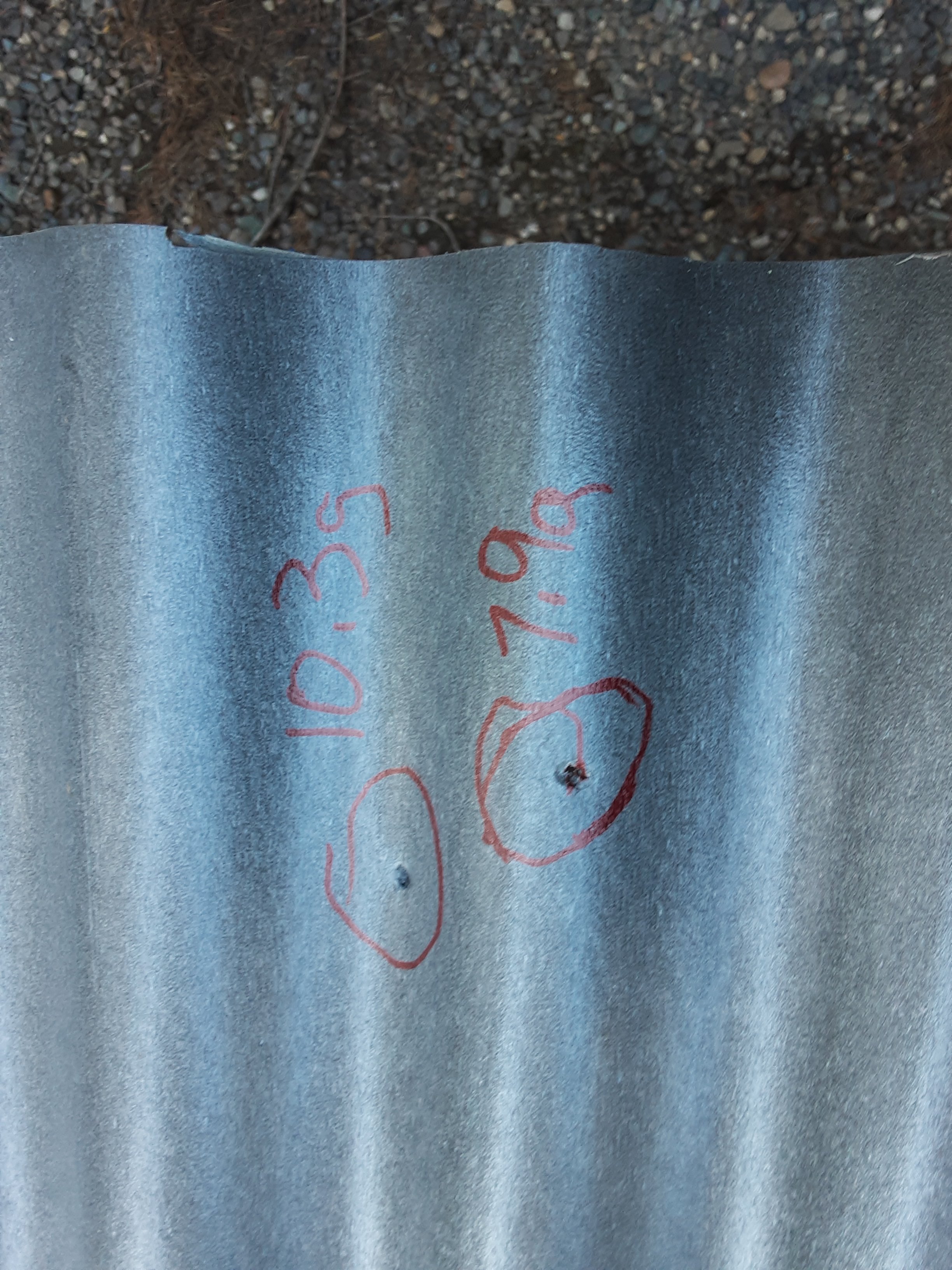

Foot Lbs verses roof damage ?s
.20 11.42

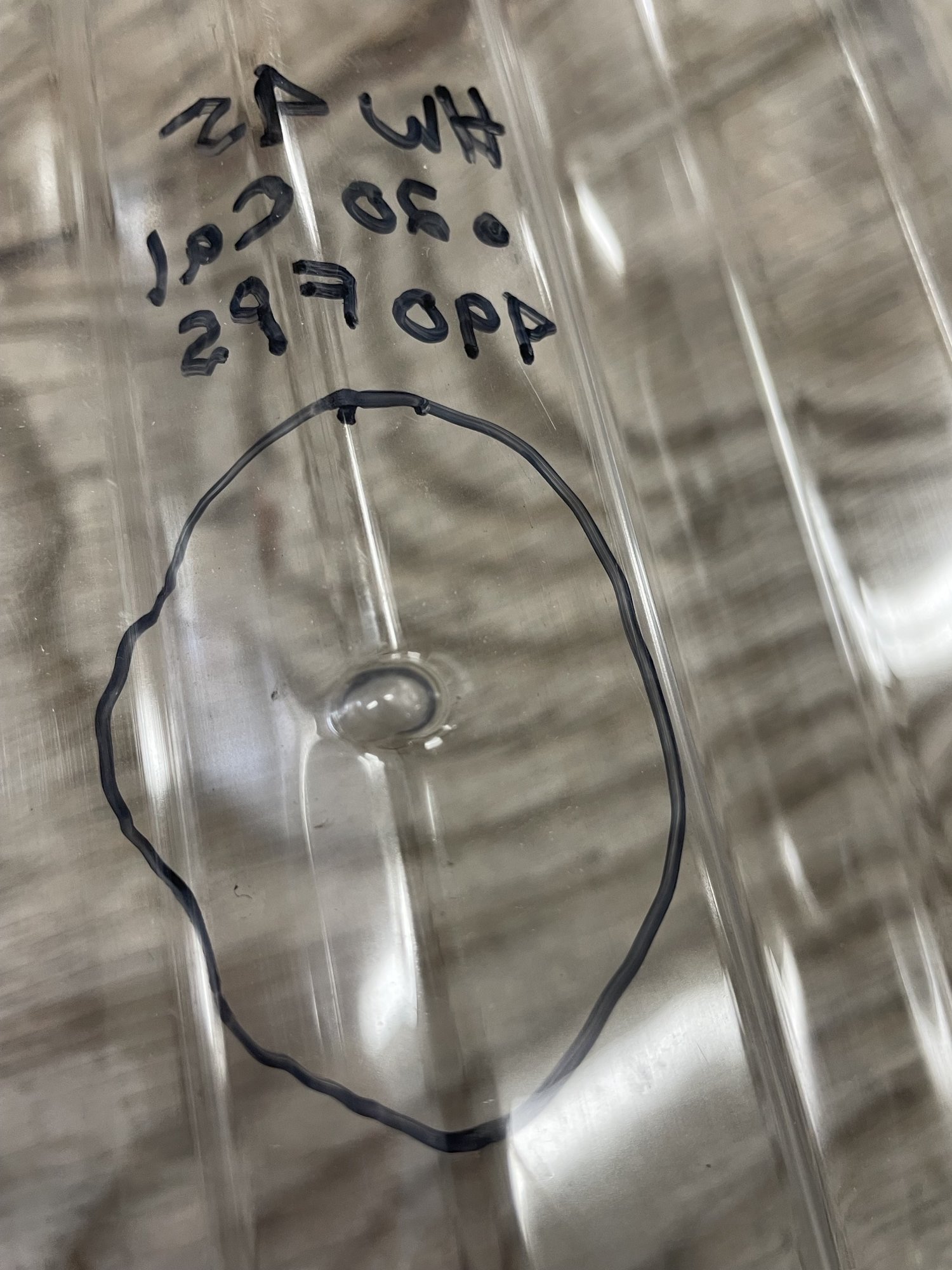

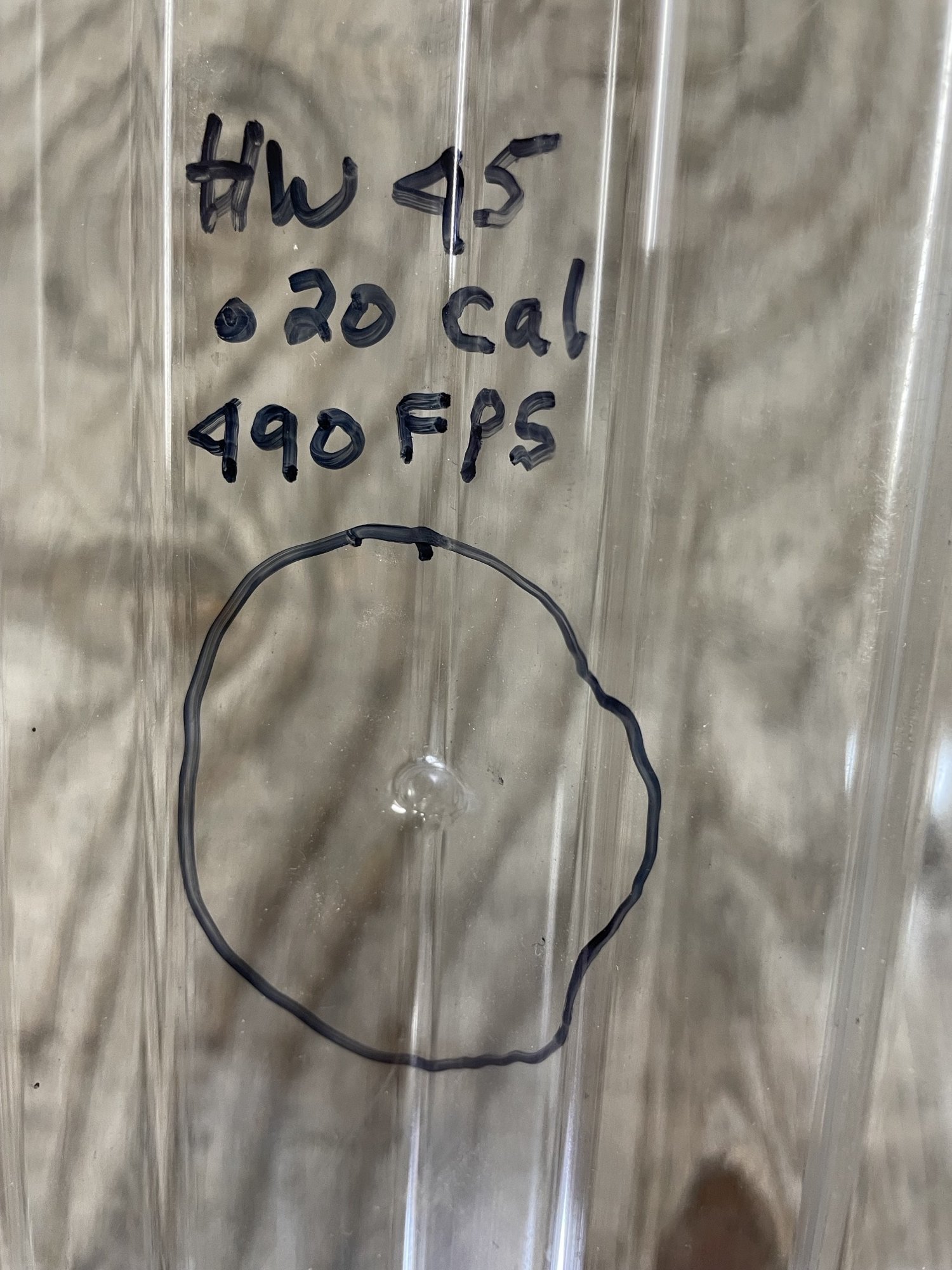

Didn't go thru but is compromised.
Time out, how in the h are you going through Polycarbonate? It's used in safety glasses and for shielding on machines that can throw large heavy things. I've taken polycarbonate safety glasses and have beat the snot out of them with a very heavy hammer on concrete and ....all I did was scratch it. I'd consider non-lead pellets, or even an air soft but....I'd even test those darn things, they are anything but soft.
Reactions: WoodWelder
I personally wouldn't shoot in the direction of a fiberglass or polycarbonate roof, or any roof really, also always be mindful of where the projectile will go once it passes through the target. If you must, I'd keep it sub 12 fpe.

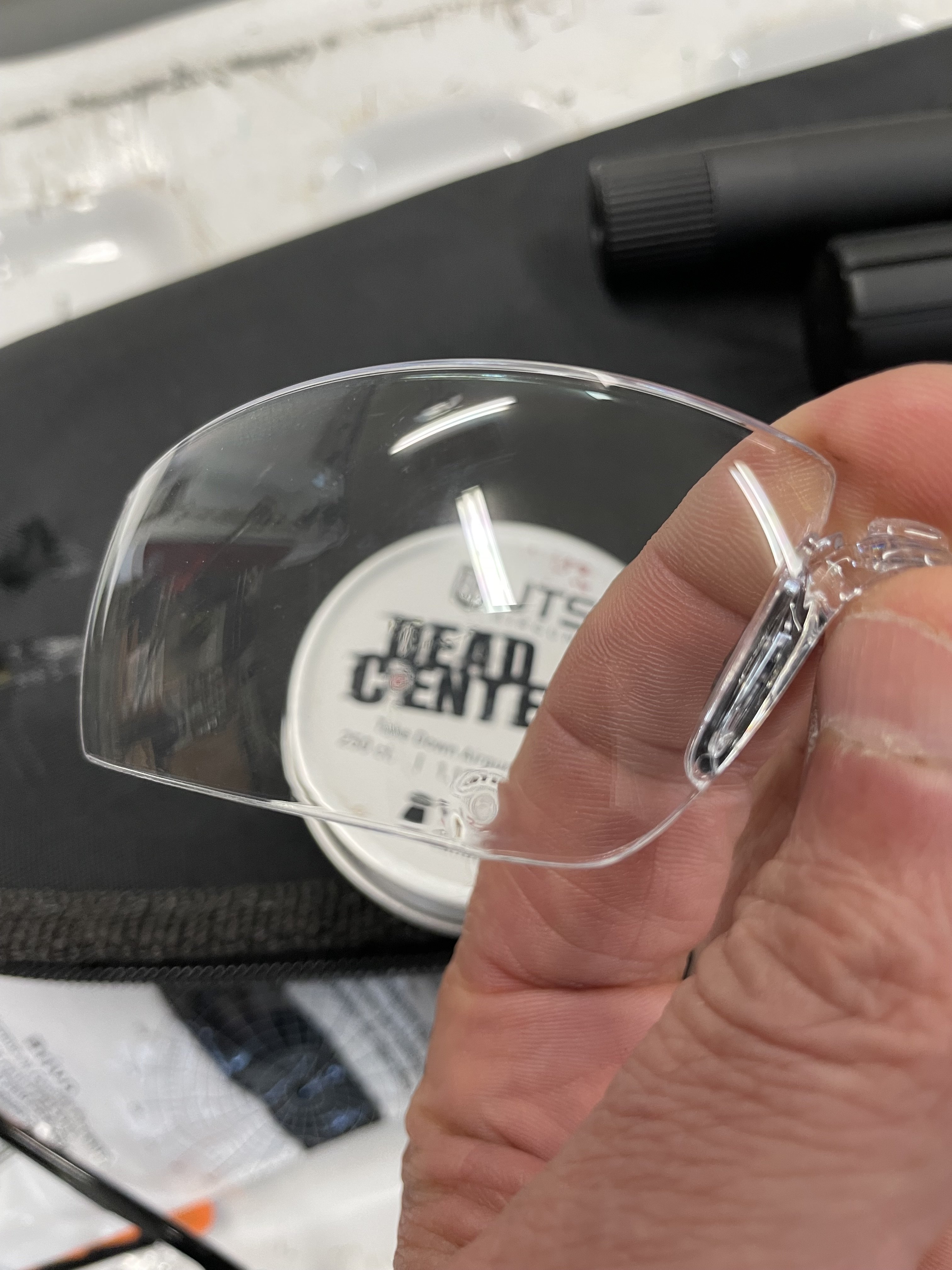

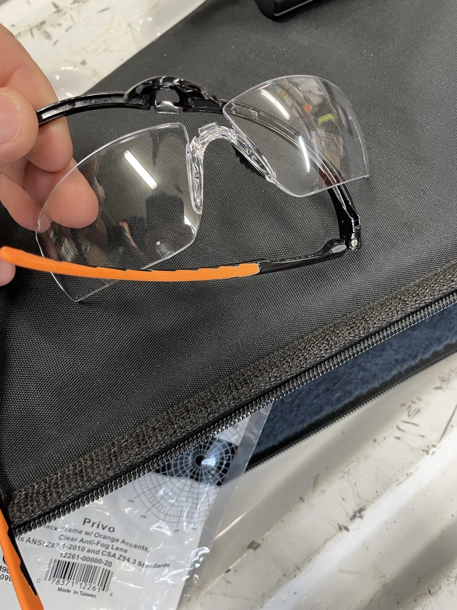

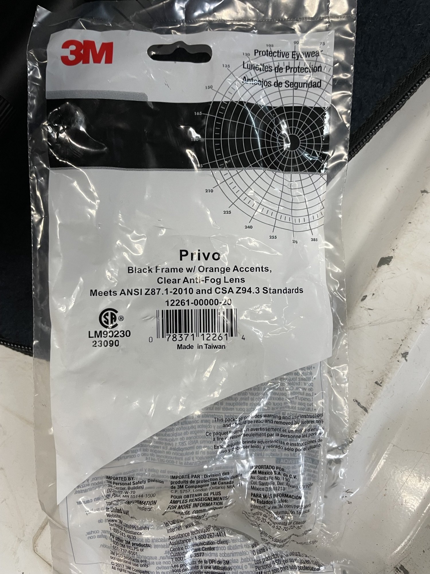

First two pictures fresh out of the wrapper!

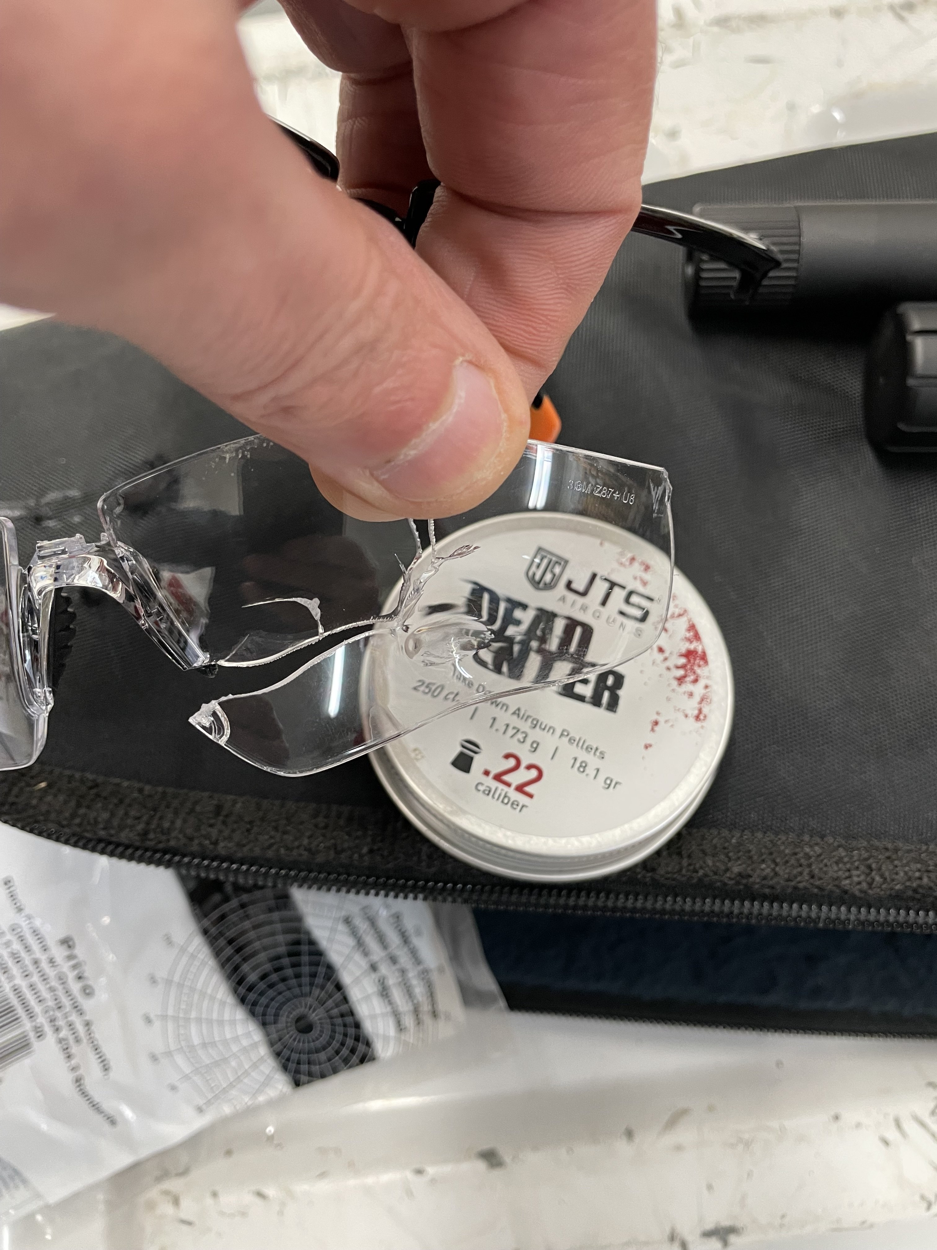

Third and fourth picture shot at 30 yards
Final picture shot at 15 yards
SAFETY is a multi billion dollar industry! Don't believe all the hype/marketing.
ChiCom plastic? Honestly unless we look up the standards, but I do know that polycarbonate is damn near unbreakable. Like i said I beat the snot out of some lenses, much thicker by 2x maybe more, with the ball peen end of a 2# ballpeen, concave side down on concrete. I think I've got some old ones here somewhere time to set them and more testing. I'll tape the lens to side of a heavy steel bullet trap, going to be fun
Yeah, the surface area of a ballpeen hammer compared to the tiny pinpoint high energy of a pellet is no comparison......This is fun, either way, I look forward to your results.
I forgot to mention, this was one shot per lens, both shots knocked the frames off both times. The 15 yard shot took me some hands and knees action looking for the smashed lens pieces.
Wear safety glasses, they do help! (y)
