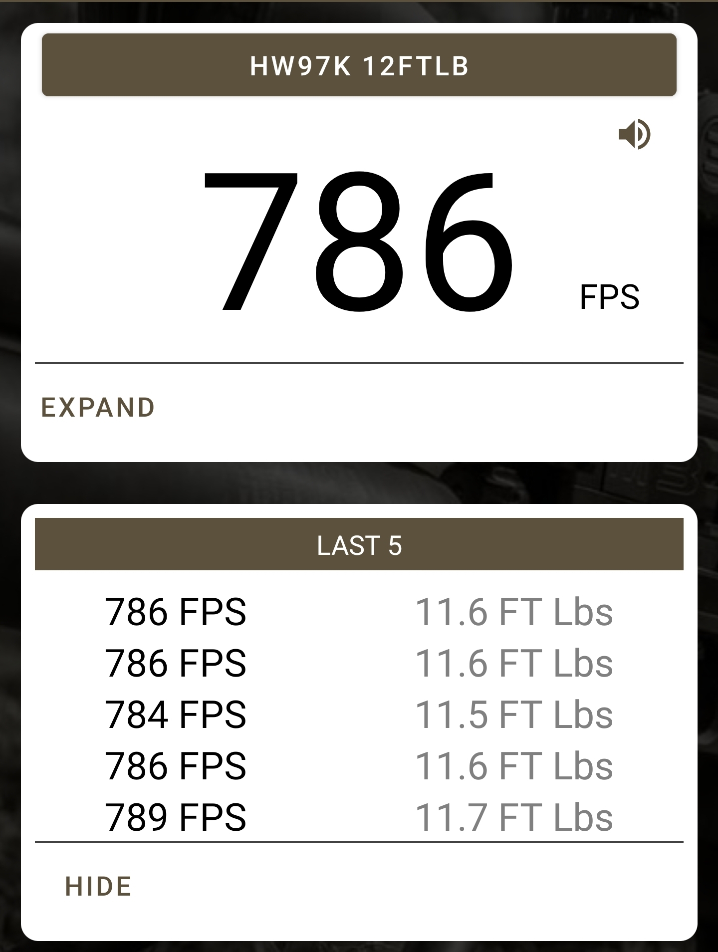

Got to test my 97K tune today. I ended up pulling one spacer (0.145") which brought me down to FT legal. Here's some chrono numbers with JSB 8.44s:

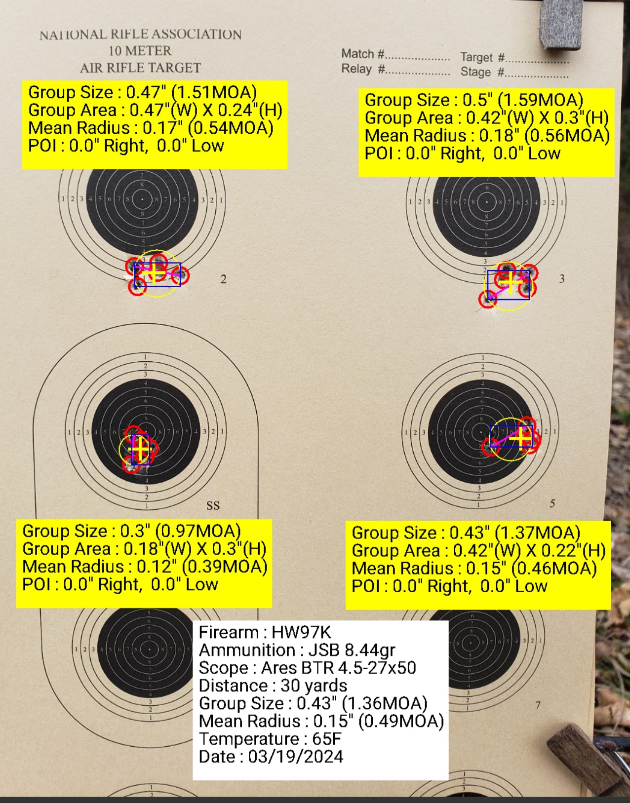

On to what matters... does it shoot? I'm going to say yes. Keep in mind I'm dealing with 10+ mph winds with one little ribbon down range as a wind flag.
Nice work. I've never even considering modding the TP hole. Do you like the results of this?
Nice chrono readings. Looks spot on 👍
I do like it but I need to test more to see how it works in the field shooting from different positions and holds still. I also want to shoot it next to an unmodified PG4 12ftlb kit to really see how much different it is. I think @shootermeb has one in the same stock even so I can get a direct side by side comparison at the next match if he'll humor me.

Did some outdoor Field Target practice today. It was cold and windy but it did VERY well. Tried various holds from the ground and some standing offhand and POI was consistent across the board. I then broke out my TX200 (same power and short stroked ~11mm) and compared the recoil between the two. Believe it or not the 97K is tamer even with the slightly bigger piston. I am truly excited to see how she does at a match now
