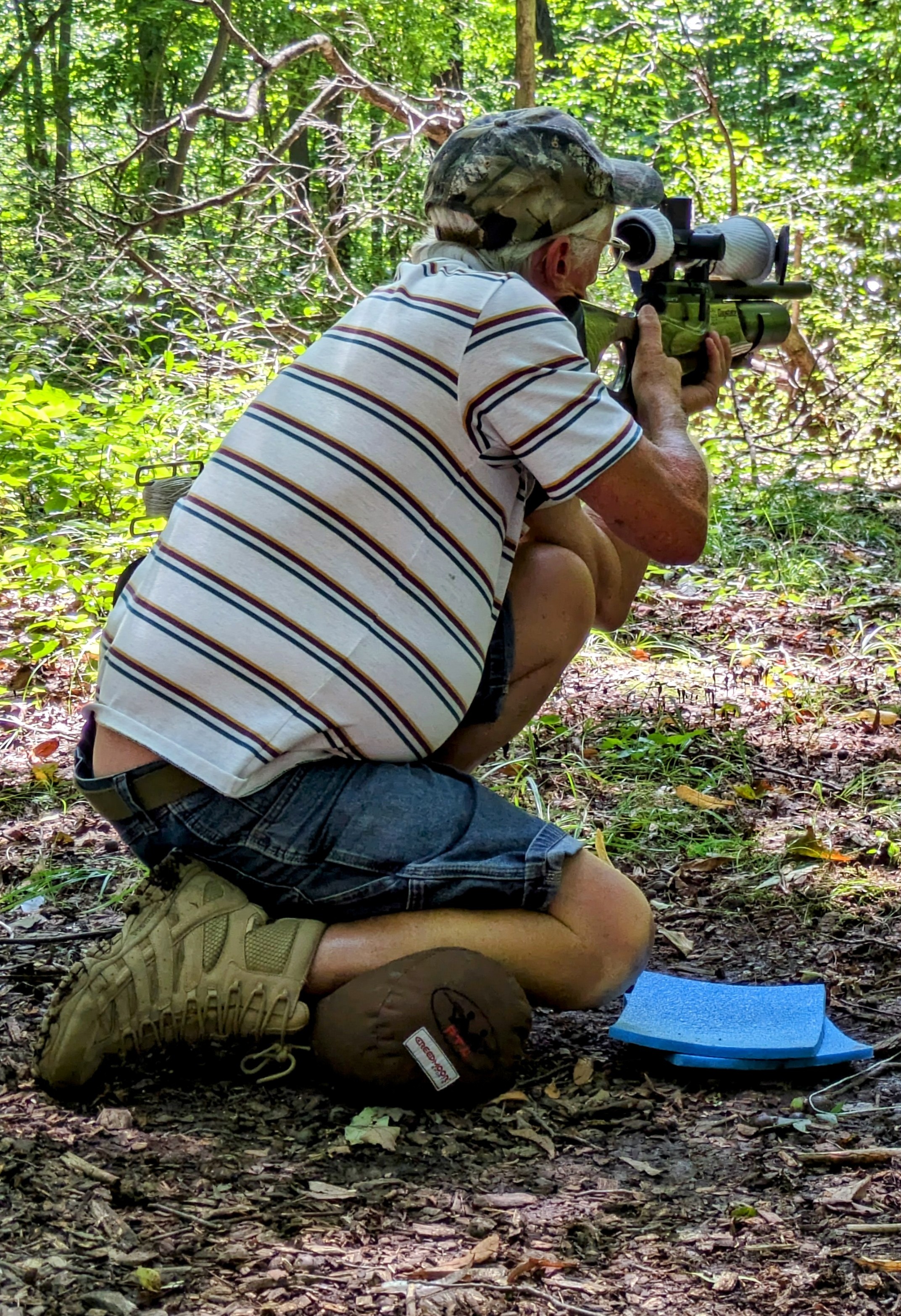

Who wants to critique this?
I wouldn't cuss at you for shooting this way, but there's a better way.
1. Get the kneeling roll back under your boot laces and your knee on the ground. Floating on your ankle means you are holding yourself up with your hip flexor and right hamstring.
2. Lean back a little and instead of putting your bicep on your knee, lay your forearm along your thigh. Your wrist has to be in front of your knee, so curl it up like a witch and it's very stable and easy to maintain.
That's my secret for a good kneeling position. The whole thing is built around the top of your forearm laying on top of your thigh, then you figure out how to move your knees and butt to get the gun in position. A hamster or palm rest helps a lot, just as with off hand.
His belly is likely against his upper thy of left leg
His Knee is NOT contacting the ground and he is sitting on his shin to roll to ground & Not of the heel of his foot.
Above IS NOT LEGAL
His Socks are being used incorrectly ... Lol
