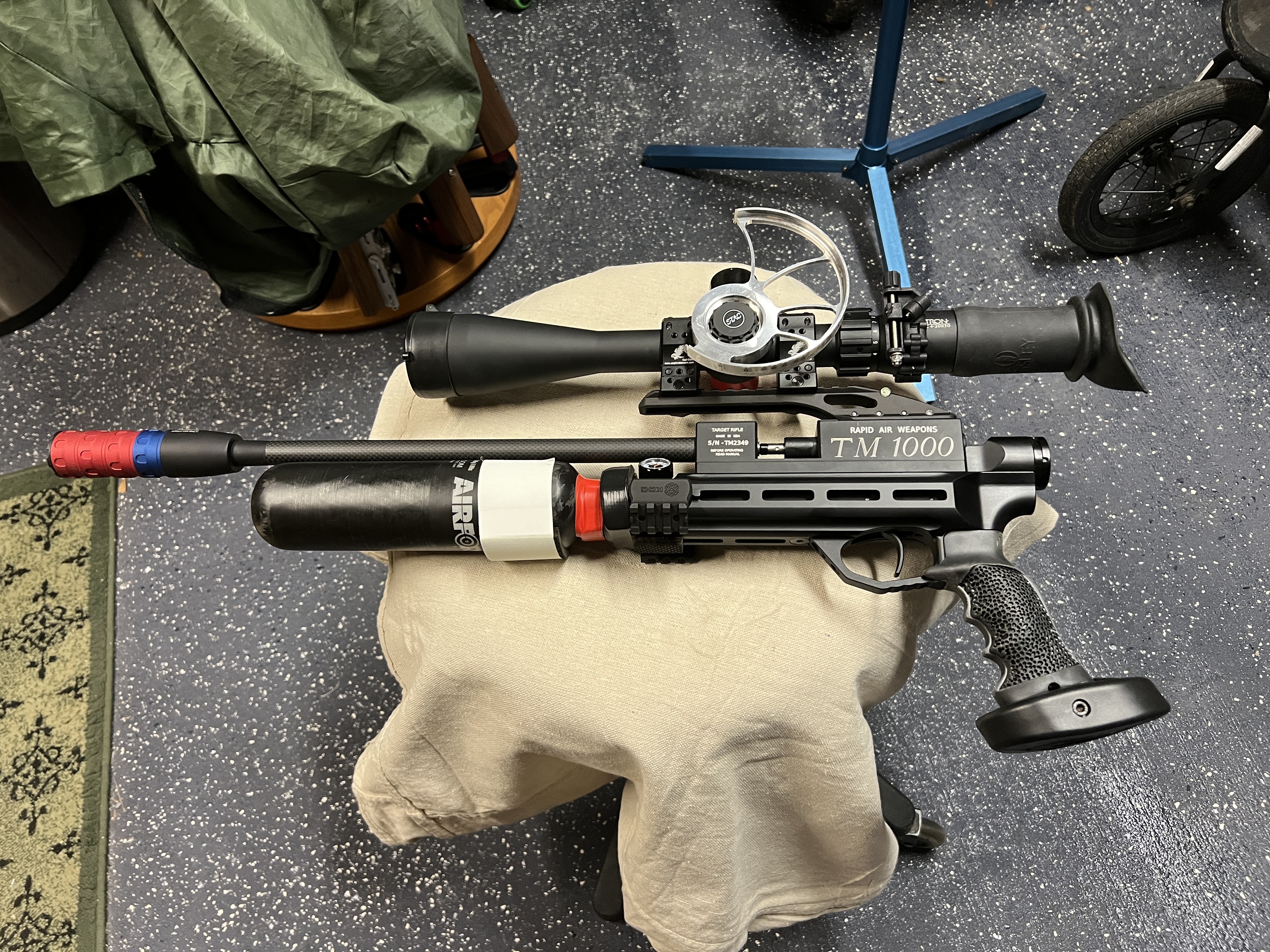

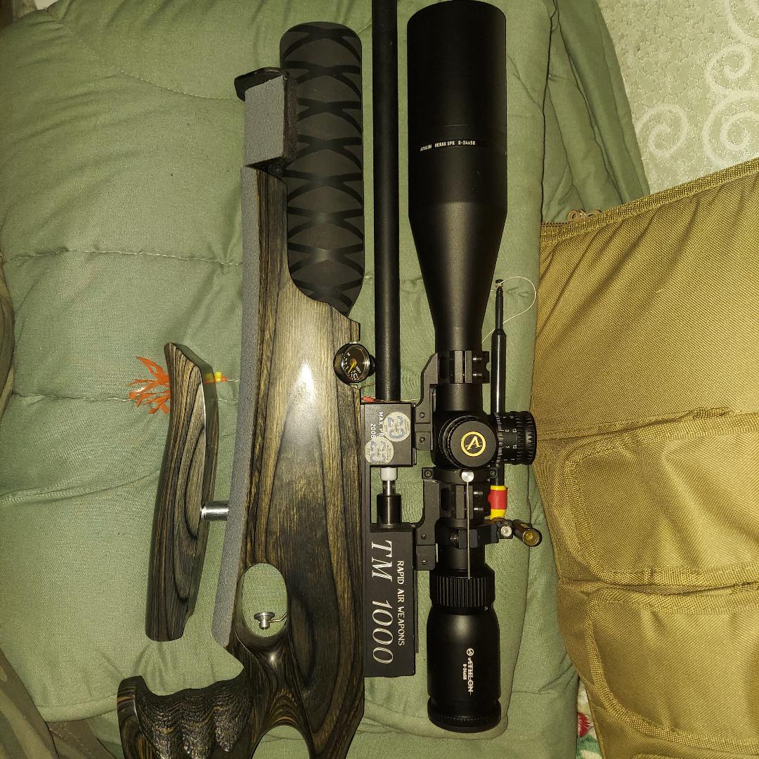

A very slick way to do it ...
This a RAW and if bi-pod yoke was resting on bottle, the edge of fore stock resting BEHIND the Yoke becomes the stop ;)
* But as we know a bi-pod stop is IDEALLY placed in Front of the b-pod yoke to keep yoke from sliding forward and bi-pod falling to the ground along with the rifle !!
What I've been doing for years now is fabricating a V block that fits the radius of bottle or air tube, has a 90* V fitting the Bi-pod yoke, then has a forward stop.
* In this way we get to control Side/Side cant wobble & have a forward stop so bi-pod stays under the rifle with less chance of it falling to the ground !!
It is just a profile change to the rifles fore stock, Does NOT attach in any way to the bi-pod allowing bi-pod to fall away when rifle is lifted being perfectly AAFTA legal.
* Tho note the stop still needs to fall under the 6" rule for depth Barrel C/L ahead of trigger guard.
