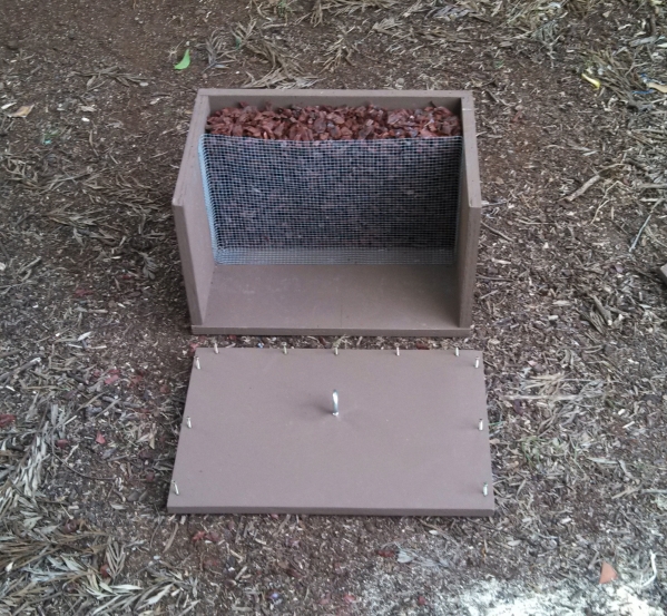

Here's a trap I made a few years back
You need a pretty fine pattern to keep the mulch from falling out (after repeated shot to one area), but the wire is replaceable. You may run into a problem with the size your talking. Keep in mind rubber mulch can get pretty heavy.
