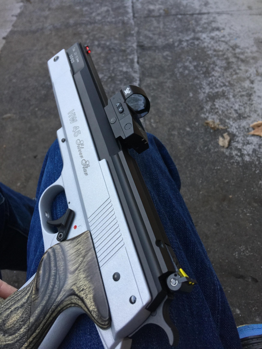

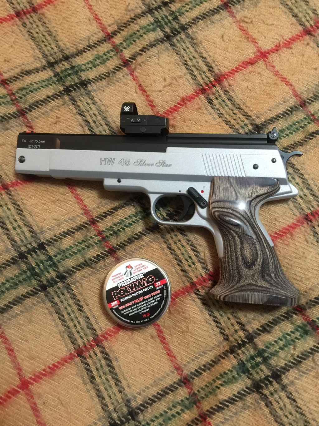

I got a vortex viper red dot. I se the utg weaver to pic adapter to mount sometimes. It was mounted in order:ataman M2r, weihrauch hw45, weihrauch hw44, leyla 2.0. My thoughts are this, red dot, best used for fast target acquisition, both eyes open. Once you get used to it, point and shoot. No parallax, no mag, nothing to set up, just turn on and shoot. Cons: no magnification. Only your peepers. So for me you will never be as accurate past short range with a red dot. So it went back on the hw45. I put scopes on all my rifles and even the hw44 pistol has a scope. But it was very satisfying hunting with a hw44 and a red dot. Past 20 yds and it was a gamble on where exactly it lands. I have a gen 2 fortitude and I was happy using a hawke 3-9.

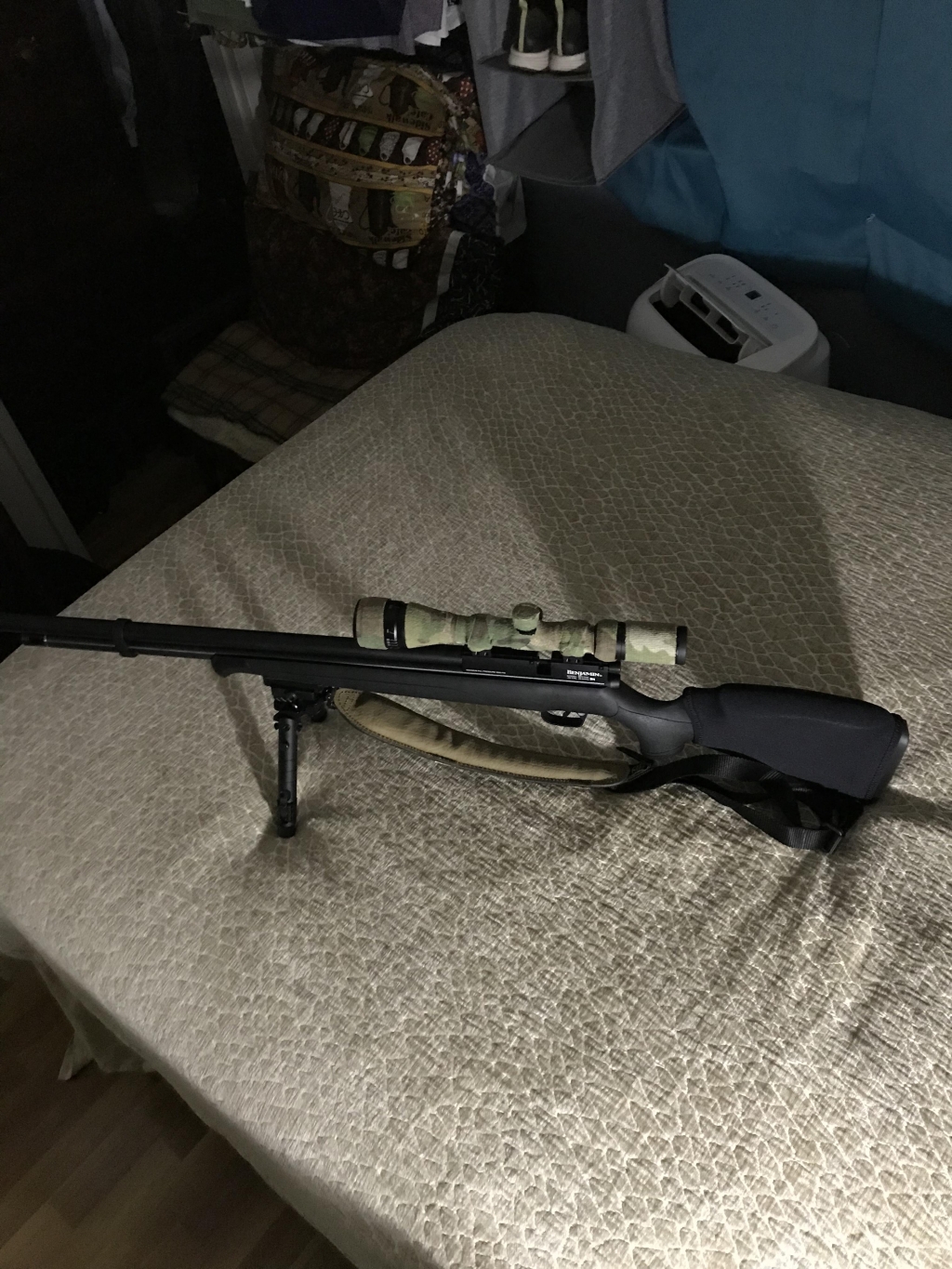

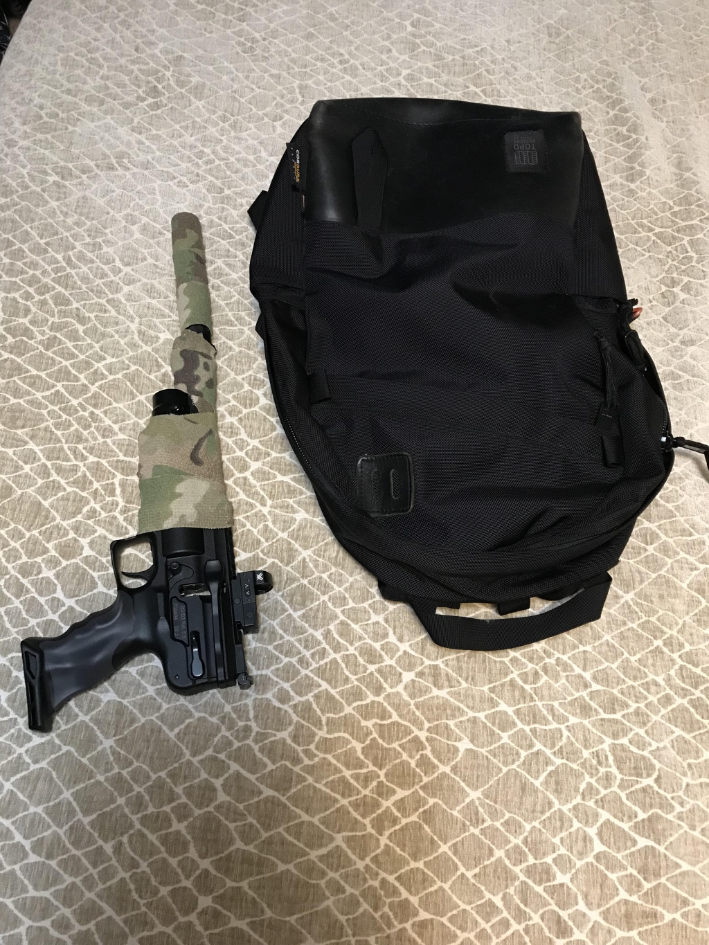

Due to only having one very weak eye left, I use a UTG Reflex sight on my Seneca Carbine 25. I also have a light mounted on a 45 degree off set rail. With my 58 grain cast bullets at 85 FPE, it is a great tool for hairy things that go bump in the night. It keeps that carbine fast and light. Having shot 2 home intruders in my 7 decades, one a hungry black bear 15 feet from my sleeping toddlers I truly need such things these days to sleep at night.
