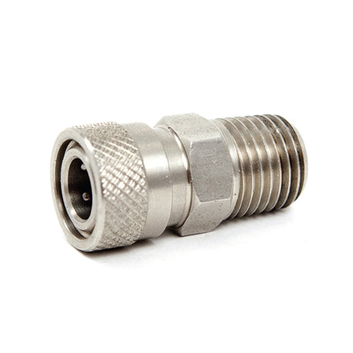

Wonder if this is the type of fitting.
Allen
@Healthservices Wow! That’s very close to what I’m looking for. Have you used this vendor before?

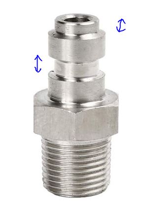

I need one of these.
https://www.uswaterrescue.com/products/ad-24-scuba-adapter-scubapro-male-bc-to-1-4-male-npt?_pos=2&_psq=¼"+NPT+male+to&_ss=e&_v=1.0
Or one of these?
The vendor looks fine, no experience with them but target audience is serious. Things to keep in mind foster diameter is 5/16 (.312 really .306-.309 and Chinese fittings are 8mm (.315 really .308-.312) which is Foster females don't fit Chinese males. The Foster company (original designer of this fitting) only rates them to 4500 psi in stainless. The balls on the female dent the rib on the male due to high pressure. This is why factory Fosters females have 6 balls. Chinese fittings have 3, 4, 5 and 6 if you are lucky. The best male fittings are heat treated steel from Ninja. If you want the Foster male to 1/4 NPT Male you may be better off getting a Ninja foster male and 1/8npt to 1/4 npt stainless reducer. https://www.mcmaster.com/51205K342/

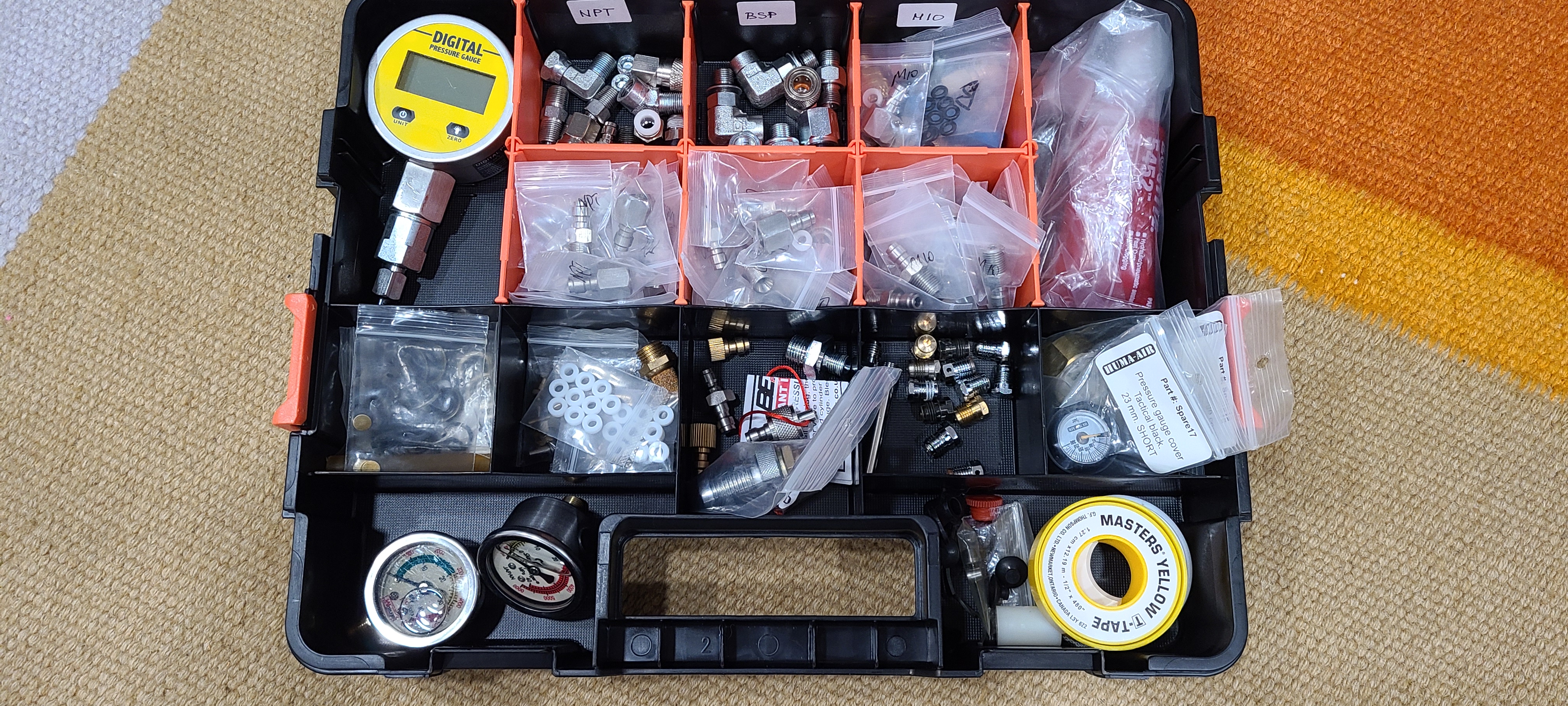

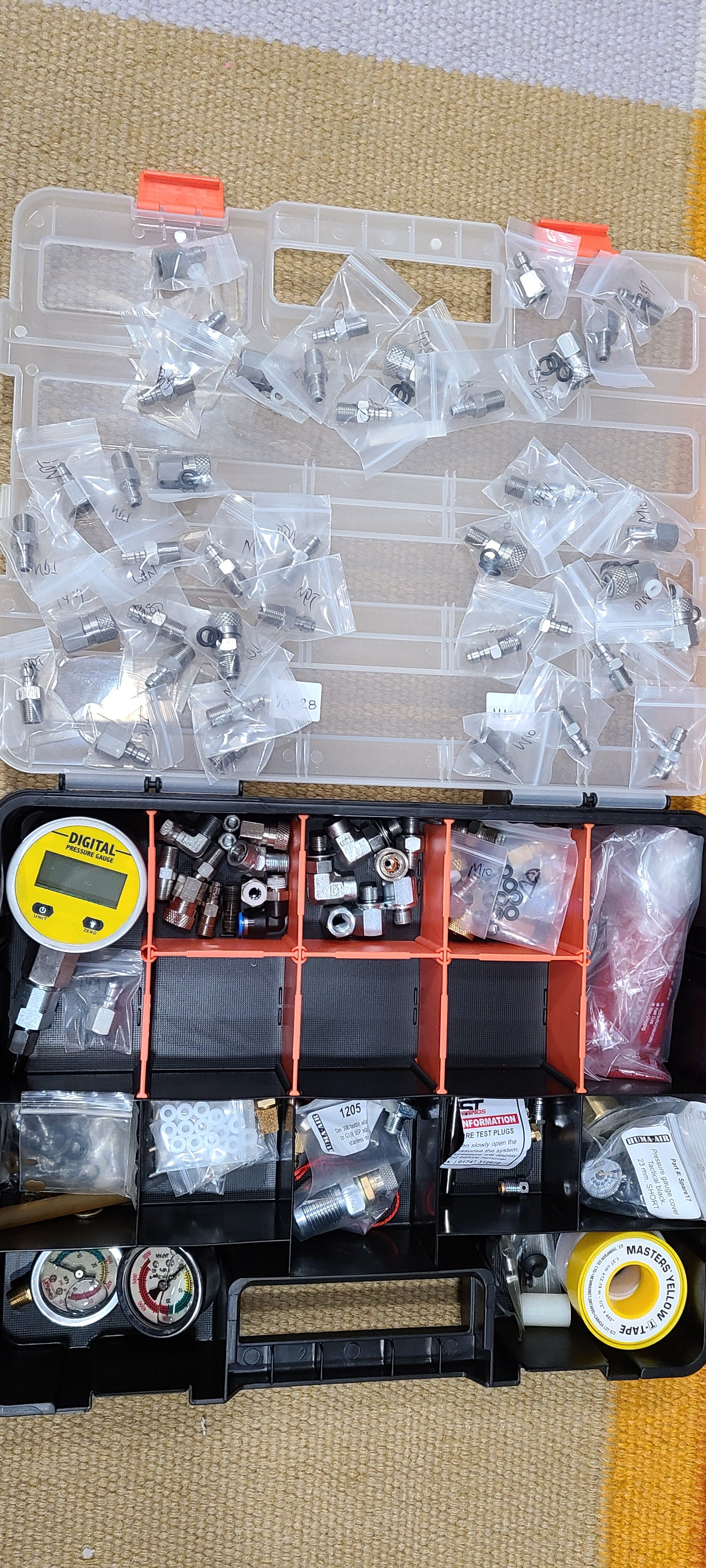

I would like to call to your attention this my story.
In the beginning I was buying all kind of PCP fittings once here once there, and ended up with any kind of mix and match.
And I figure where my troubles actually started.
The dimensional differences also a headache managing orings to seal between foster fittings and quick disconnects.
The main issue starts here, especially when you already got your collection from different sources.
Get your digital caliper and measure for yourself.
When I realized, I started buying all in sets from a single source.
M10 - BSPP - NPT fittings, using same size orings interchangeable in between ....
From my airguns to YH compressor, inline regulator, for all connections everything in one place

@Revoman The fitting(s) are to be used in an external reg. I’d like them to be able to handle 5000-6000 psi in the event that I decide to use N2. I’m undecided on if I’d like the outlet fitting to be male or female.
