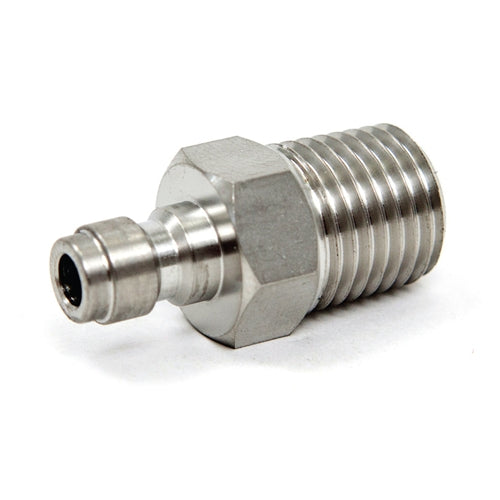

@Ca_Varminter With the reducer bushing? Where’d you get yours? I was looking at one of these
Here is my setup.....
1/4" Npt to 1/8" Npt reducing bushing. 1/8" Npt 90° Elbow. Then 1/8" Npt Male to 1/8" Bspp male adapter

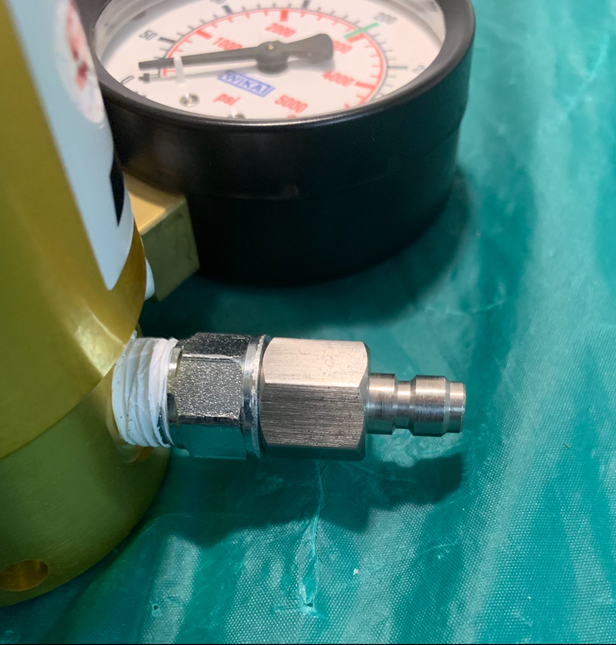

For now I’ve decided to go ¼” NPT to ⅛” BSP reducer connected to ⅛” BSP male foster fill nipple. I’ll likely try another configuration or two coming of of the reg output side. I may do the 90 degree elbow coming off of my teething line. I’ll figure something out for a permanent configuration. Thanks to everyone who contributed helpful information and links to this thread.

I went ¼”NPTM (into reg) - ⅛” BSPM (into foster nipple) to a ⅛” BSPM foster fill nipple with a dowty seal between them. It also came with a Delrin seal insert that I think I can use when the dowty washer fails.
Thanks for all of your suggestions. If the BSP fittings seem too problematic due to the need for a dowty washer I can switch to an NPT reducer and foster fill fitting.
The male foster fill nipple came from Air Tanks Plus and the ¼” NPTM to ⅛” BSPM reducer came from Best Fittings.
