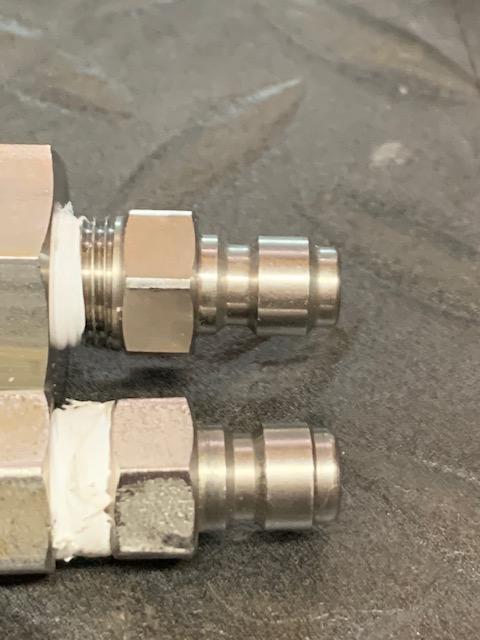

I can say from my own experience... there are 2 basic styles, whether it's on purpose on not, its annoying. For me, it the length of the neck vs the collar on the male fitting. And maybe a corresponding difference in the female fittings. I'm looking for a pic I shared a for months ago, I'll update the post if I can find it.
Found it... top one won't fit anything I own. I buy both male and female fitting 5 at a time and always from the same vendor and I make sure they fit before I do anything else with them.
The Chinese fosters seem to have no rhyme or reason as for the sizes or length of the rings on the male fosters finding a pair that fit together is not as easy as it would seem. I used to think that if I bought them from the same seller that they would fit together NOT. These days I buy nothing but Ninja branded fittings as they always fit together and the quality is there.
I have tossed many that will not fit together with much of anything but kept a few just in case.
Yeah in my case the female fitting wouldn’t fit like it was too small. Luckily the paintball store has no problem but unluckily, the paintball store will be closing today or tomorrow.
I’m going to have to buy some other foster fittings. Not the whole adaptor but the end fitting itself. And I might try some light sanding as was suggested.
Man I didn’t expect any replies to this thread. I thought I was losing my mind.
Thanks y’all
I too went through some frustrating times trying to get all of the different foster fittings to fit....and not leak. What I discovered is that most foster fittings we have here are 1/8 BSPP(British Standard Parallel Pipe), which are straight, not tapered threads. The Chinese typically use M10 fittings, not BSPP. They are almost the exact same size. A male 1/8 BSPP will screw into a female M10, but not the other way around. The QD(foster)ends are the same regardless of the threads.
Not sure if this is what the OP is having problems with...it’s just something that took me a while to figure out.
