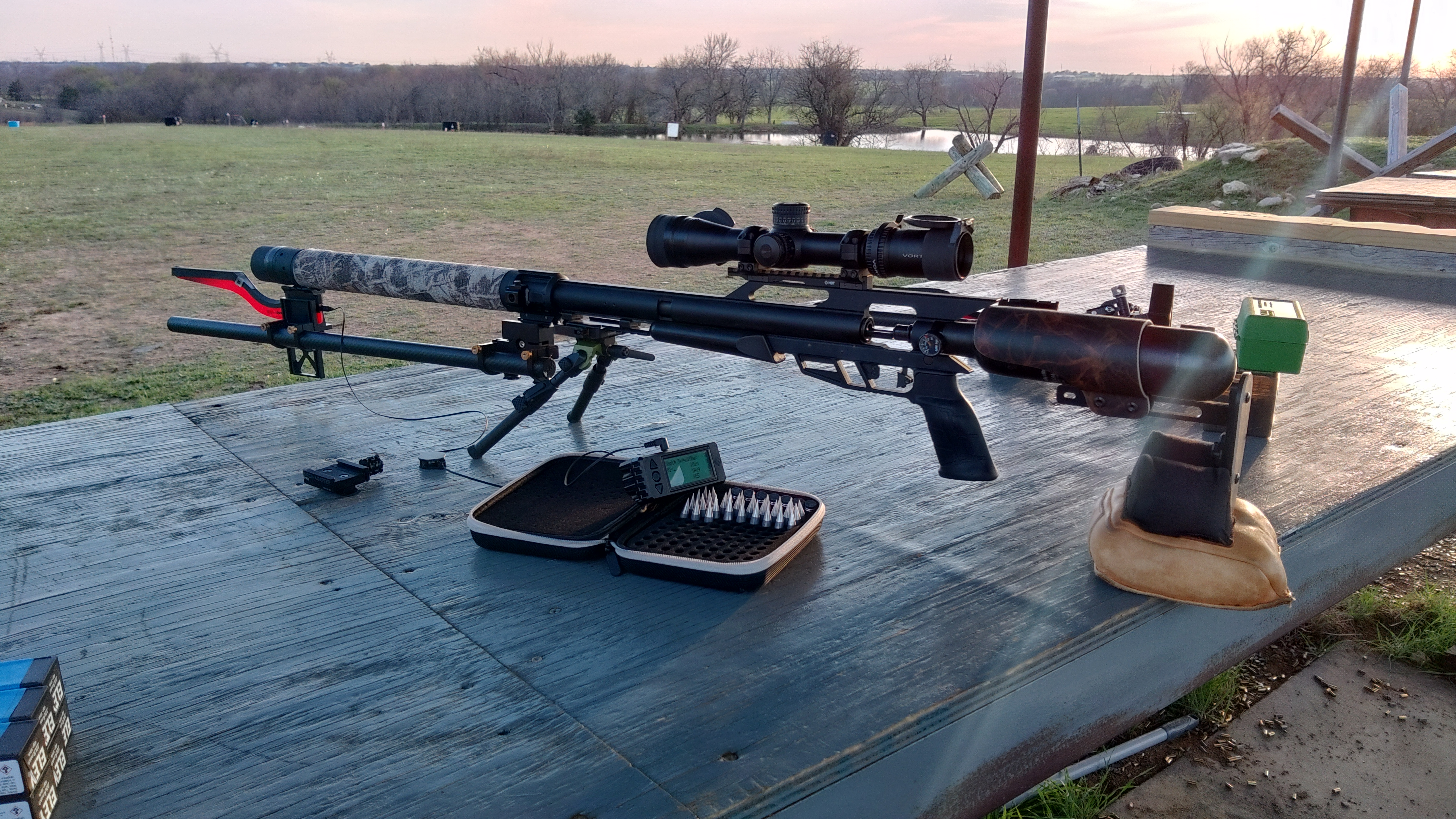

Factory Lother Wather Texan barrels very greatly.. Before I hand lead lapped my .510 Texan barrel..You needed to clean every 3-5 rounds for any kind of accuracy... It was horrible... Know that its smooth and uniform it doesn't really lead anymore after aggressively hand lapping.... So I can go 40-100 rounds and accuracy doesn't suffer... Airgun s need perfect smooth u inform barrels....Rough barrels do t work with soft cast lead...

I feel that I have lap/fired broken the barrel very well as my gun shoots good but I have to shoot a handful of slugs before it starts grouping better again

I use powder coating and lube...After cleaning first shots off.Then it settles down.. Maybe trying going up a l in slug bore size..My barrel is 5.105 after lapping was .510.. So a lil more bore diameter... Your barrel has to lead to tighten up......Maybe🤔
