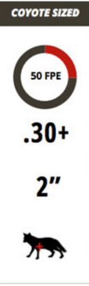

I would not shot a coyote with either of those rifles.
You need more power for a humanly kill.
I have no issue with 50 FPE .25 cal knocking down coyotes @ 25 yards with great shot placement. My 2c though, to each their own!
