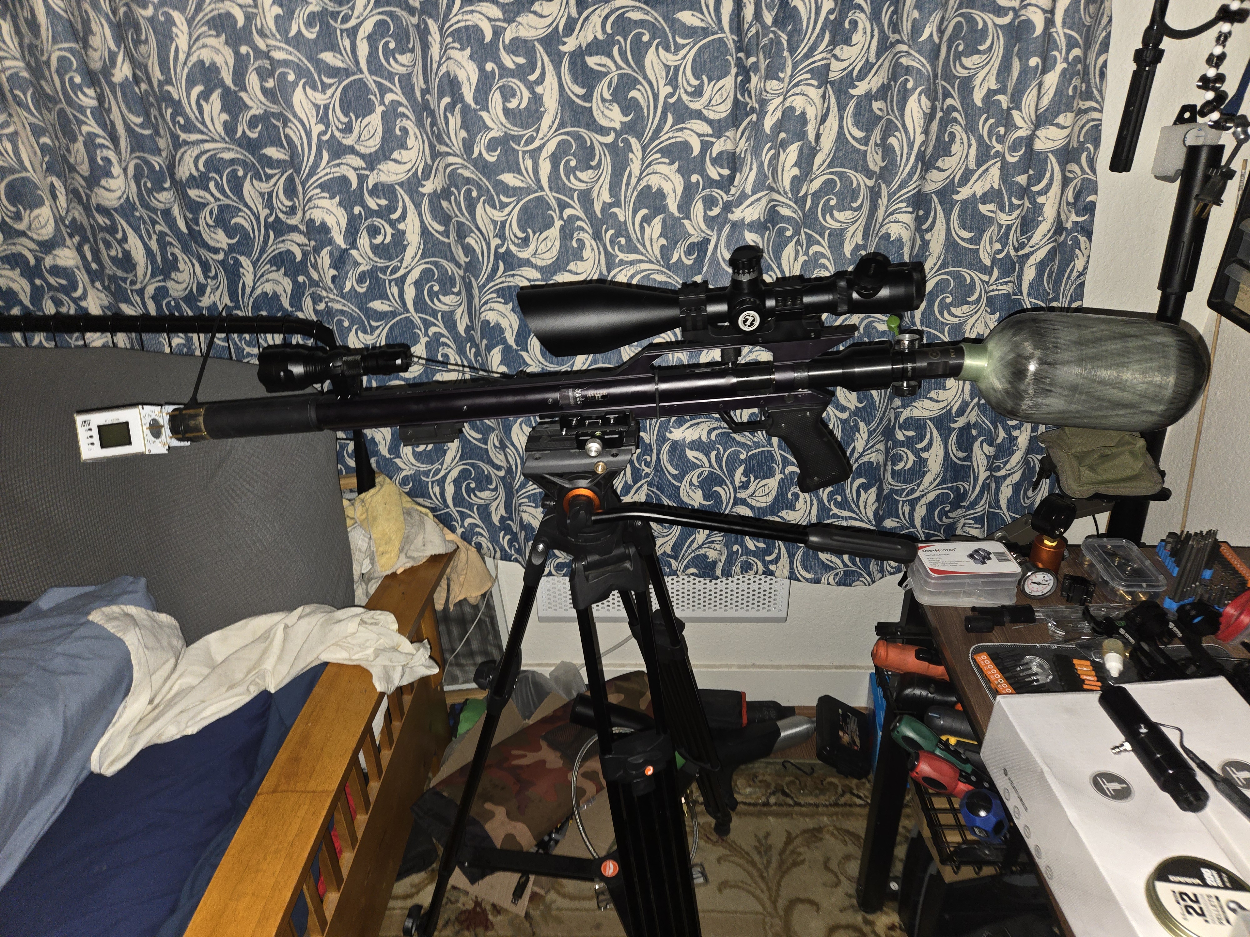

Airforce FrankenTalon on the Chrony
Traded out the 12" barrel for the 19" barrel.
WHOA, put in 14.3gr H&N and POW supersonic report. Put the 21gr H&N in, 1015FPS. Cranked the power wheel down to 2, mid 900. Guess I need to adjust the regulator down from 2500PSI i was using with the 12" barrel.
Although at 2 on the wheel it is a bit easier to cock.
Ordered a 16mm barrel to 1/2-20 Adapter from Trajectron so I can use one of my better moderators. Without the inserts from the 12" the 6 inch moderator that came with the gun is much less effective.

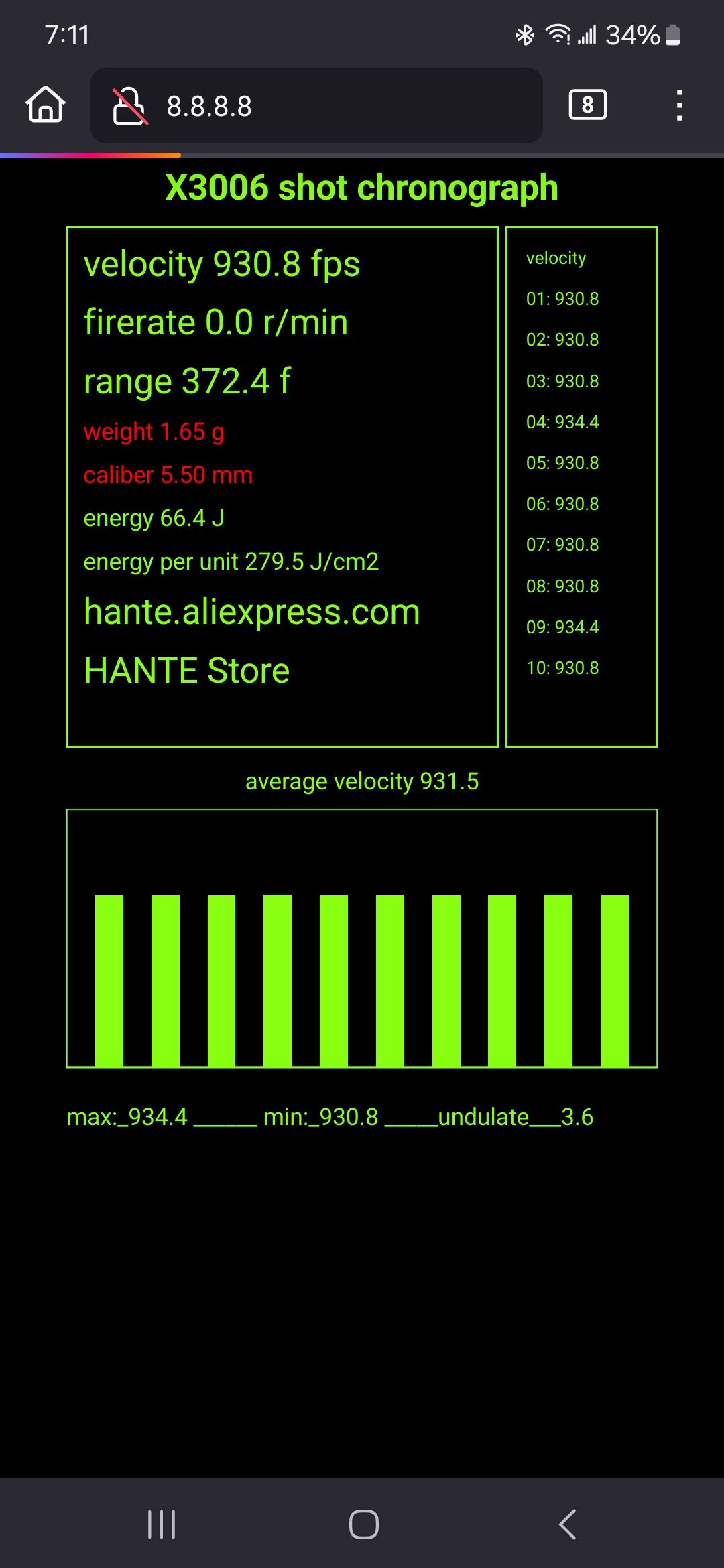

Parts I ordered from Trajectron yesterday will be here Thursday. 5 days from India by DHL for $17
Apolo Monster 25.4gr. A bit tighter group and same consistency

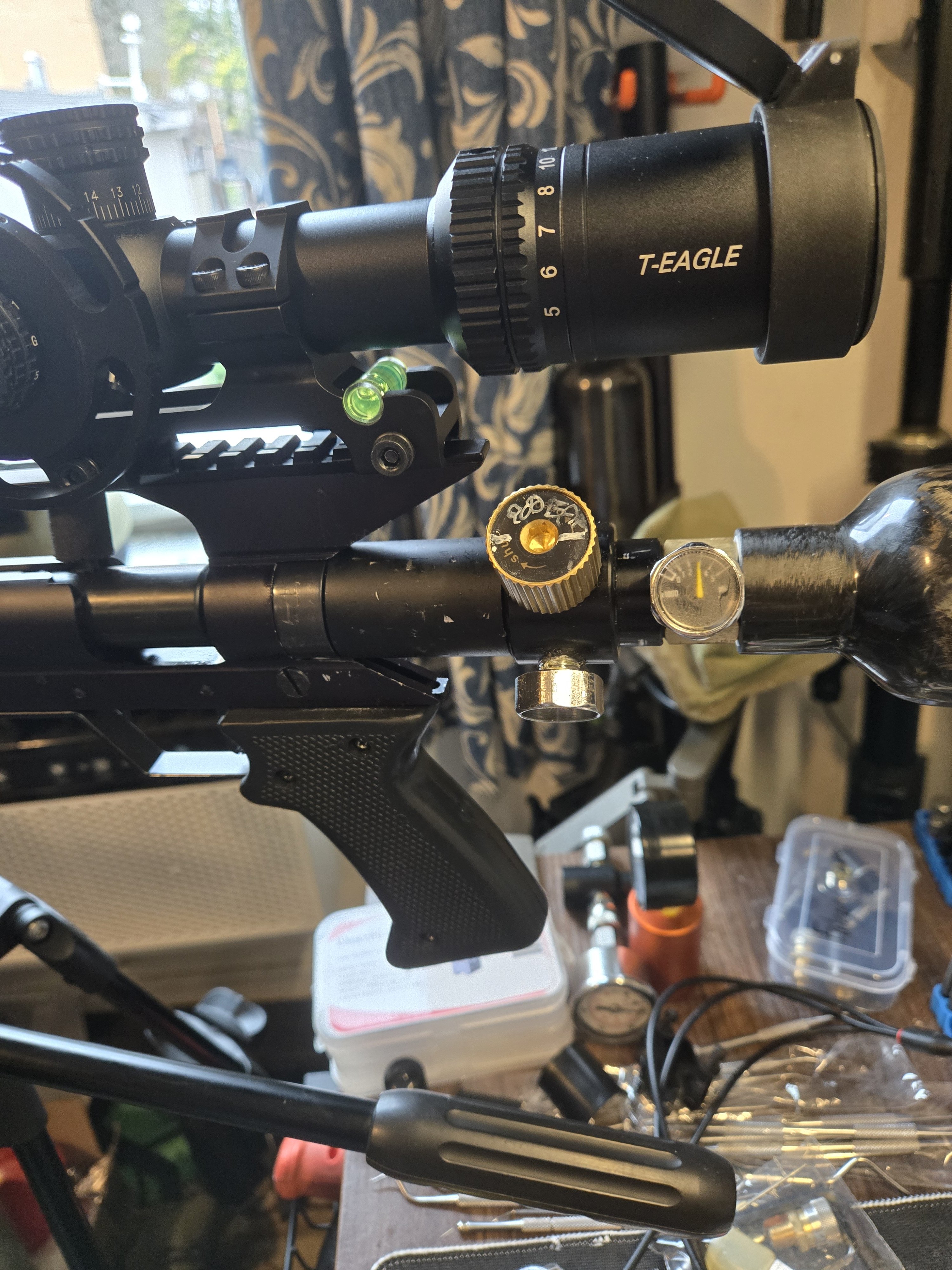

The various tank setups the Huben Power drop block with the shorty 1.1L is winning hands down. The stock unit isn't much. The Huben Power Cricket Max-ATH and Trajectron high flow valve is better than the stock but surprisingly 100FPS behind the drop block. I've got some high flow rebuilds for the Airforce valves and I'll probably try the stock valve first to see if that improves.

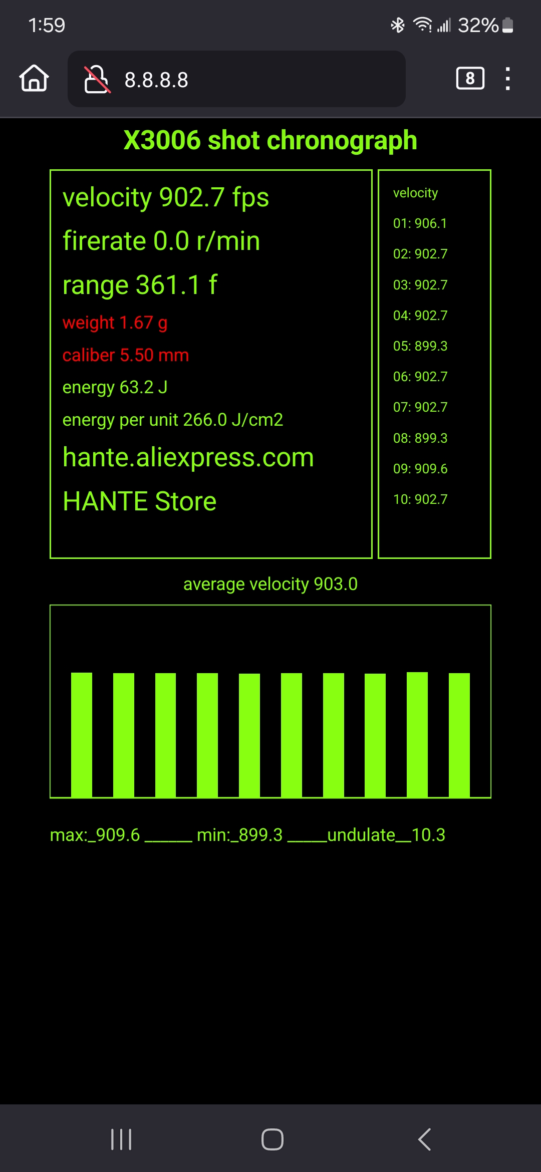

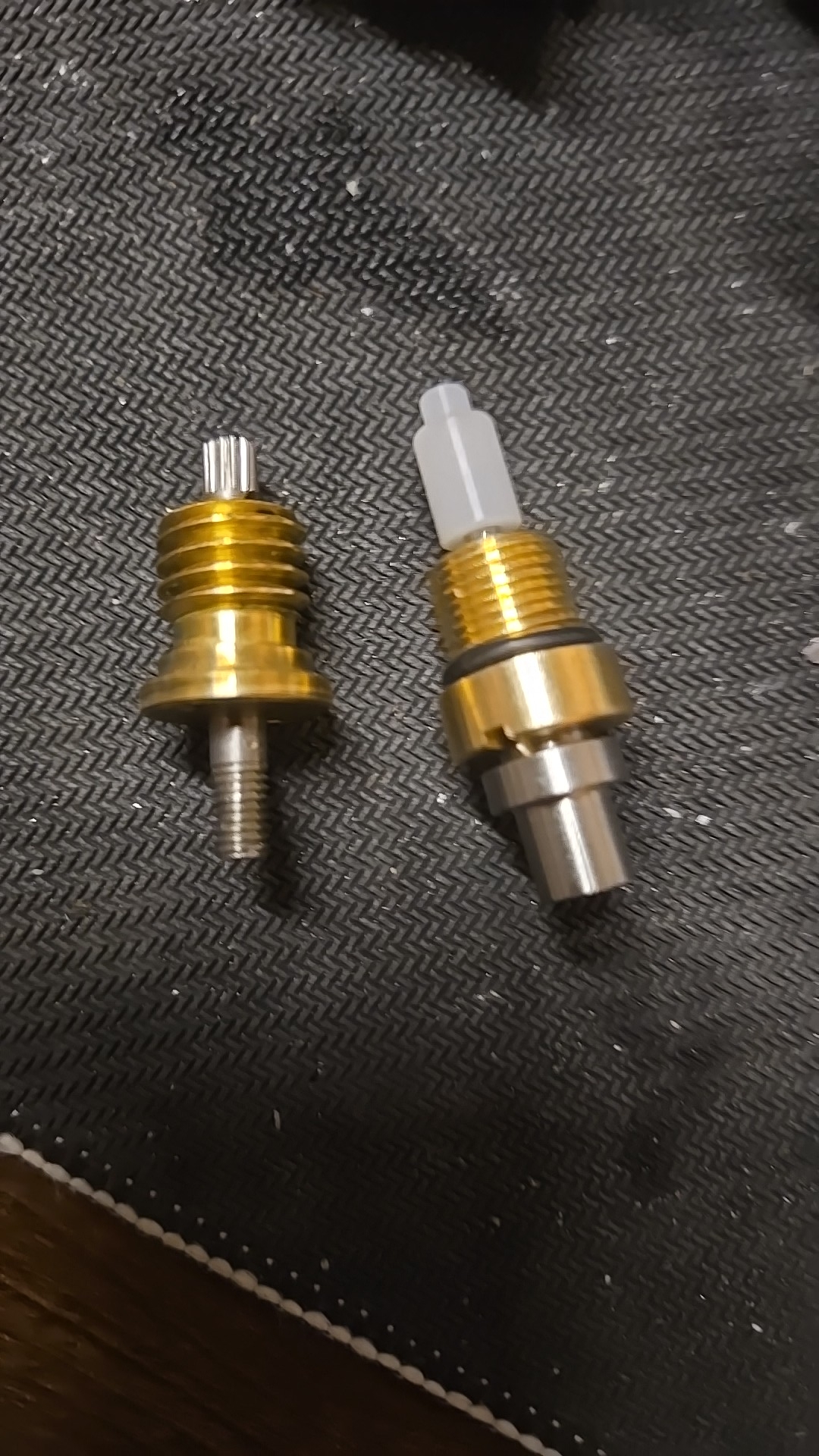

No rebuild of the stock valve or the Trajectron. The rebuild kit use a much finer thread on the body. I try the AliExpress high flow valve when it gets here. See if it can keep up with the Huben Power drop block.
I do like my big volume bottles. Put a lot of pellets down range, 80-100, this afternoon. Dropped the 1.1L from ~4000psi to ~3200psi.

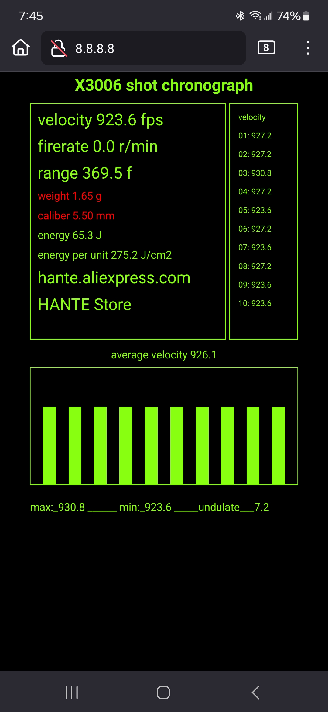

As a test in another thread I cranked the power wheel to 10 and got 960FPS and 70J energy with Apolo Monster 25.4gr.
Which makes me think I can probably get 80j or close by increasing the regulator pressure. Since I have no clue where I'm going with this build it is on the list of additional stupid stuff to try.
