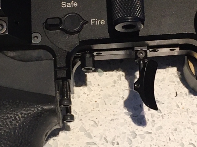

i agree the trigger on the impact is not perfect but you can make it a lot better buy just replacing the ball detent screw with an adjustable one, and the spring for a slightly lighter one, you can then adjust the position of the ball with the nut on the outside and the wait of the second stage with the hex in the centre of the nut, you can get a very light first and second stage and still have a good second stage break (y)
It's been done a few different ways along the same theme by people in the past and this setup is just my take on that idea
Not a very good pic but i think you can see the idea
Thank you for sharing this. I would love to try it, where did you source the parts?
