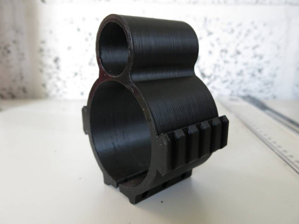

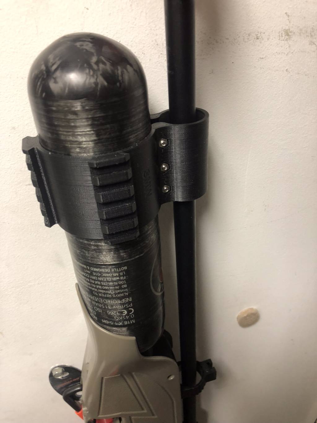

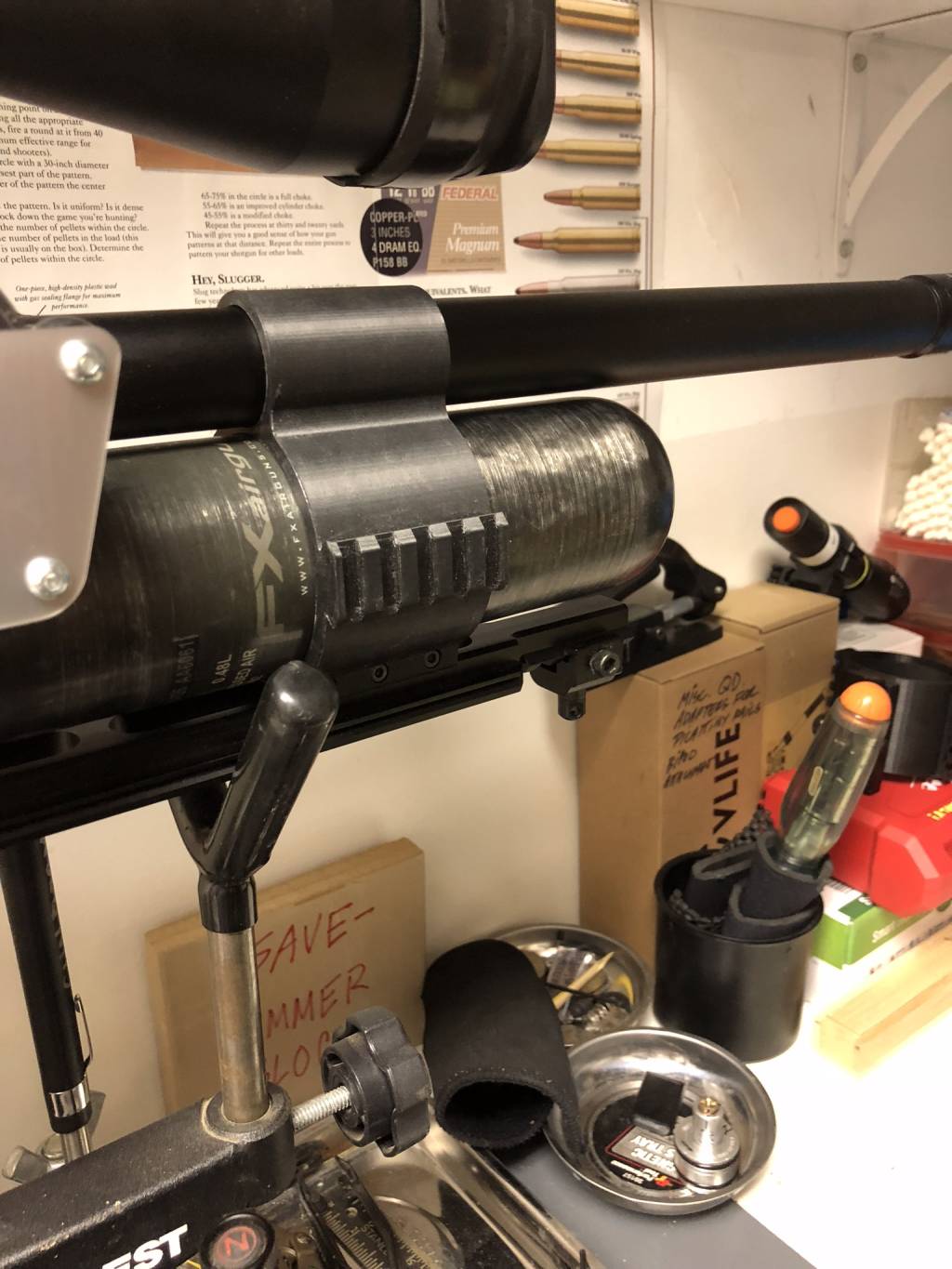

There appears to be a misconception here. A barrel band supports the shroud, not the barrel. The barrel remains supported by the shroud in exactly the same as it came from the factory. The band prevents handling stresses like bumping from affecting the barrel to receiver connection.
