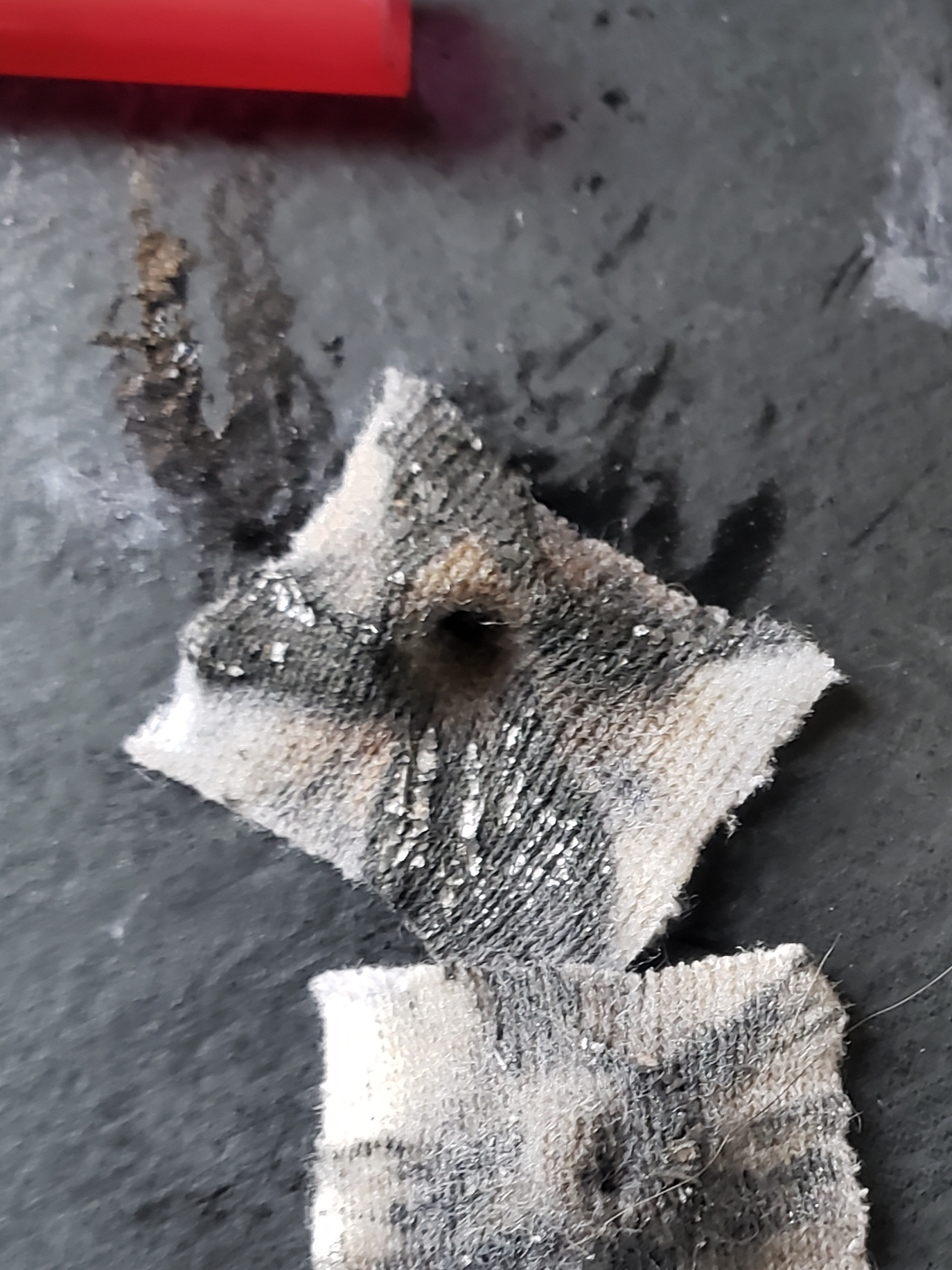

Probably should have cleaned the barrel of my new toy when I first got it (duh). It was shooting well and figured it was clean enough. Welp.
First two dry patches felt like I was pulling the patches through peanut butter. After I pulled those through I peeked down through the barrel and could physically see the buildup starting to seperate from the rifling.
Switched to 2x Hoppes soaked patches and let them soak for a few. You can actually see chunks of lead buildup on the patches.

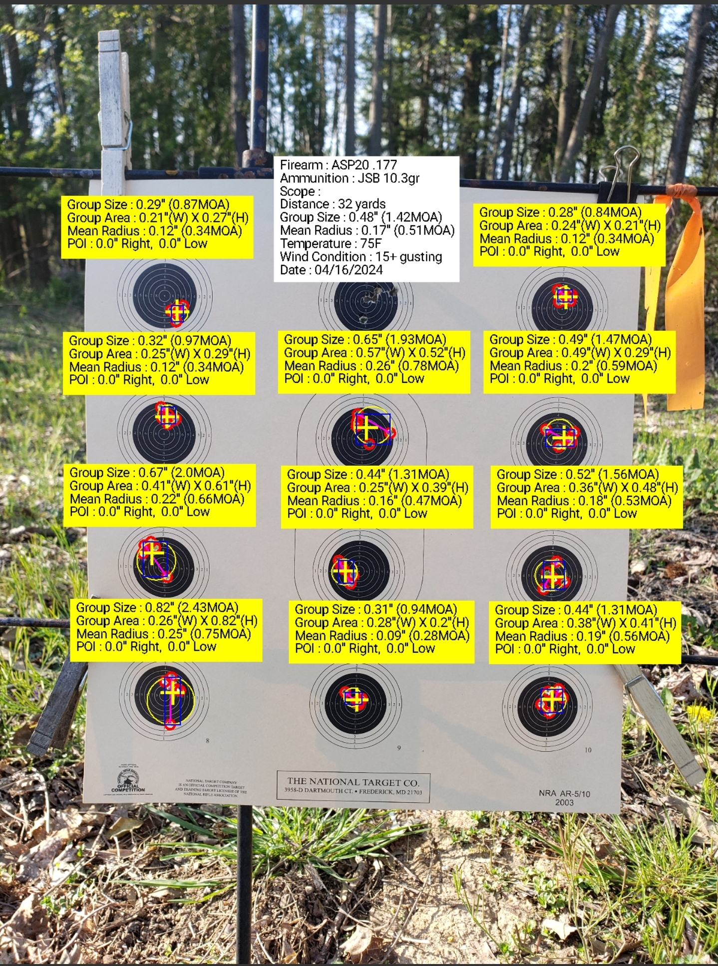

11x 5 shot groups at 32yds after cleaning the barrel. 0.48" or 1.42 MOA average across the board. Happy there already. The kicker is there were two head scratcher fliers. Im not sure what happened on target #6 but #8 the gun jumped weird. Removing just those from the mix brought that average down to 0.39" / 1.15 MOA over 53 shots with unsorted pellets.
