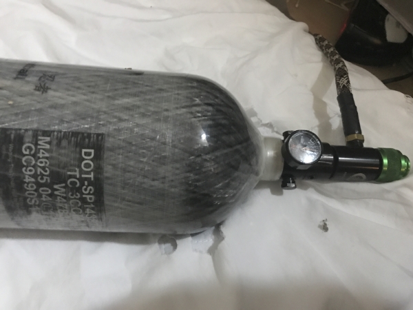

Hey guys. I got this airsoft tank online. Its a non slp tank whatever that means. I think its regulated to put out 400 psi. Does anyone know how i can make it useable for airguns?
Just buy a Jubilee paintball valve from air hog. I think they are around $135. Joe B sells a slo flo valve that will fit it too. Just make sure the threads are 5/8".
There is also a valve that's regulated for 2900 psi output. It will work on guns that have a 200 bar fill requirement. The Jubilee will allow you to fill guns with a higher fill.
Alternately it might be possible to "rebuild or have rebuilt" the existing regulator to output 3K psi. That way you can use it to tether at the bench. The jubilee and joe b valves mentioned above will just give you another 4500 psi tank.
