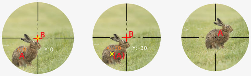

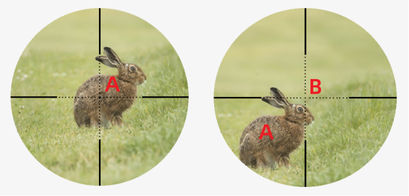

Figure 1 shows the optical reticle center(A) before installing the front clip-on device (FT, FD, Predator), while Figure 2 depicts the optical reticle center(B) after installation.
Fig. 1 Fig. 2

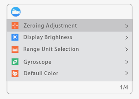

2、Open the menu and select the Zero Adjustment.
Fig. 3

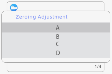

3、There are five data sets(A-E) available for saving. By pressing/toggling the ↑ and↓ buttons to select a set, press OK key to enter it.
Fig. 4

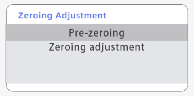

4、Press the OK key to enter the Pre-zeroing option.
Fig. 5
5、Move the X/Y axis by pressing/toggling the↑ and↓ button to align the red reticle (German version: Red dot) with the Point B, press the OK key to switch the X/Y coordinates, then press/toggle the menu button to save and return.
Fig. 6

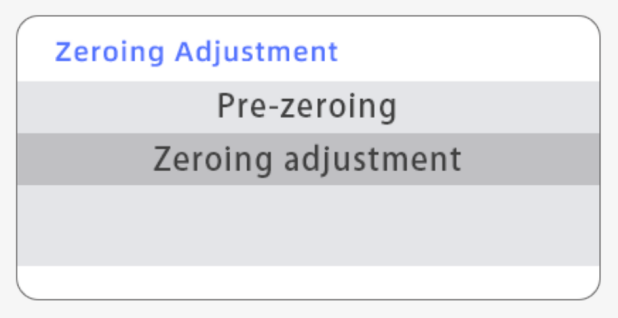

6、Then enter the Zeroing adjustment option.
Fig. 7
7、Adjust the value of X/Y to move the yellow cross to the position where the point A is before installing the device, then press/toggle the menu button to return and save.
Fig. 8
